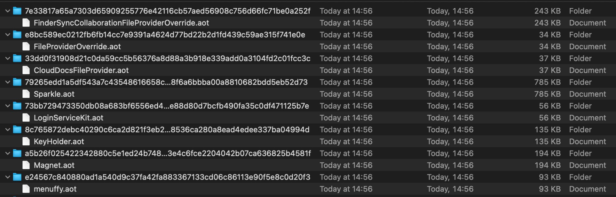

Interesting!! Using Find Any File, search for any file with ".aot" in its name. You'll find tons of hidden files inside the private/var/bd/oah directory, even from apps that are supposed to be "universal" (not all of them, though). I found lots of files from apps and old screensavers I deleted some times ago.
So if I really wanted to erase my "pesky" menuffy files, then I should also do the same for all the other files from erased apps (and even old screensavers that I trashed). I'm wondering if I empty the full directories inside the oah folder would cause any issue at all, since (I think) Rosetta2 would recreate the needed files, if I trash everything.
And it's a pity that the Finder says that the oah directory is empty (it says 0 bytes in there!), while in fact it isn't empty at all, according to the search in FAF.

Folders & files created after starting menuffy
With SIP disabled, they can be deleted from Finder or Terminal

I have a total of 656 .aot files, for about 1GB (more or less) in total. Strangely, all of them were created during the last two weeks, while Rosetta2 is in use since almost 2 months now.
EDIT: Here's a page that shows how badly Rosetta could trash your SSD with garbage, as time passes...
