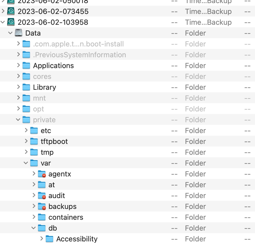

Now that I can see the directories in Time Machine, I can do a Finder "Get Info" on the oah folder. It reports that the oah folder is consuming 2.7 GB on disk. Over time, as I try various programs, it will grow. I'm going to keep an eye on it and see if it gets much worse.
I suspect all of "aot" stuff in there can be deleted. I think "aot" means "ahead of time" compilation. Maybe when an Intel app is launched, the OS inspects it and compiles the various libraries used into versions which bridge to the ARM APIs, but only if missing from the oah cache.

I definitely said it badly. I do the get info on the directory within the TimeMachine backup drive. I just navigate to the last backup entry and work in there. If I use get info on that directory on the main drive I also get zero bytes.

Yes, the system is designed (apparently) to report 0 byte in the oah directory, for the admin user, but it isn't true when you have full access to it. It's full of .aot files in there. After deactivating SIP, we can go in there and see everything. My own "0 byte" then translated to a 819MB of files! As I said in my previous message, I trashed all these .aot files, and everything is fine.
