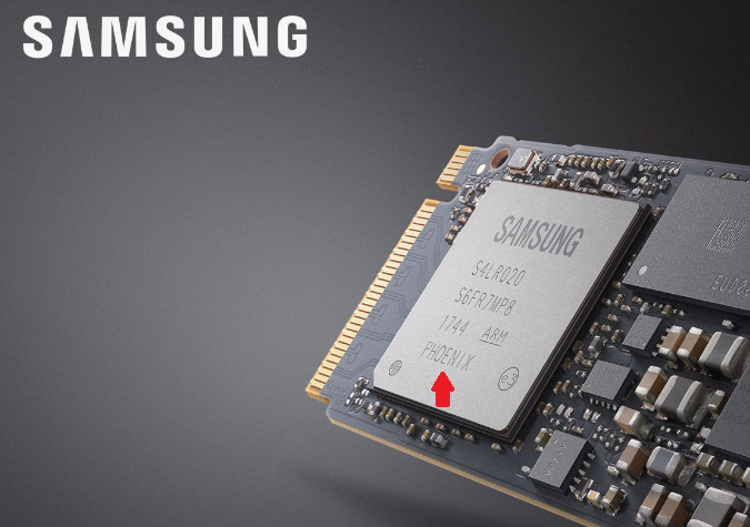

Due to the world-wide chip shortage, Samsung has switched from using the Phoenix controller to an Elpis controller.
Under most light usage workloads, users never really notice the lower performance, but it is a massive performance hit after the onboard write cache is saturated. The public was not informed of this so there are 2 versions of the 970 Evo Plus available to consumers. The only way to know is to look at the controller chip itself:
Other companies making changes similar to this because of the chip shortage debacle include: Western Digital and Crucial. They however chose to keep their controller chips the same, and instead dropped TLC NANDs in favour of the cheaper QLC NANDs which have lower endurance life. Thankfully, Samsung decided to keep TLC in their NANDs, even with the inferior controllers.
Phoenix SSDs: MZVLB1T0HBLR
Elpis SSDs: MZVL21T0HBLU
I've noticed differences already is some of you reporting speeds here, with the exact same product. This could be part of the explanation.

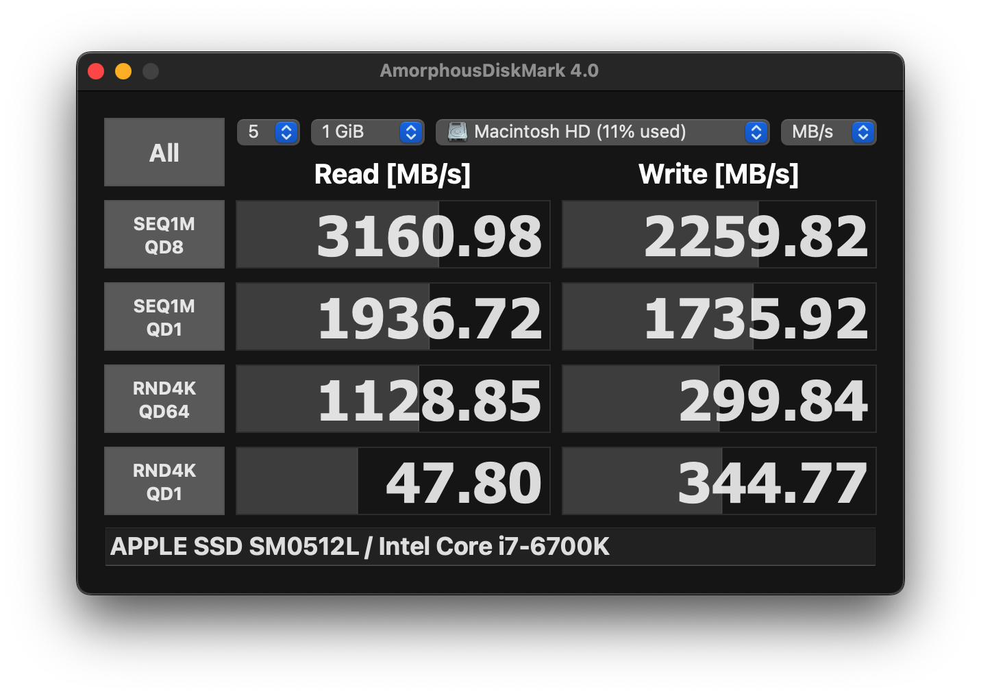

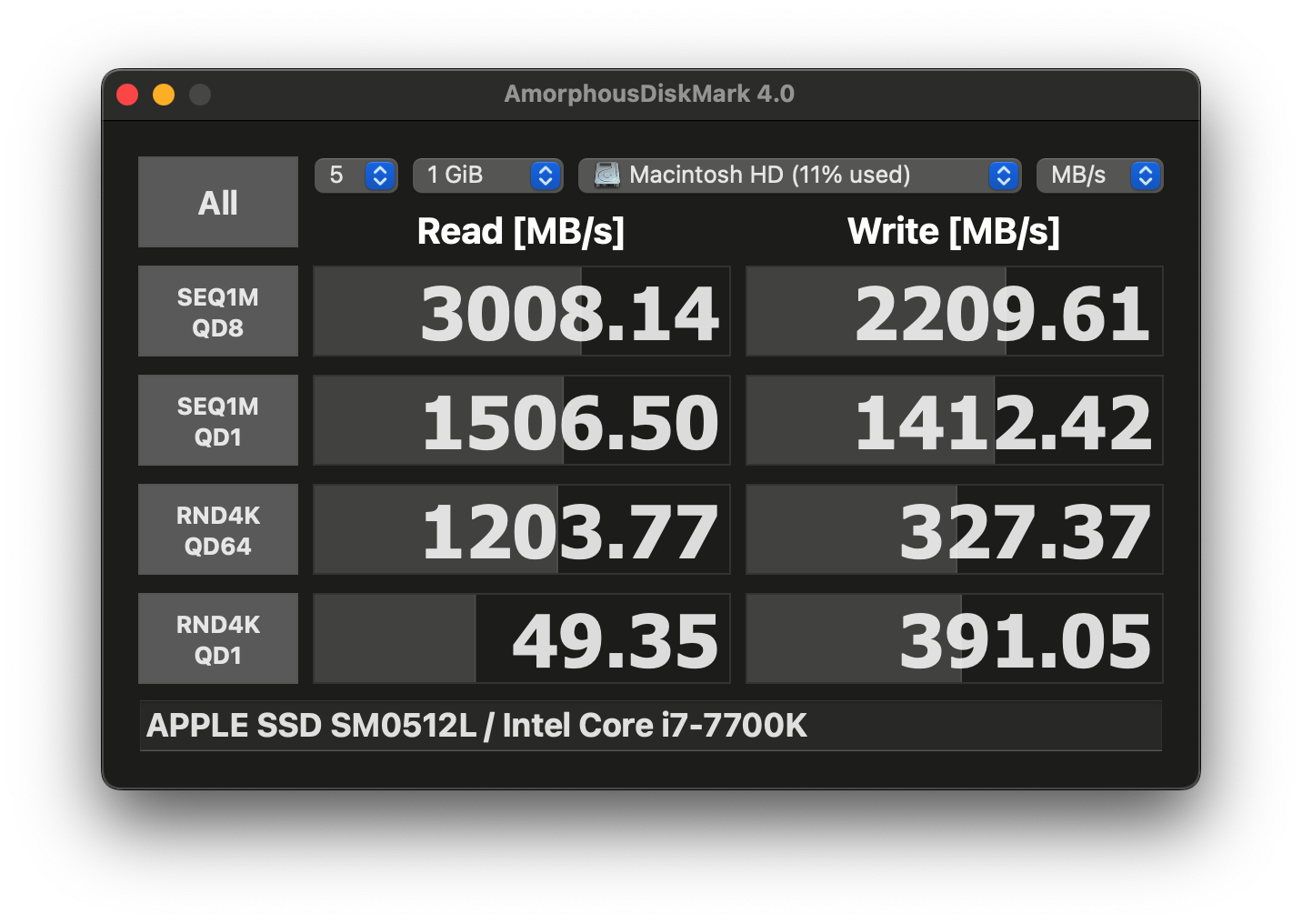

This blade came from a 2019 iMac. Looks like it is a bit faster than the one in my stock mid 2017 model.
2017:
So be warned! DONT buy a SAMSUNG for your blade upgrade :)

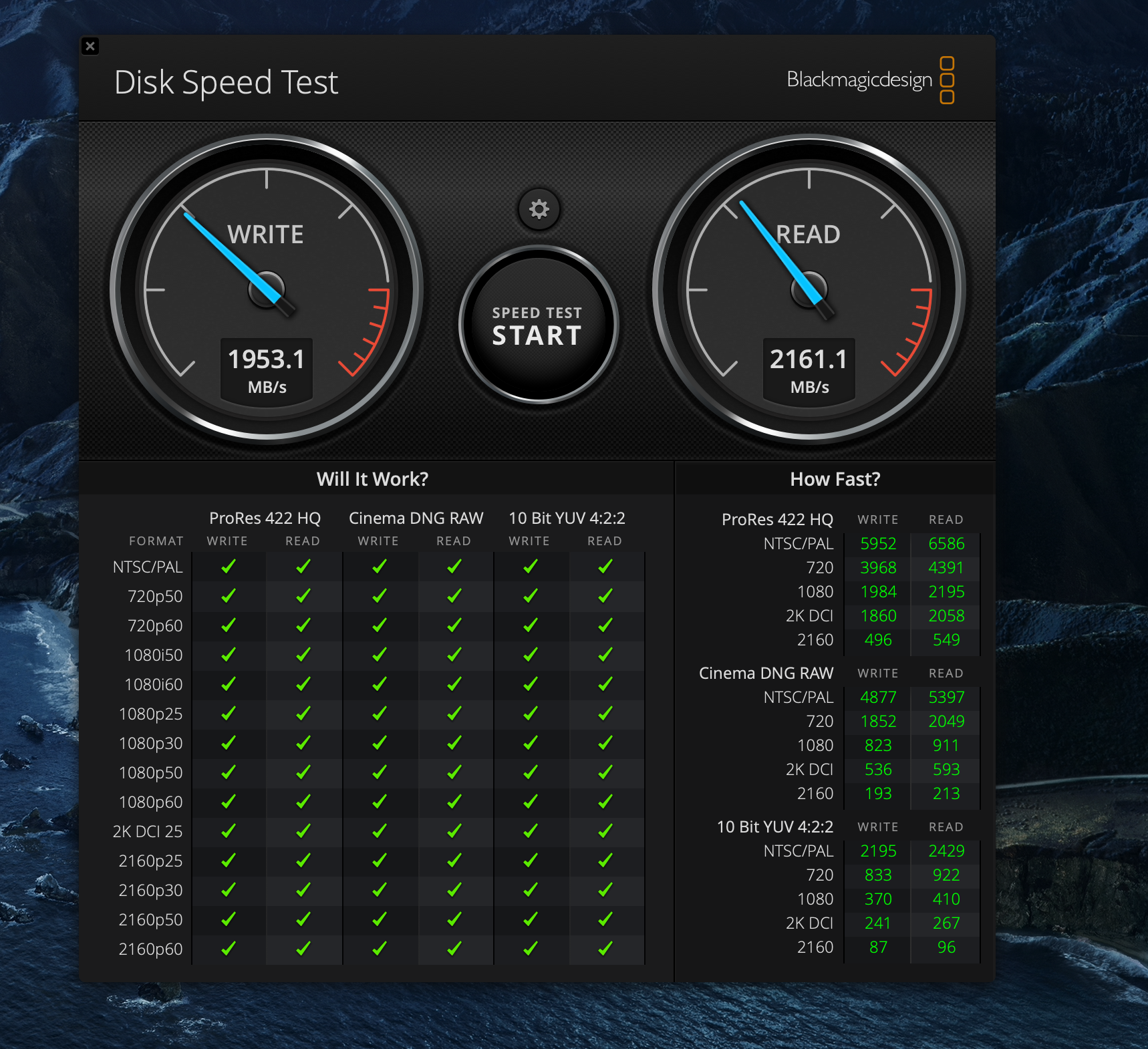

Device: 2019 iMac 19.1 , 27" 5K i5 3.0 , 1 TB Fusion Drive
Blade upgrade: 32gb fusion ssd > 1 TB WD550
HDD upgrade: 1 TB > 4 TB Samsung 870 QVO
Speed test: SSD see below
OS: Big Sur 11.6.5
Temperature sensor: none
Location: NJ, USA
Adapter: Long Sintech
SSD Heatsink: N/A
Issues after fresh OS install: None ... Started on Catalina , no problems moving to Big Sur + updates
This was done early last September and has been running well since . Getting rid of the Fusion drive and adding memory transformed the machine . No particular problems with the install . The QVO was mounted in a Newer Tech AdaptaDrive ; simply to mount the drive via the existing mount points for the factory 3.5" drive . I didn't want to velcro , or double sided tape the QVO to the back of the case and have the thing come loose a year or so down the road. Memory was raised to 32 GB.,also .

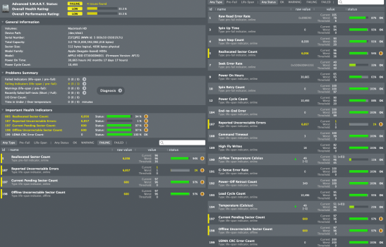

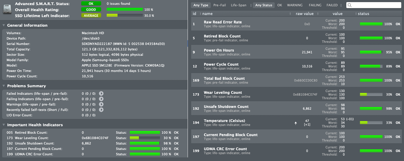

Hi everyone! Please, can you help me with my updates for my iMac 27 Late 2012
Device: Late 2012 27inch iMac13,2 - (3.4Ghz i7, 1TB Fusion, 16GB RAM)
GPU: NVIDIA GeForce GTX 680MX 2GB
HDD: APPLE HDD ST3000DM001 (3 TB)
BLADE: APPLE SSD SM128E (121.33 GB)
AirPort Card: Broadcom BCM43xx 1.0
OS: Catalina 10.15.7
My problems started two years ago. Some noize and clicks from inside, slow speed, hangs, etc... As I understood, this is a problem with HDD memory or blade SDD.
I want to use a 4TB SSD because I used to work with many video files, and I need space and high speed.
I'd like to have Western Digital 4TB WD Blue 3D NAND Internal PC SSD - SATA III 6 Gb/s, 2.5"/7mm, Up to 560 MB/s. But my knowledge about hard drives is described in this topic is not enough to understand what I need and what configurations.
Please, can you help me find out what I should change? For example, should I change only the BLADE memory or BLADE with HDD memory according to my requests for a WD 4TB SSD? And what types of adapter I have to buy? Also, I can't understand why people are changing AirPort Card? Any advice for me to improve hardware here and for what reason?
I appreciate any help. Thanks

If I was you, I would pick a decent 4TB SATA drive and use that for everything. The blade in the 2012 is also SATA so doesn't offer any speed benefits over a normal (2.5") SATA drive. The 128GB blade has likely had a lot of use over the years so would be best placed to serve as a small scratch disk or even a good place to run a Windows 10 boot camp install, if that's your thing.
Tip: DriveDX will give you a clear picture of the condition of both the blade and your spinning drive.

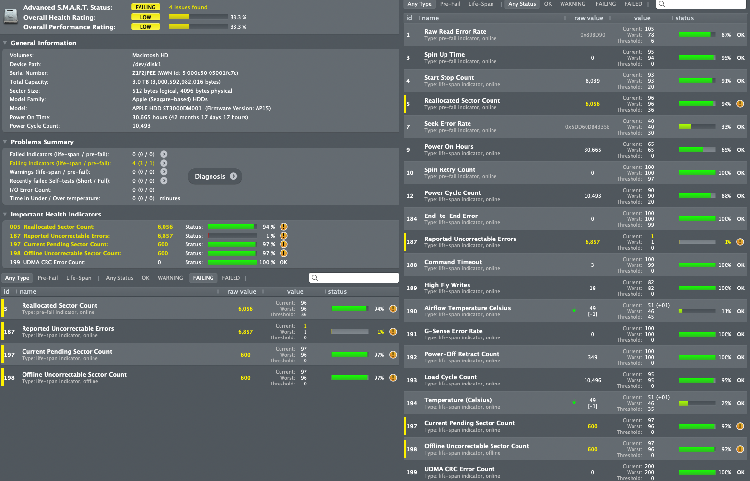

Thank you so much for your help. Now I'm convenient with what I need.
So, I'm going to buy
Here are my screenshots about my HDD and BLADE using DriveDX. And
I'll leave my blade SSD for running a Windows 10 boot camp.
Blessing to everyone!

It feels so good to boot again within 30 seconds :)
Cheers.
As expected, your hard drive is not usable anymore for a system - the many uncorrectable error likely cause your problems.
