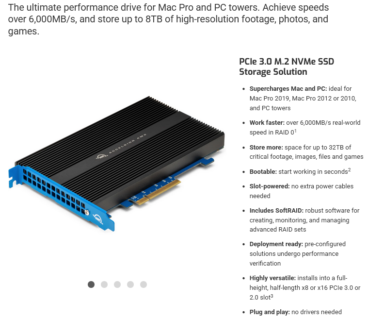

Why so important to boot from a USB device.
I thought you wanted to upgrade from Monterey?
I boot from a Nvme. Nothing is going to boot faster than that. Not even an SSD in sled slot 1, which is what the mac Pro reads first.
I would rock and roll with the OWC accelsior, or with a Syba I/O Crest SI-PEX40129 Dual M.2 NVMe
Want top speed, here you go.
