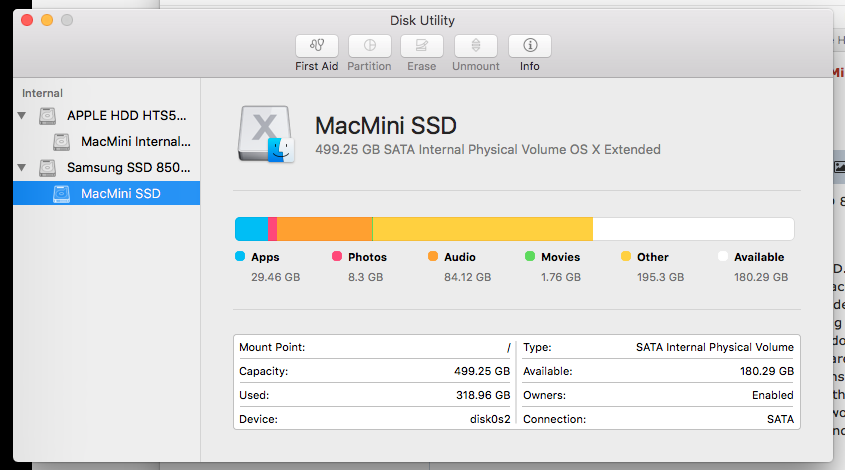

Here is my experience adding a second drive (Samsung SSD 850 EVO 500GB) to my Mac Mini Late 2012.
I would say two things:
  1. DON'T DO IT UNLESS YOU ARE VERY EXPERIENCED. I have changed out several components such as RAM, HDDs, etc., over the years in various older MacBooks/Powerbooks and desktops but this is CHALLENGING. I followed OWCs video which is quite detailed but, unknowingly, I broke off two boots/connectors from the logic board while trying to disconnect the IR connection and the fan. It is really easy to do this without realizing what you've done. It was when reassembling the unit that I realized I actually had pried the boots right off the board. (Luckily for me, I have a friend who works on circuit boards for a living who was able to insert pins in to the logic board and solder the fan wires directly in. Could not do that for the IR connector but that was not critical).
  2. DO IT. Pay someone else to do it but get it done! It's worth the extra $$ to have someone do it. My machine is screaming FAST after the upgrade. Night and day difference! My user login times have gone from 2 minutes to literally seconds. All apps launch in seconds. It's fantastic. :cool:
Notes:
  • I ordered the installation parts right off eBay for $8.39. Search for "Dual Hard Drive SSD Flex Cable for Mac Mini A1347" - doesn't matter if it says "server."
  • I kept the original HDD in the lower bay (upper, if you have the unit upside down while working on it).
  • Once the SSD was installed, I booted up in restore mode, formatted the SSD, ran first aid on it, and then used Disk Utility to "restore" the old drive on to the new SSD. "Restore" is a menu item in Disk Utility. It cloned the drive with no issues. Of course, you then have to rename the new drive and select it as the startup disk. (I had to use disk utility again to figure out which drive was the new SSD as it completely cloned the original drive, including name and icon).
  • Once booted up, I enabled TRIM. To run trimforce, open a Terminal window and type the following command: sudo trimforce enable -- this will result in some warnings but after you accept it will perform the command and reboot the machine.
End result? The machine is running just great with no problems. I just did all this last night but if there is an issue that comes up, I will update my comments here.
