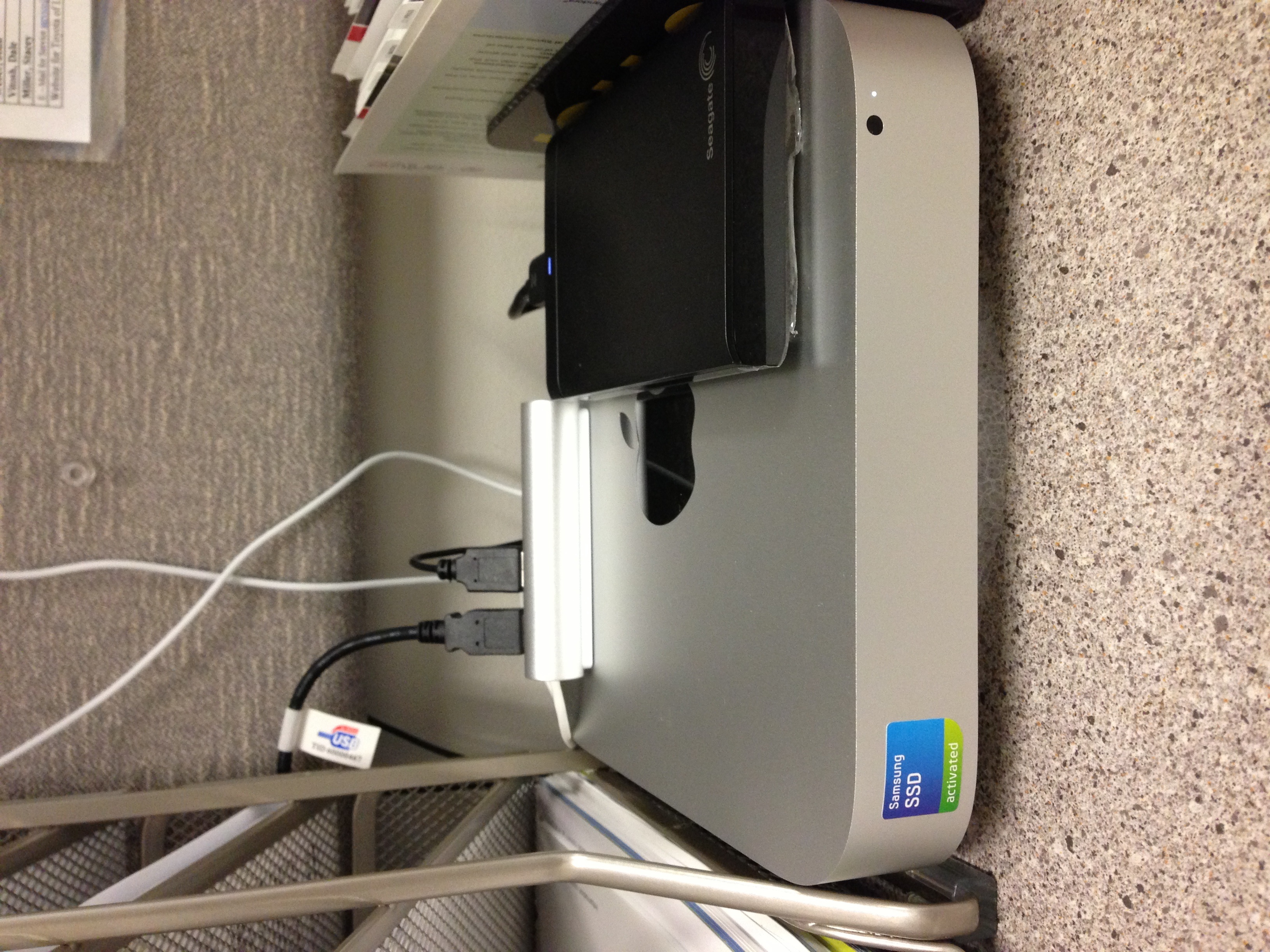

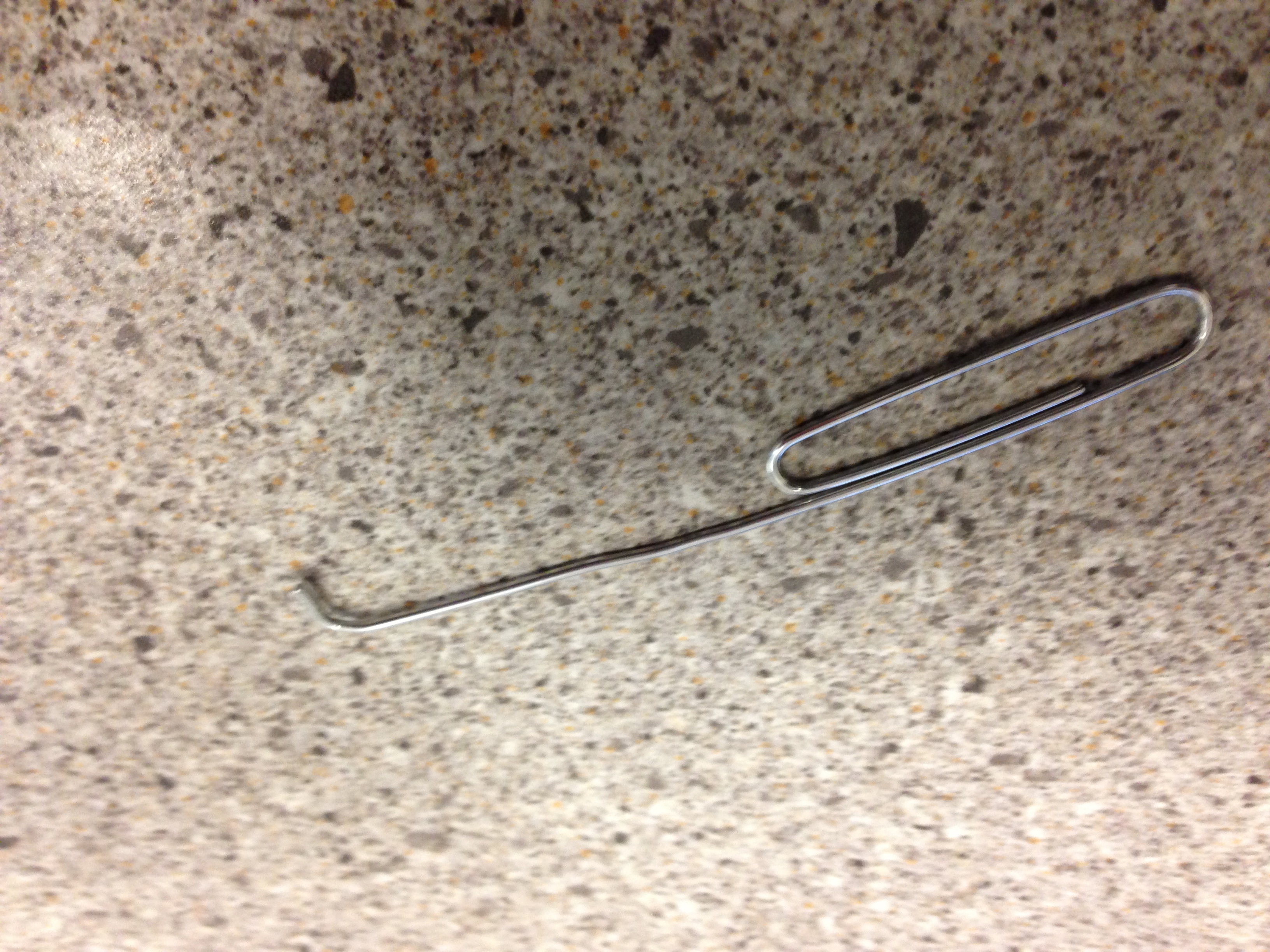

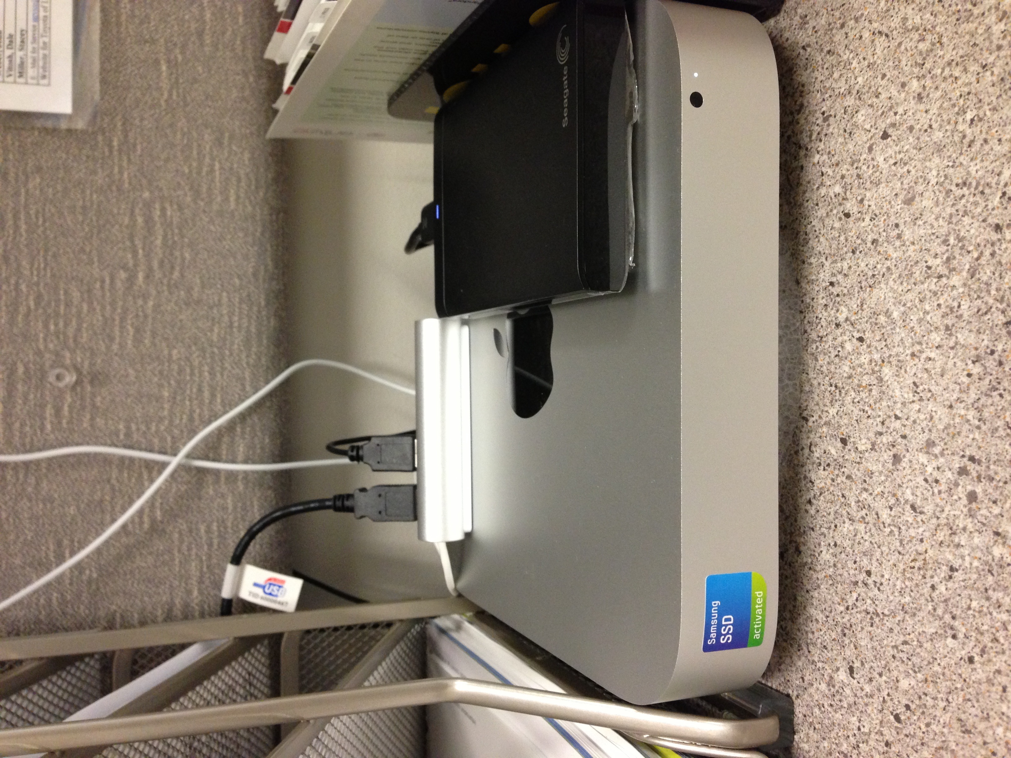

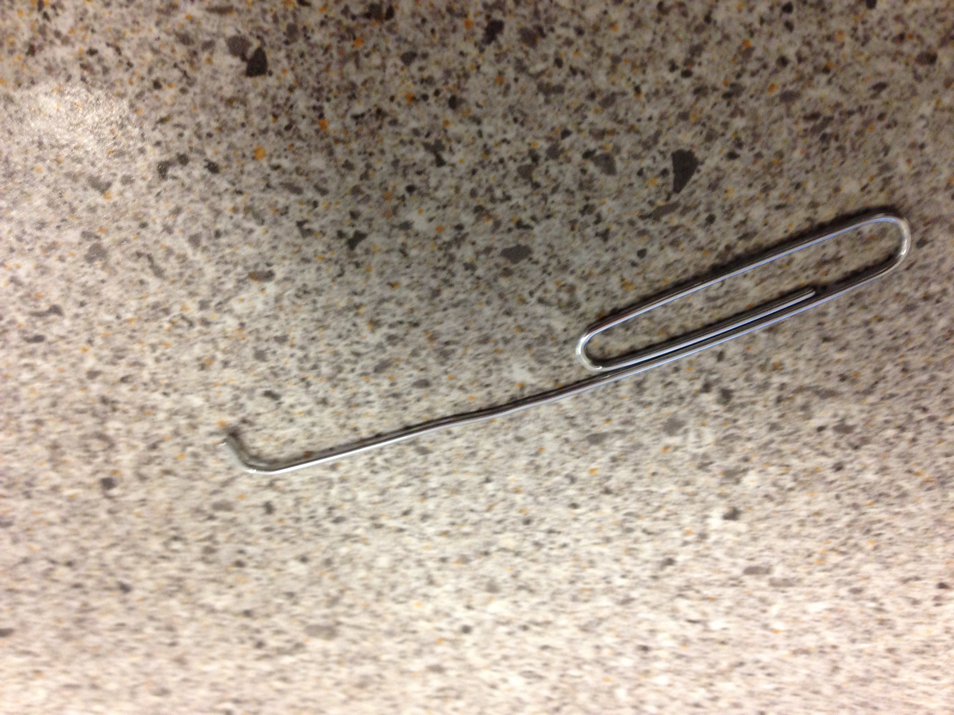

Same problem here. Everything went great except the antenna grate. I spent more time trying to get it back in place then it took to do the complete dissasembly reassembly. The key is not to force it. The top edges of the grate have to fit in the grooved edge of the housing. I used a paper clip and bent one end into a small hook which helped to align it up. I'm not sure what I did but it finally popped into place and the screws magically aligned. Elation!

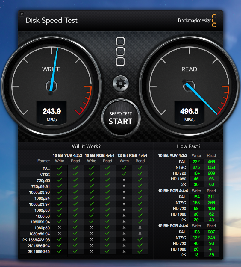

Samsung 840 250GB SSD running in Fusion.
One down and one more to go.

So, you didn't make it into a fusion drive? I'm curious why you didn't.
I didn't fusion my sammy 840p ssd either. With fusion if either disk fails (more likely to be the hdd) I would need to open the mini up, or in the least break the fusion, reinstall the os. As separate drives, if the hdd fails, i will just leave it in the mini, add a thunderbolt ext drive and restore from TM backups. I sym linked my media folders to the hdd to get hdd capacity and ssd speed for everything else.
Personally, I think the odds of this is so low that it shouldn't be a consideration given the dramatic performance increase. But if it works for you, that's great.
