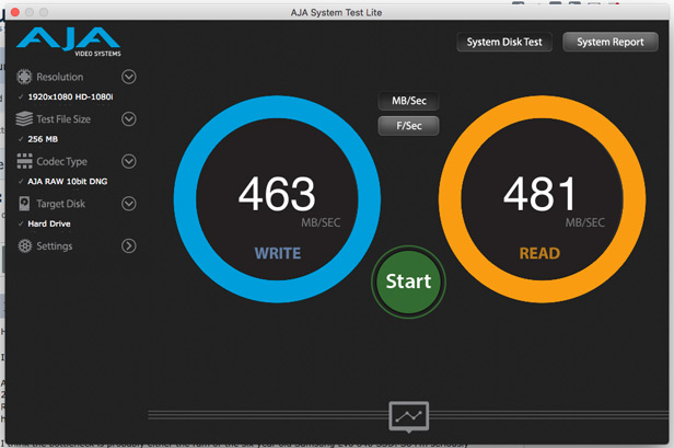

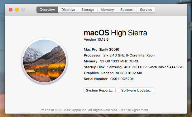

I'd like some advice on upgrading my 2009 classic 4,1 Mac Pro please (firmware updated to v5,1).
As you can see from system profile report, I have already upgraded processors, ram and hard drive to Samsung 840 EVO 1TB 2.5-inch Basic SATA Solid State Drive connected via PCIe. I also just upgraded the graphics card to an AMD Radeon RX580 Sapphire Pulse with full Mac EFI support. These cards are now sold refurbished by https://www.macstoreuk.com/product/amd-radeon-rx580-8gb-with-mac-efi/ and allow Mac Boot screen.
I think the bottleneck is the six year old Samsung Evo 840 SSD. So i'm seriously considering upgrading the Samsung 840 Evo hard drive as it only reads / writes at under 500Mb/s.
Is it easy to fit a 1Tb Samsung 970 NVMe SSD (1,500Mb/s) that will also be bootable or am i better with a standard and newer 2.5" SSD?
Any advantages upgrading ram to 64Gb too - I'm mainly using Photoshop and FCPX to edit 8k video.
Any advice on this would be much appreciated ...
