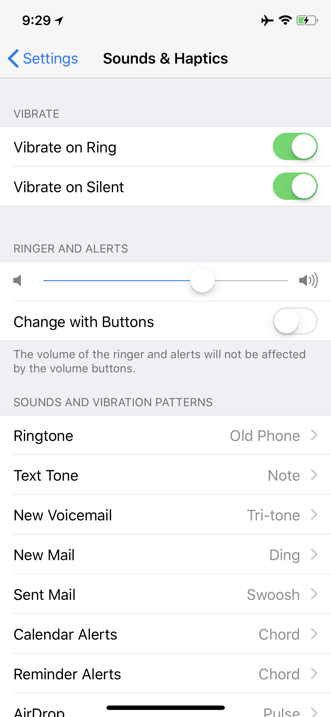

I just solved this after talking with Apple Support for a while.
Apparently there is a setting I have never seen before in Sounds & Haptics that toggles whether alerts and ring volume are controlled by volume buttons or not:
If you turn “Change with Buttons” ON then alerts and rings will respect your volume settings.
I have no idea why this was set to OFF since I don’t remember changing it and I really hope it defaults to ON for people because the experience with it off sucks unless you really want your alert sounds at a specifically different level.

This doesn't work. I have it set to on and maximum volume so I can hear my phone in my bag etc. When I connect the AirPods the ring volume doesn't automatically drop (like music playback does) like it used to, it still stays on max volume.

The user above ^^The5thElephant that posted a fix does not work, I've tried that multiple times. If you turn the button off you can get the alerts to sound lower through your airpods but once you disconnect your airpods, it retains that you lowered the ring volume so you will never hear your phone ring.
