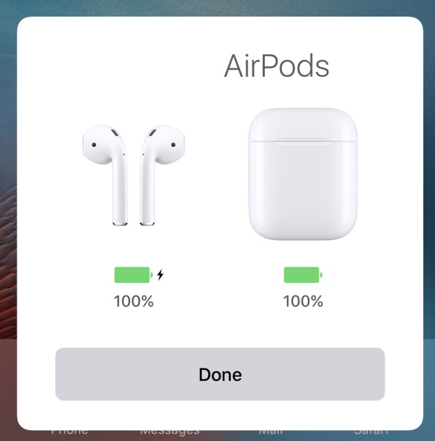

After charging mine and checking in the morning it was 100% both airpods and case 97%.
My conclusions are if you open the case to check battery life after a full charge. That is it. You are done. After i checked twice my battery is just draining now. And i do not get why because after 11 hours they only dropped 3 percent in the case. And now i'm on like 81%
This is what I am thinking. Part of me thinks that this is how the case is meant to operate and that the Airpods are meant to be behaving like this. 24 hours of battery life in the case might just mean that you have to charge the case every day.

I've been keeping track of mine over the past three days. The level that the case drops is hugely varied. Sometimes it dropped quite a bit. Sometimes hardly at all (and I mean with the AirPods fully charged.)
Crucially though, ignoring the weird figures reported by the battery. I am actually on track to get close to the claimed 24hours of playback.
Here's my chart for anyone who might be interested. The AirPods and case were both charged initially to 100% and since then only the battery in the case has been used to charge the AirPods. The case has not been recharged at any point since the initial charge.

Log 1 (auto ear detection: on. double tap: siri) DECEMBER 29 to JANUARY 2
Thurs 1330 - AirPods 98 / case 100
Fri 0500 - AirPods 100 / case 97
Fri 0600 - AirPods 97 / case 97
(used for 30 min, music)
Fri 0630 - AirPods 89 / case 96
Fri 0800 - AirPods 100 / case 87
Fri 1200 - AirPods 100 / case 81
Fri 1600 - AirPods 100 / case 75
Sat 0700 - AirPods 100 / case 72
Sat 0930 - AirPods 100 / case 65
(used for 140 min music, 10 min talk)
Sat 1200 - AirPods 47 / case 64
Sat 1330 - AirPods 100 / case 44
Sat 1830 - AirPods 100 / case 38
Sun 0900 - AirPods 100 / case 34
Sun 1100 - AirPods 100 / case 29
(used for 120 min music)
Sun 1300 - AirPods 63 / case 27
Sun 1430 - AirPods 100 / case 5
Sun 1530 - AirPods 95 / case 2
Sun 1630 - AirPods 94 / case 0
Sun 2030 - AirPods 72 / case dead
Sun 2130 - AirPods 63 / case dead
Sun 2230 - AirPods 55/68 / case dead
Mon 0200 - AirPods 33/52 / case dead
Mon 0600 - AirPods 11/36 / case dead
With set 3. Just over an hour of playtime. But 36 hours of standby. And my case is on 70%
I think I finally have a good set.
I strongly suspect the bug is somewhere in the action of opening the case and closing the case without using the AirPods.
In log 1, tracking the use and case charge from 100% down to 0% the average rate of % case charge used per hour was 1.06% per hour while in standby, in the case, not being used.
I then turned the double tab function off, and turned off automatic ear detection. In log 2, also tracking the use and case charge from 100% down to 0%, the average rate of % case charge used per hour was 0.82% while in standby, in the case, not being used.
Log 1 took about 73 hours to go dead, and I used the AirPods about 5 hours.
Log 2 took about 89 hours to go dead, and I used the AirPods about 6 hours.
I'm at the 73 hour mark now of Log 3. All the sensors were turned on, and I've only been checking the case charge as I take them out of the case to use them AND when I return them to the case after using them. Nothing else is different. (also, I've never reset or repaired the AirPods)
The case is currently sitting at 75% charge, with about 3 hours use of the AirPods. That translates into a case discharge of 0.13% per hour while sitting in the case not being used.
I'll run it down to 0%, but so far this looks to have resolved the issue. I feel pretty comfortable saying after 3 days that this is vastly different results than I previously had and not just the usual battery meter variation and randomness of flat readings and big drops.
There's some unanswered questions though:
- is it enough to simply take the AirPods out of the case, then put them back to avoid this bug?
- do you have to take the Airpods out, use them briefly, then put them back to avoid this bug?
- do you have to take the Airpods out, use them until say the charge goes below 95%, then put them back to avoid this bug?
Don't know the answers to those questions. I generally use them for at least 30 minutes at a time, but would be curious to see what happens if I take them out, use them for a second or two, then put them back. Or just take them out and put them back in without using them.
Here's the logs for anyone who is curious.
Log 3 (auto ear detection on, double tab Siri, only check before and after using them) JANUARY 6 to PRESENT
Fri 1100 - AirPods 100 / case 100
Sat 0930 - AirPods 100 / case 100
(used 120 min music)
Sat 1130 - AirPods 55 / case 99
Sun 1230 - AirPods 100 / case 88
(Used 20 min music, 6 min talk)
Sun 1300 - AirPods 89 / case 88
Mon 0600 - AirPods 100 / case 82
(Used 30 min music)
Mon 0630 - AirPods 92 / case 82
Mon 1200 - AirPods 100 / case 75
(currently using)
