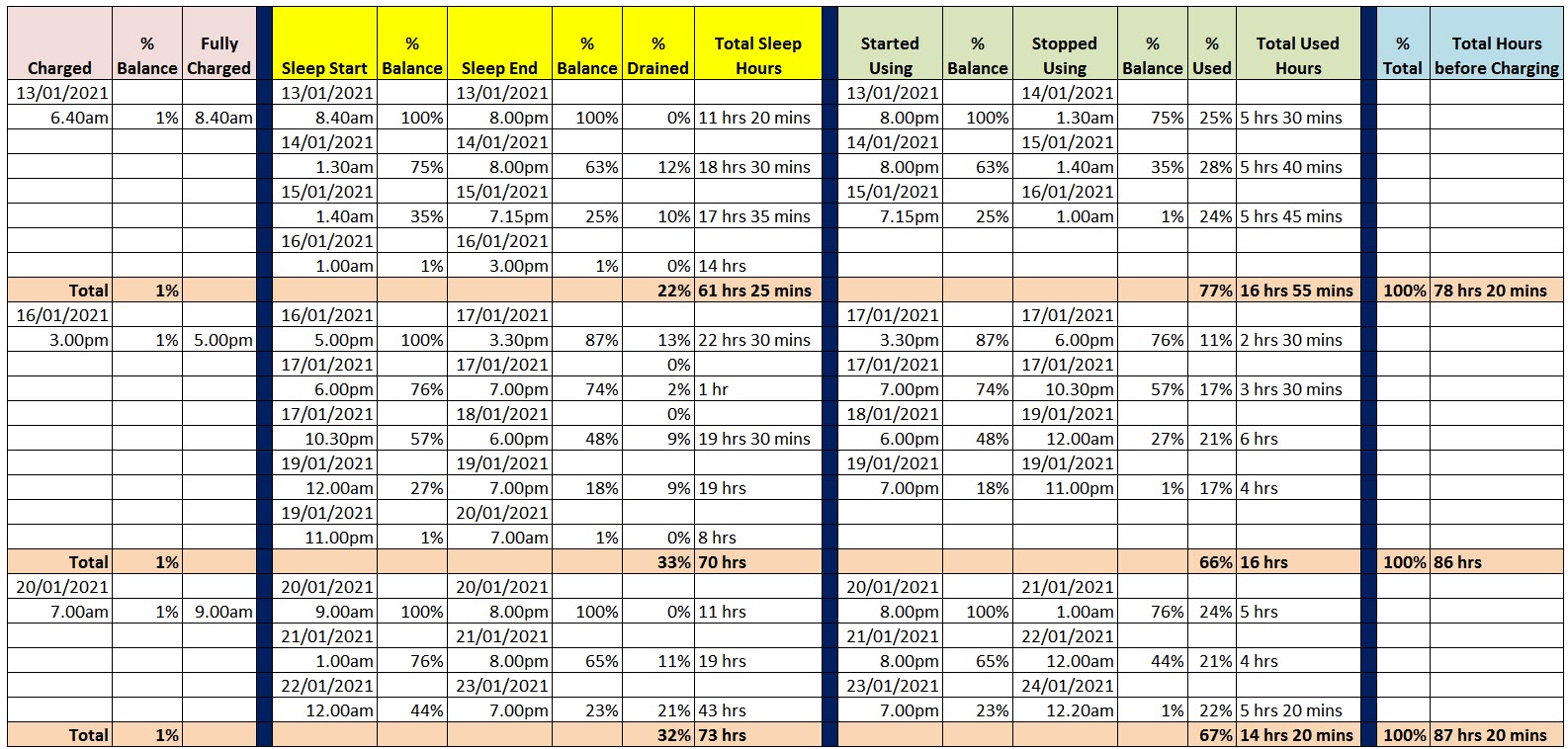

This is my usage for the pass 3 days and I didn't notice any massive battery drain issue. The headphones is in the Geekria Smart Case when not in use.
