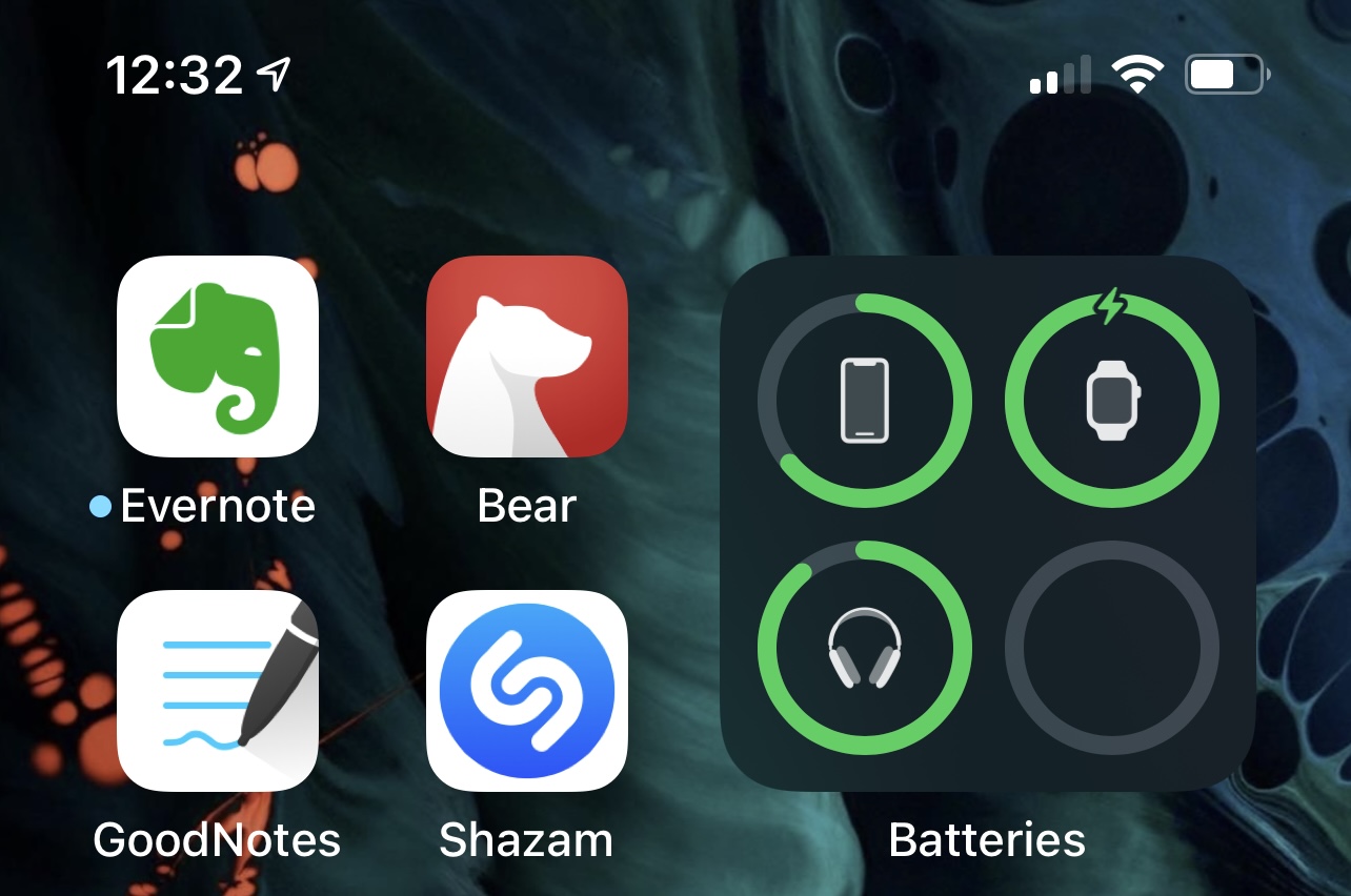

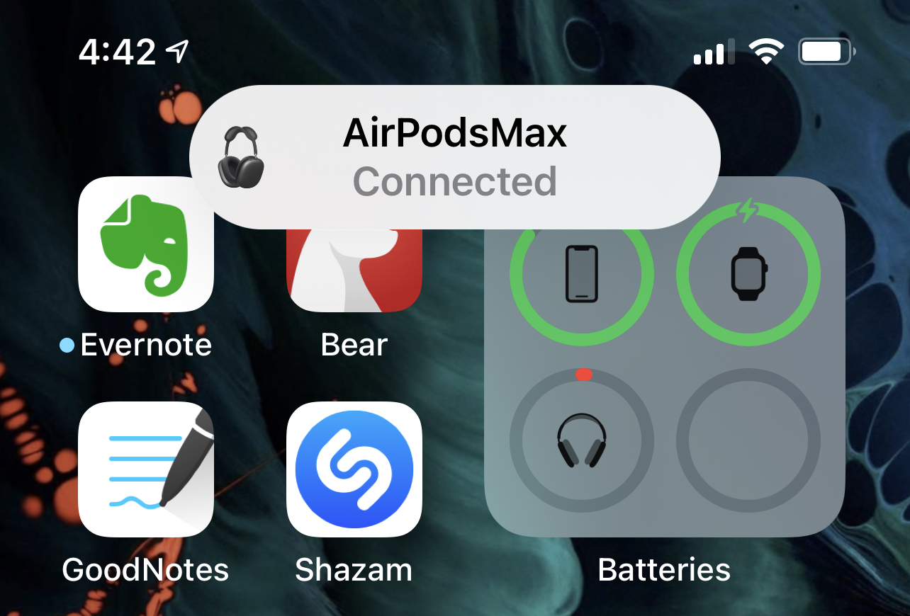

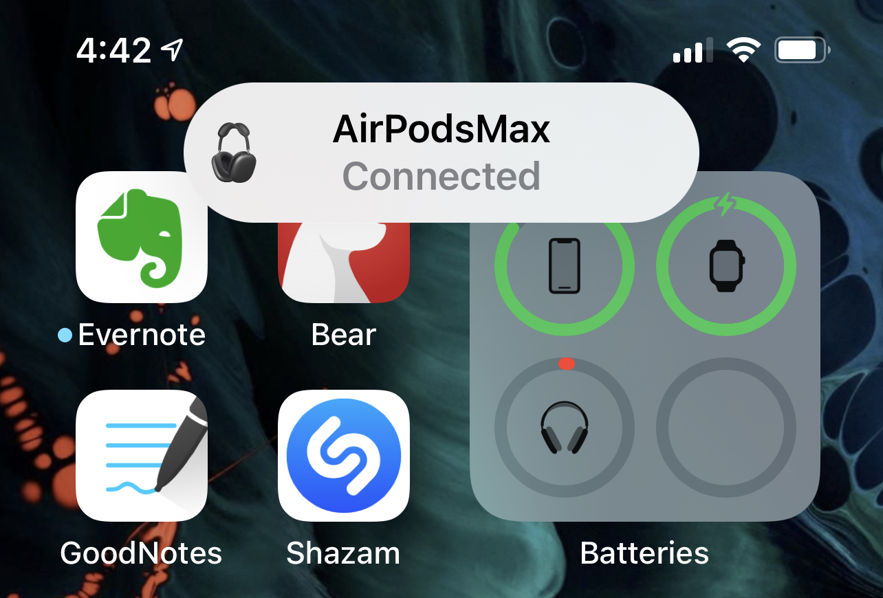

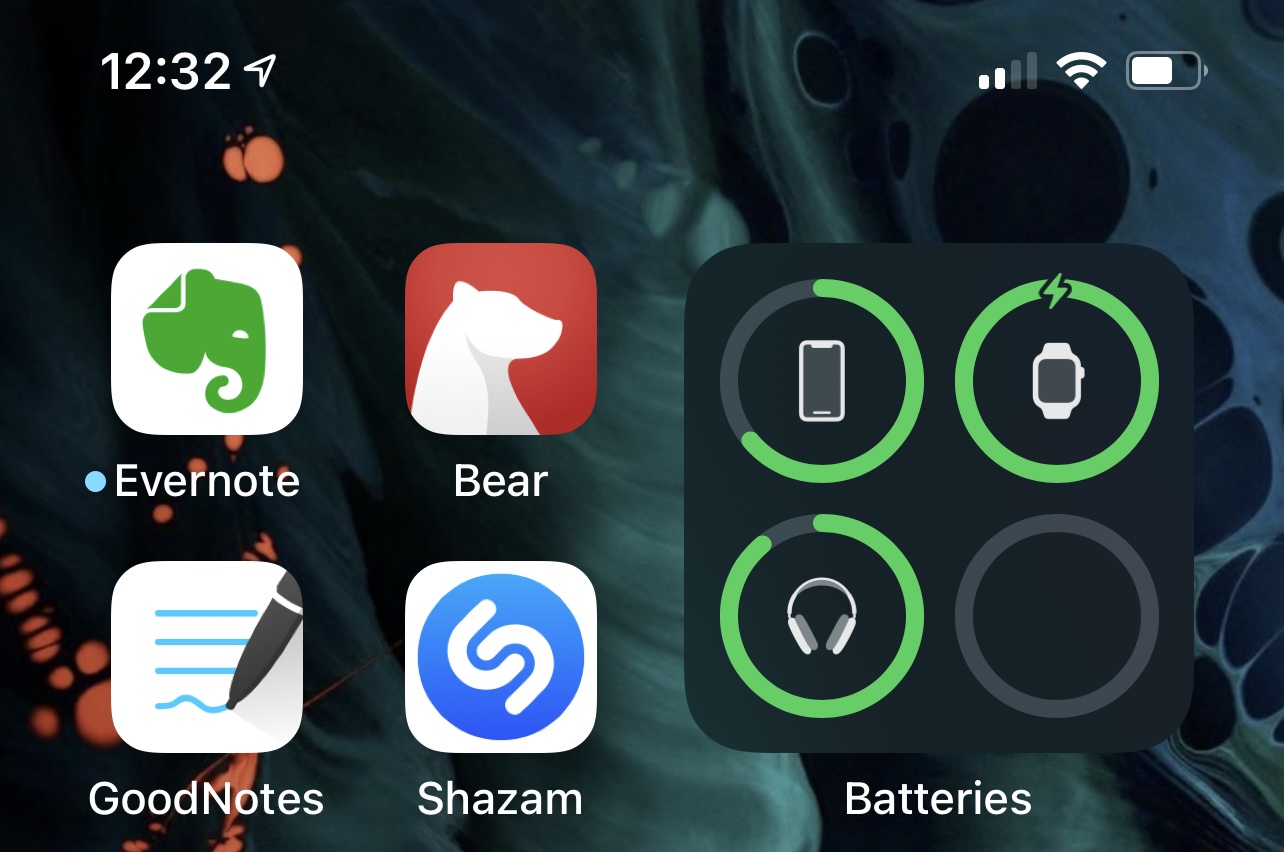

So I took a screenshot of the power of my APM when I put it in the bra case yesterday and another screenshot when I took it out of my bra case today. 0 battery With 0 use in Should have been the low power mode.
