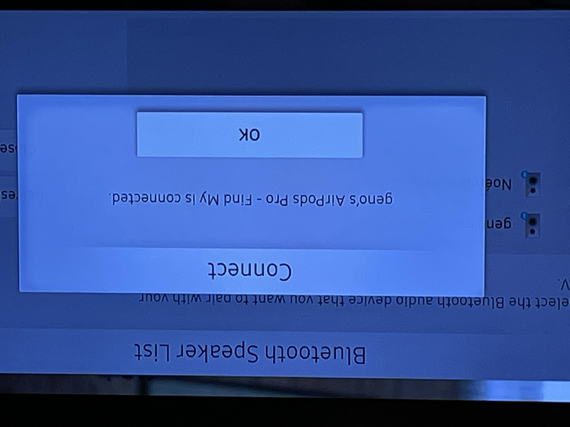

The crazy thing is my AirPods are named simply 'Geno' but when they are seen and connect to the Samsung TV the TV calls them 'Geno - Find My' without me choosing this or having any way to do anything differently. I have factory reset my TV 3 times and the AirPods about 5 times.

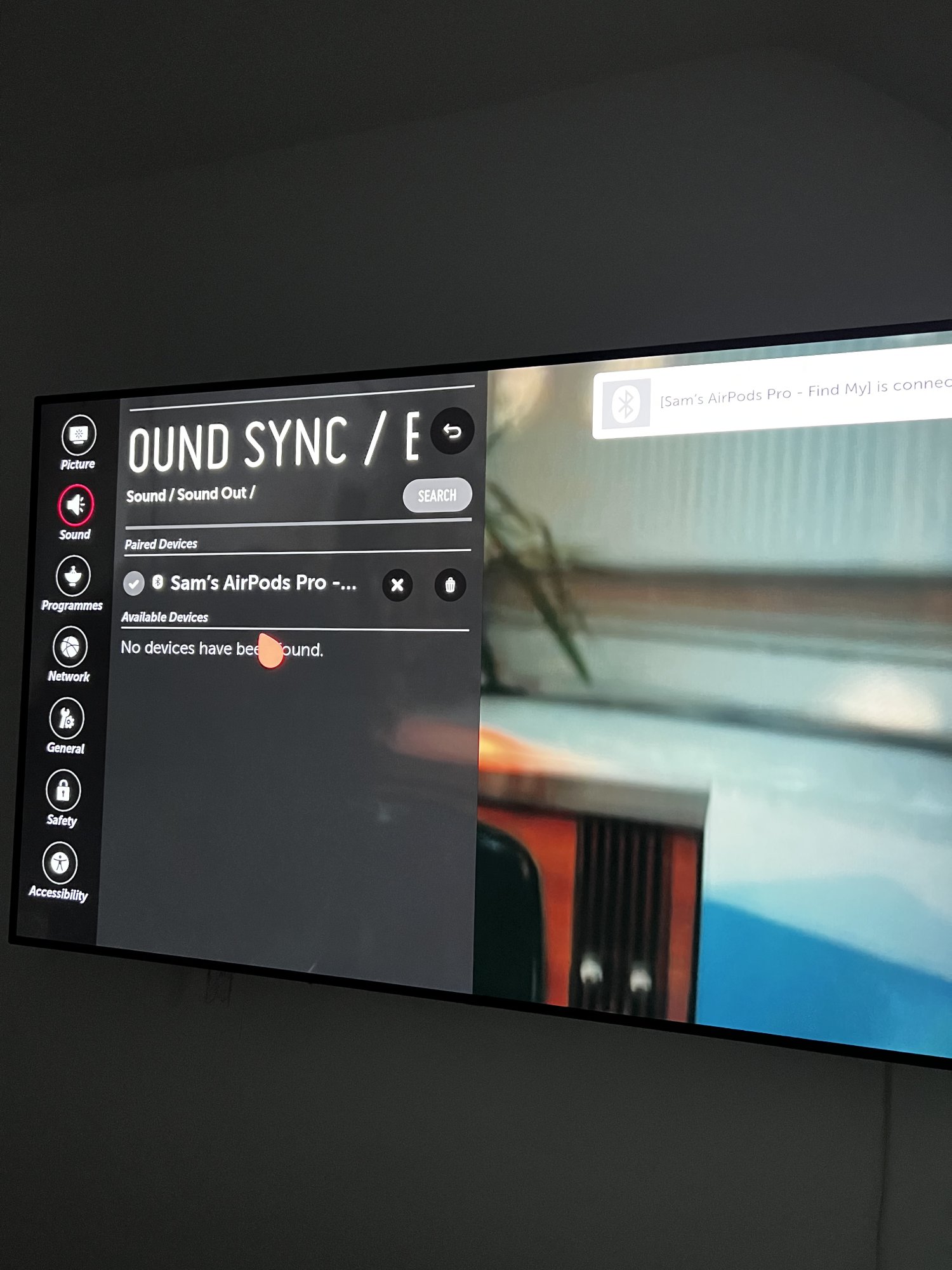

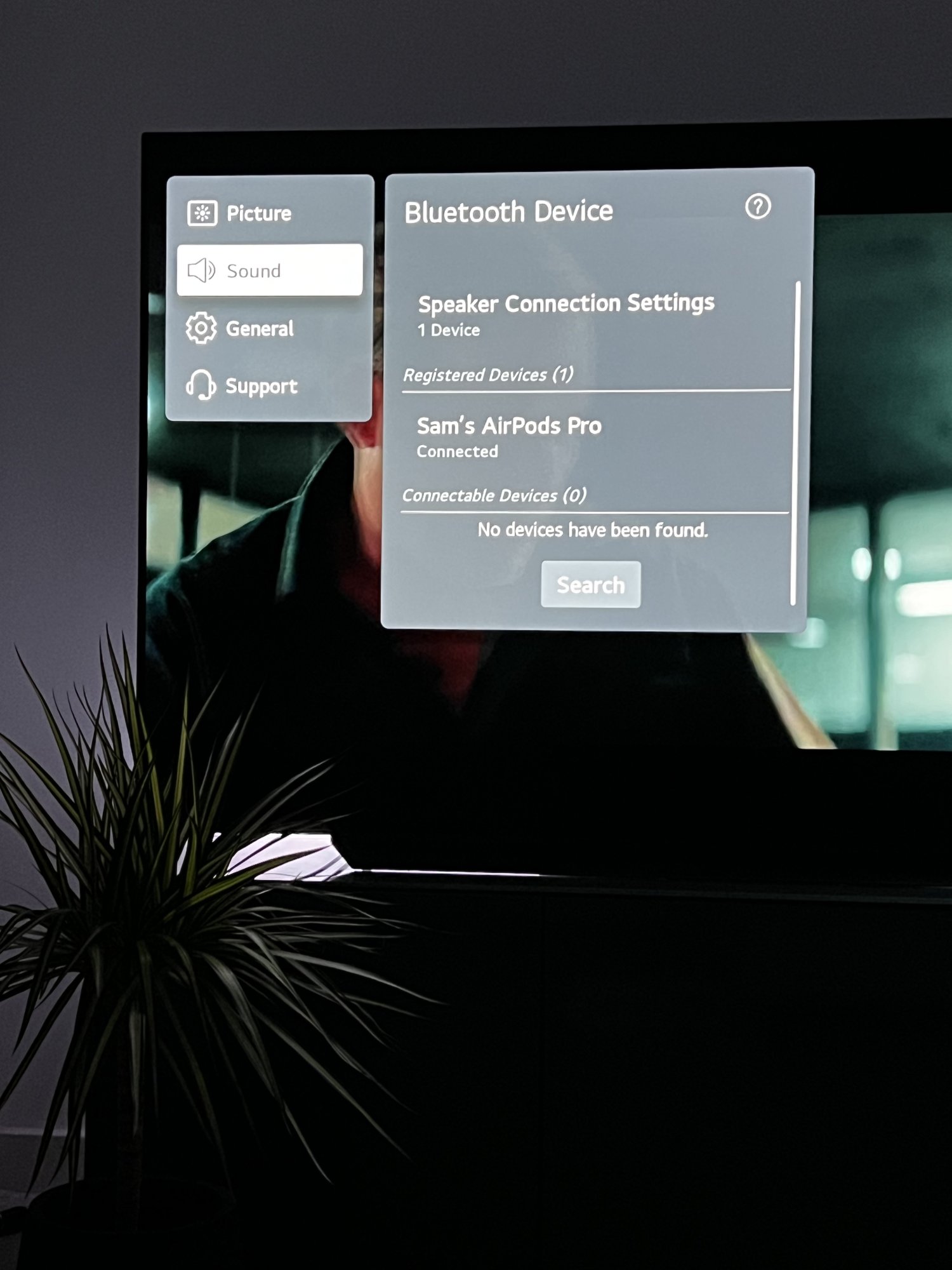

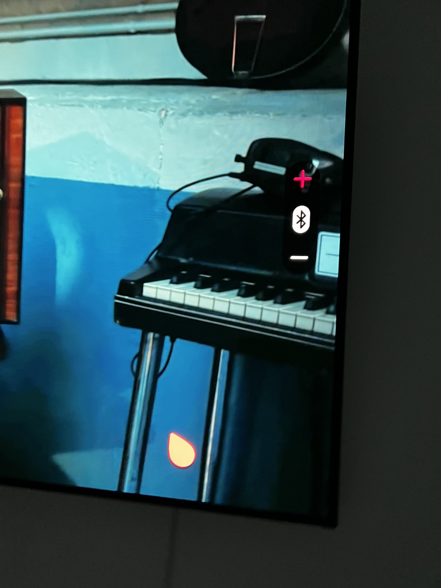

Brand new AirPod Pro2's, successfully connected to LG OLED. Volume control showing Bluetooth symbol on tv when volume is adjusted but zero sound coming through AirPods!
Mine also say "Find My" after the assigned name...
Apple want to sort this ASAP before they loose a right load of customers & everyone takes them back!
Version - 5A377
Please update on a fix or Apple update

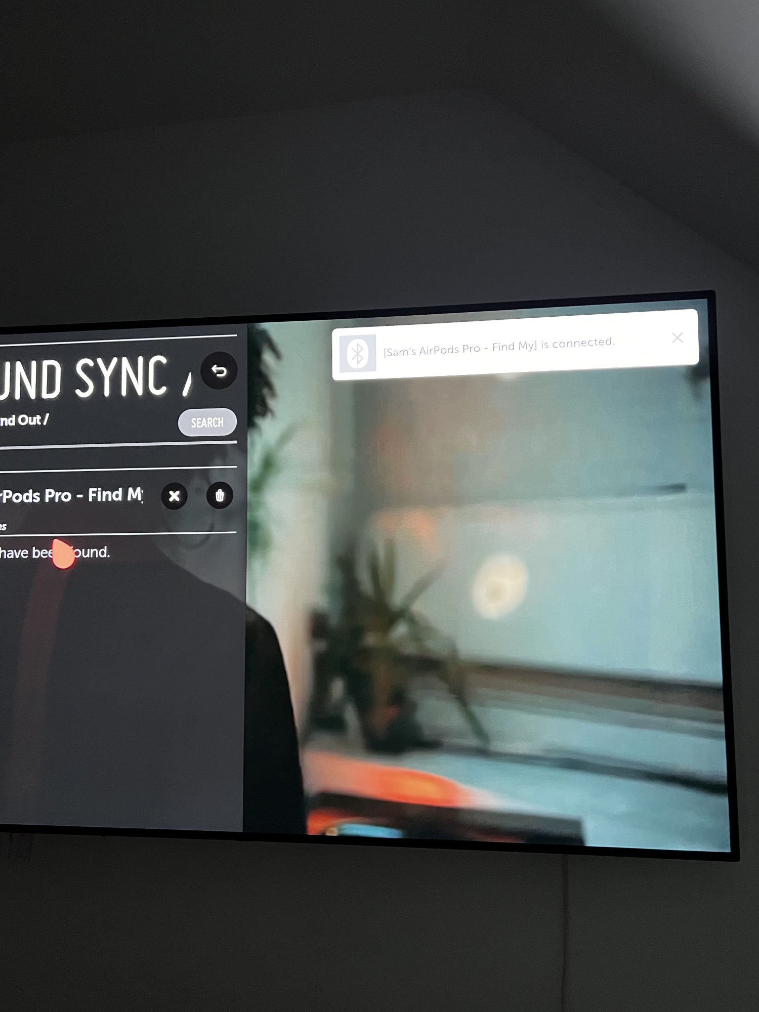

Not that this is any help to anyone but.. the above stays true with the tv in the bedroom OLED65 C7
However I can connect my AirPod Pro 2's perfectly and have full usability on my OLED65 C1 (in lounge)
Unfortunately & not that it should matter, the tv I need the AirPods to connect to are the tv in the bedroom OLED C7..
Also when connected to the OLED C1 (in the lounge) the AirPods don't show as "find my"
