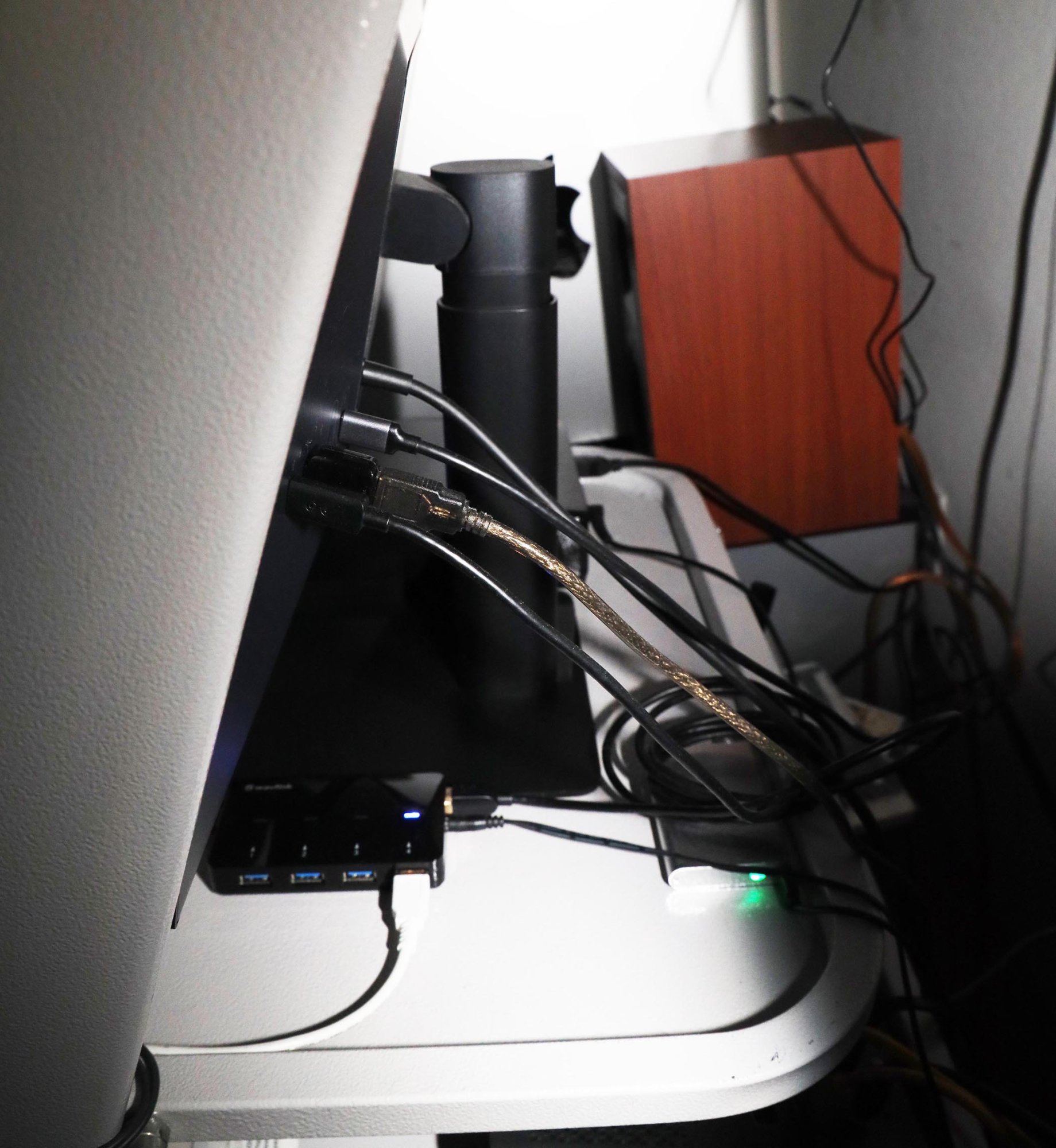

^^^^^I've been using mine for eight months now - LUV it👍🏻
Lou
^^^^No, the USB ports on the back of my monitor are enabled, so Yes it powers the monitor as a hub👍🏻
Lou
Lou
To confirm, you mean that you can plug in peripherals to the monitor and it will work on your computer when using this cable?
^^^Yes - 👍🏻
Lou
