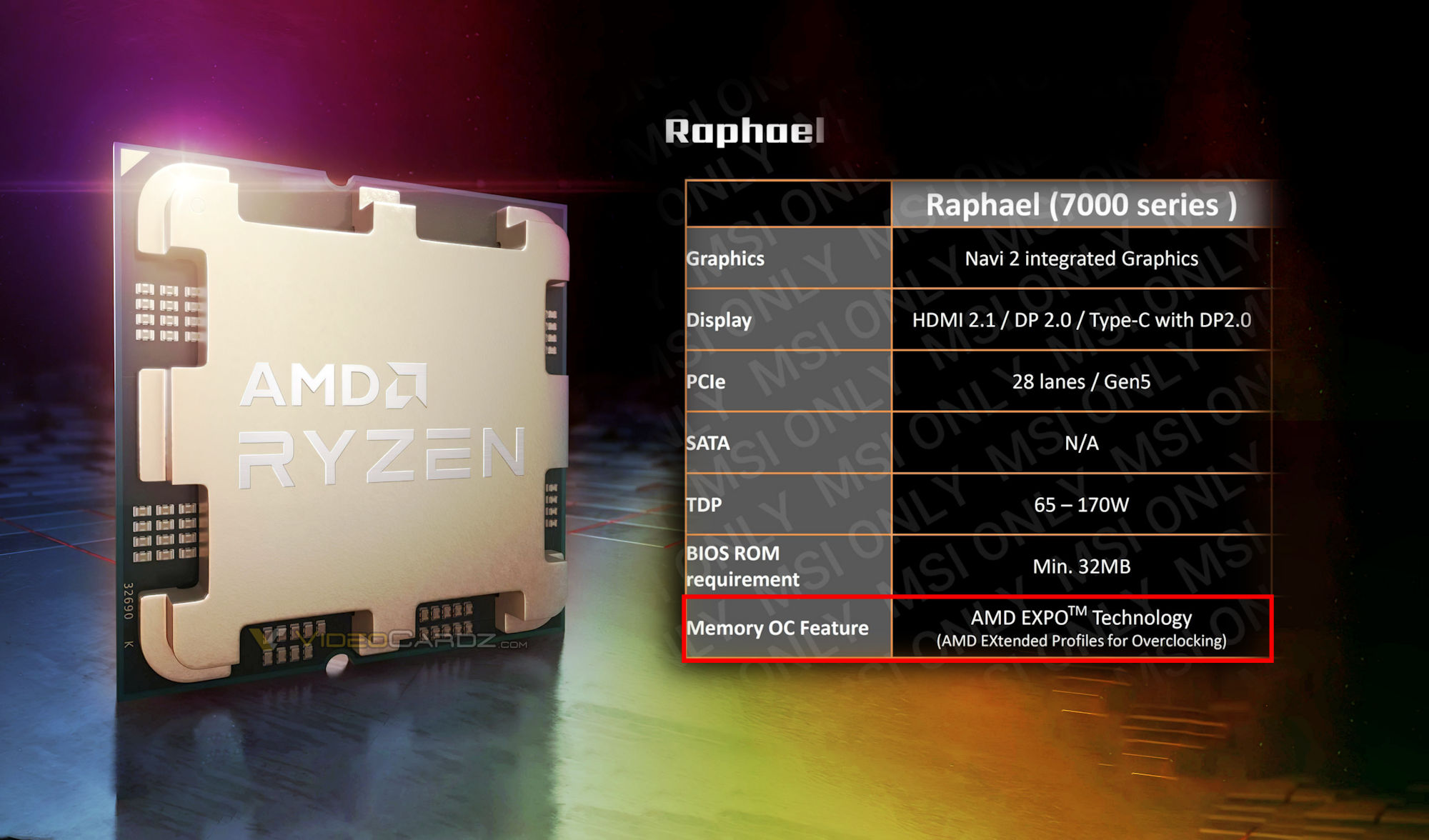

They are running in the 5.4-5.5GHz without doing any overclocking at all.
https://videocardz.com/newz/amd-confirms-ryzen-7000-5-5-ghz-demo-did-not-involve-overclocking
No memory overclocking with EXPO. There were rumors that overclocking was a substantive design focus for this iteration. ( that won't be an be upside for the laptop space , but AMD did Ryzen 6000 on TSMC N6 for that. )
For the hyper focused ST drag racing crowd with a hefty liquid cooler (or cryogenic fueled cooler) it is going to be more than 15%.
It isn't a laptop , simple GUI app optimized design. SIMD and multithreading got more weighting on this iteration. To go completely unidimensional on single threaded drag racing probably misses most of the upgrades.
The Ryzen 7000 also now has an iGPU present by default. Again not for the same motivations as Apple's laptop focus , but some fixed function ( e.g., video de/encode) and as a parallel compute resource.

It looks like AMD's new CPU will have a bigger jump in performance than AMD had previously stated.
During today’s Financial Analyst Day 2022, AMD clarified that it is targeting an 8 to 10% increase in IPC for the Zen 4 processors
AMD also clarified that Zen 4 processors would have >25% performance-per-watt and >35% overall performance improvements.
