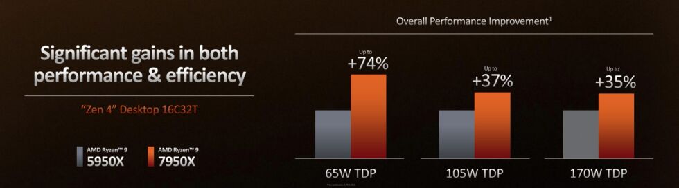

I have to say I was quite impressed by the new chips in particular the 7950X. Most surprising was not just the performance improvement over Alder Lake i9-12900K but the power efficiency from it as well (over 40%). That and the fact they also added AVX-512 functionality onto the chip makes it a sweet deal.

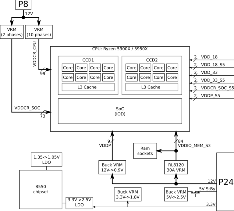

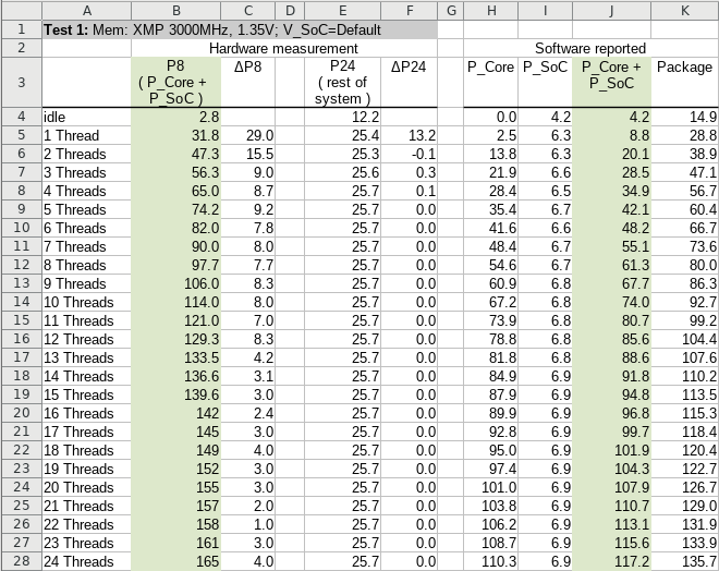

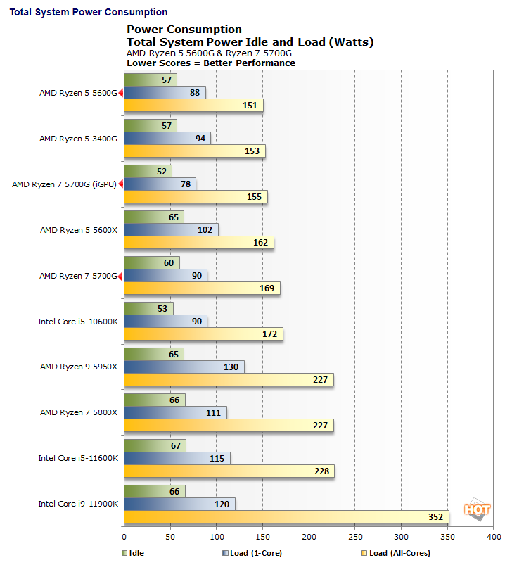

One thing that tech observers probably haven't noticed is that the new chips have much better power consumption.
This is where and how the increase in IPC and 42% system performance vs Zen 3/62% performance per watt (7950X) has largely come from (aside from the overall shift down to 5nm).
In the previous gen Ryzen 5000, the power drawn by the chip on various I/O subsystems at idle/load was a lot higher compared to Intel offerings. In the new chip, AMD has significantly worked on the I/O die (now at 6nm) bringing power consumption down to less than 20% of what it was before.
To confirm this, Hattedsquirrel provides an in-depth look on the power usage of the Ryzen 5000 series which shows in its tests that the 5000 series chip has higher than normal power usage compared to Intel, and that due to technical issues in how the chip works, these figures are not reported by software to the system vs hardware measurements taken from the chip, meaning the results of power draw on Ryzen 5000 chips are potentially much higher.

One thing that tech observers probably haven't noticed is that...
If you want to look at the effect of 12-nm I/O die, compare 5600G and 5600X, 5700G (not the iGPU one) and 5800X in your first graph. I assume HotHardware had done sufficient due diligence for the numbers to be comparable. We could see at idle the difference is about 6-8W. That's pretty much the extra power 'hog' contributed by 12-nm I/O die vs a possible hypothetical 7-nm I/O die in Zen2 & Zen3.
The I/O die is a power hog is an urban myth in Zen2 & Zen3, at least for consumer Ryzen systems.
Do note that these tests from HotHardware were most likely done at stock settings. Once you overclock the memory and/or CPU, the I/O die will consume more power than rated for. In part that was deliberate act by AMD's firmware and/or users in an attempt to address stability in an overclocked state of the systems.
EDIT:
Forgot to say the obvious! I do agree 6nm I/O die will be much better. I would speculate the package power of Zen4 Ryzen at idle would be as good as (if not better than) Zen2/Zen3 APUs which is <10W.
The new chiplet-based AM5 Ryzen also come with 2-CU RDNA2 iGPU. That's great news to use these processors for building home labs, VMs, SOHO servers & etc without waiting for the APUs. More than enough PCIe slots/sockets and bandwidth for expansion in such use cases. Will definitely retain some of the users from the necessity of moving to EPYC or Threadripper Pro.

Aren't those all 1 CCD systems? Seems like the IO Die would draw more power on multi-CCD chips, or am I wrong about that? My 5900X, last time I checked seemed to report a roughly 20W difference between Core and Core+SOC when under load.
kvic
macrumors 6502a
Sep 10, 2015
516
460
I prefer to look at "CPU package power" or PPT. Single-CCD and two-CCD Ryzen are about 11W and 15W at idle with stock settings.
I always suspect Psoc (from SVI2) doesn't cover the full picture of uncore. AMD officially in their Ryzen Master likes to present you with Pcore, Psoc individually (together with % of PPT though). Not so sure about the rationale behind it..
