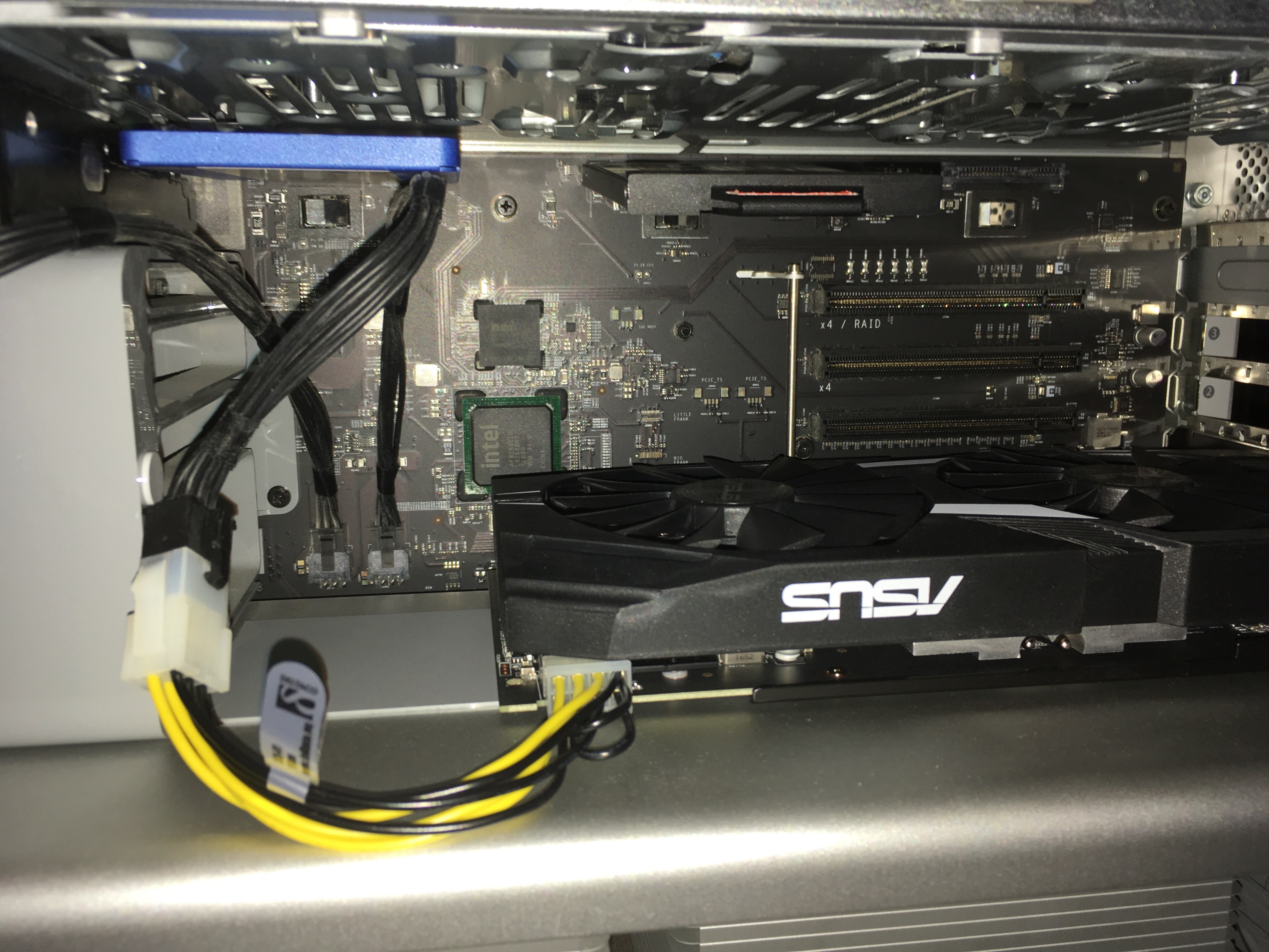

I bought two 6pin to 8-pin adapters and took the power from the two nearest outlets, just next to the GPU's.
My 580s however aren't from the Sapphire brand but from Asus. Could this matter?
I haven't done anything with the drivers, I've read the 580s should have native support? But maybee I need to look into the whole Kext-subjet?
It's a 2009 but flashed to 5,1.

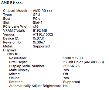

Perhaps I've misunderstood here, but are you driving each 580 with a single mini 6 pin to 8 pin adapter?
Surely you should be using a dual mini 6 pin to 8 pin adapter for one card, and then be powering the second card through other means.
As I said, I may have misunderstood what you stated however. Please correct me if I'm wrong.
Looking at the picture that was posted it does look like they used a 6-pin to 8-pin adapter, not a dual 6-pin to 8-pin adapter. There is only one feed going to the video card. The card must be drawing all it can from the single source and is able to boot, but when it is put under a load it is underperforming because it is underpowered.
I have a MSI Radeon Rx 580 Armor 8G OC installed and I used a dual 6-pin to 8-pin adapter and I have had no problems with this card. All Radeon Rx 580 should work ok as long as you properly power it fully.

The card from ASUS is not a problem. However, you connect a 8pin to a single 6pin is the problem. You should not do that on a cMP.
The correct cable to be used is the dual mini 6pin -> single 8pin.
