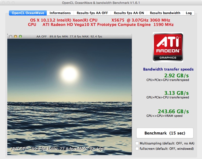

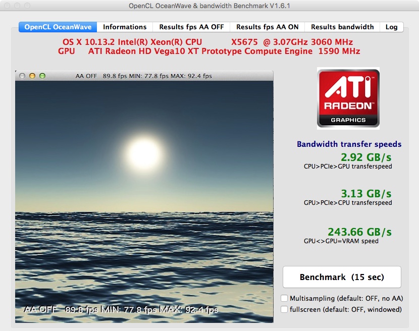

Is there an accurate way to measure PCIe bandwidth with the AMD card? The OceanWave benchmark app does not appear to give the correct info and lspci ran from the terminal lists the link speed as unknown. (I opened OceanWave before, during, and after the LuxMark and Valley benchmarks and it shows about the same results.) I ask this because the system profiler shows the link speed as 8.0 GT/s and GPU-Z in Windows says the card is operating in PCIe 3.0 mode. Could the recent firmware update from Apple enabled PCIe 3.0?
h9826790
macrumors P6
Apr 3, 2014
16,656
8,587
Hong Kong
100% sure you won’t get 8GT/s in cMP.
And 99.99% sure it is actually running at 2.5GT/s

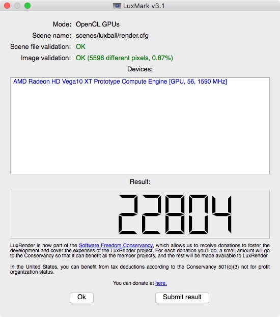

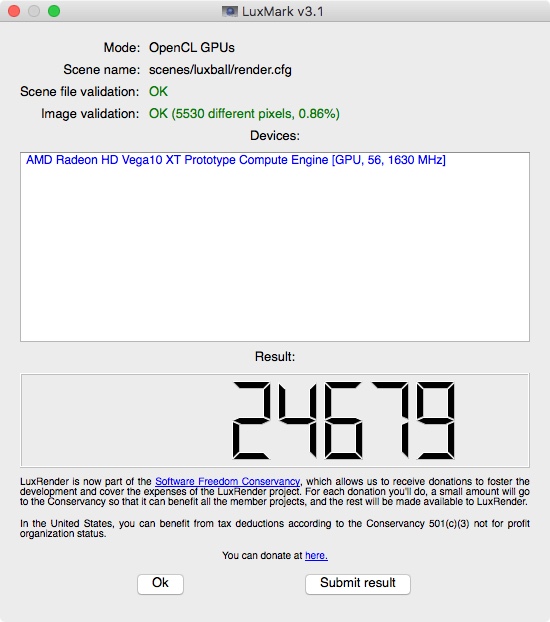

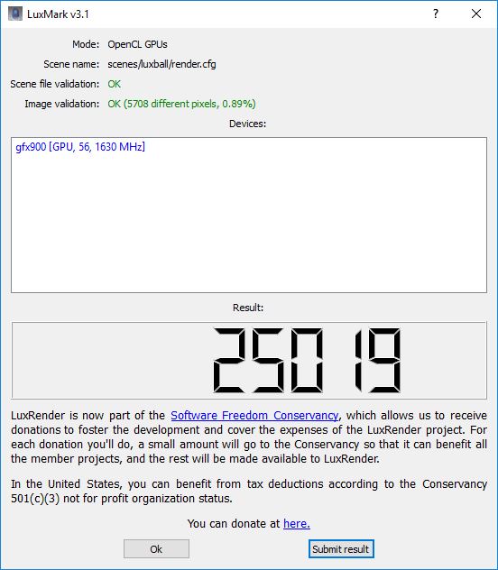

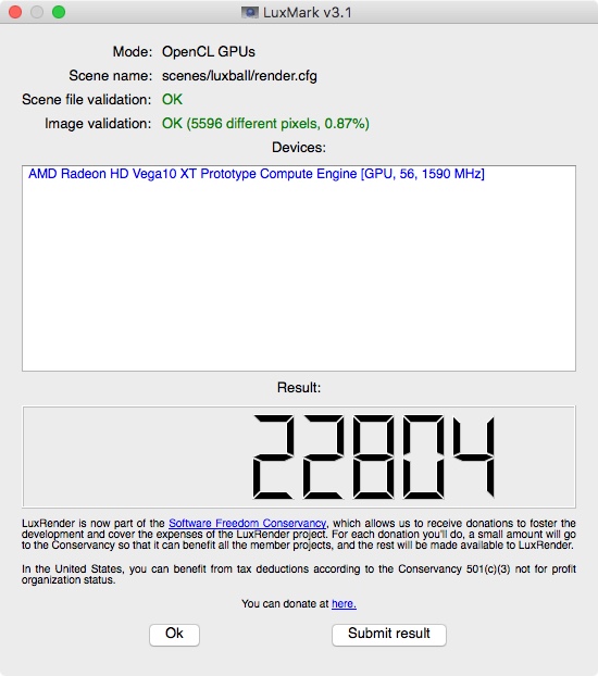

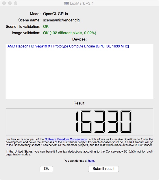

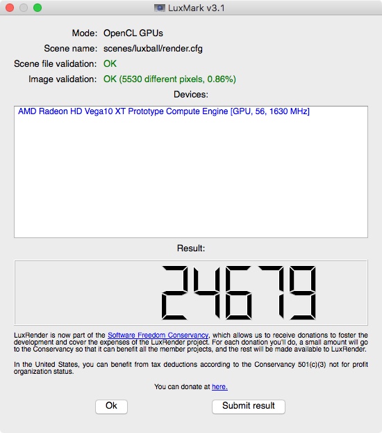

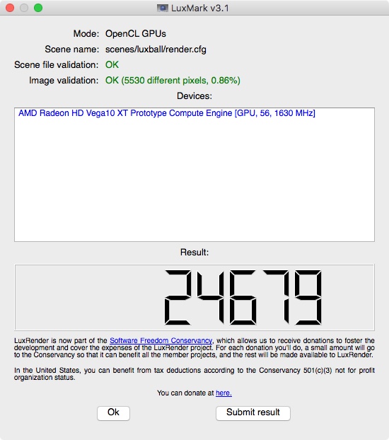

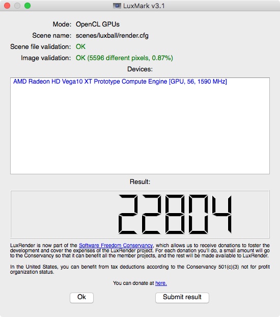

My Vega 56 is a little faster with the Vega 64 bios.
View attachment 737809 View attachment 737810
It looks like more than "little bit" :D
The performance increase should be coming from higher clock speed. But it shouldn't be that much. May be the Vega 64 driver is better than Vega 56 in MacOS.
Also, do you have the power draw comparison before and after the flash?
MisterAndrew
macrumors 68030
Sep 15, 2015
2,895
2,390
Portland, Ore.

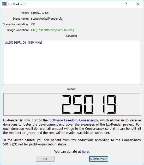

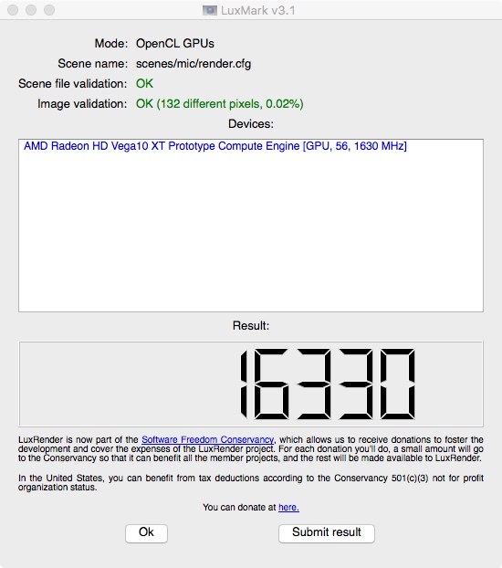

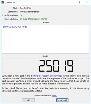

Yeah, pretty good huh? It was easy too. I don't have iStat installed anymore, so I don't have a comparison on power draw. It's a little faster still under Windows 10.
[doublepost=1511434287][/doublepost]It turns out I flashed the secondary Vega 64 bios to it. So I flashed the primary bios to it and ran a couple more benchmarks under MacOS. Luxball scene was a little higher, but the mic scene was actually a tiny bit slower. So there doesn't appear to be a performance difference in MacOS between the primary and secondary Vega 64 bios.

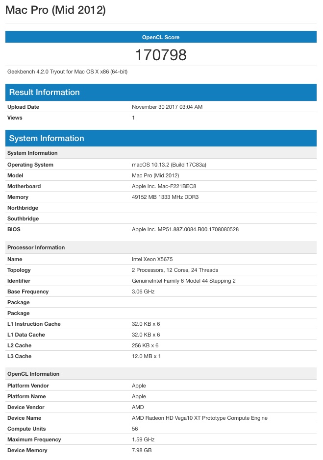

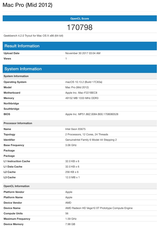

Has anyone tried one of the other Vega GPUs (not RX Vega) such as the Frontier Edition or WX 9100 with 10.13.2 yet?
Edit: Just found this thread for the FE.
[doublepost=1512011460][/doublepost]Here's an OpenCL Geekbench 4 result with the latest beta with the stock 56 bios. I'll have to try it with the 64 bios. 170798 up from 152085 in 10.13.1.
