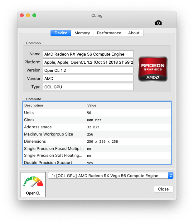

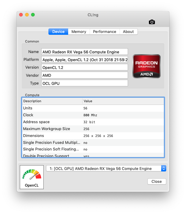

I just noticed that my Sapphire Vega 56 Pulse runs only at 800 Mhz clock speed with Mojave 10.14.3.
Clock speed on High Sierra is 1590 Mhz. Why is that? Any solution for this?
It’s probably inaccurate. Run some benchmarks.

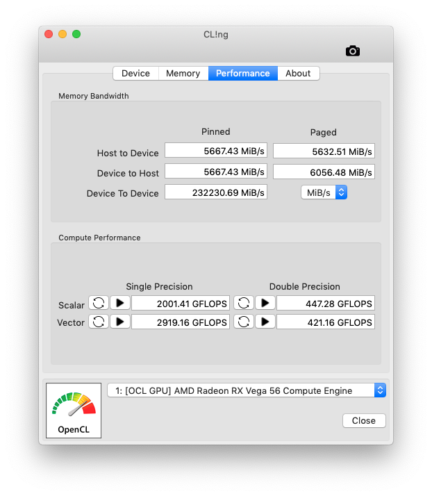

Ok, CLing's OCL Single Precision scalar and vector benchmarks are about 1000 Gflops slower in Mojave than in High Sierra. Just checked it. Whereas Double precision benchmarks are about the same in both OS.
Metal performance is about 800 Gflops slower running Mojave. Also, High Sierra running CLing shows the correct clock speed of 1590 Mhz.
What does your Vega 56 show in CLing with Mojave? 800 or 1590 clock speed?

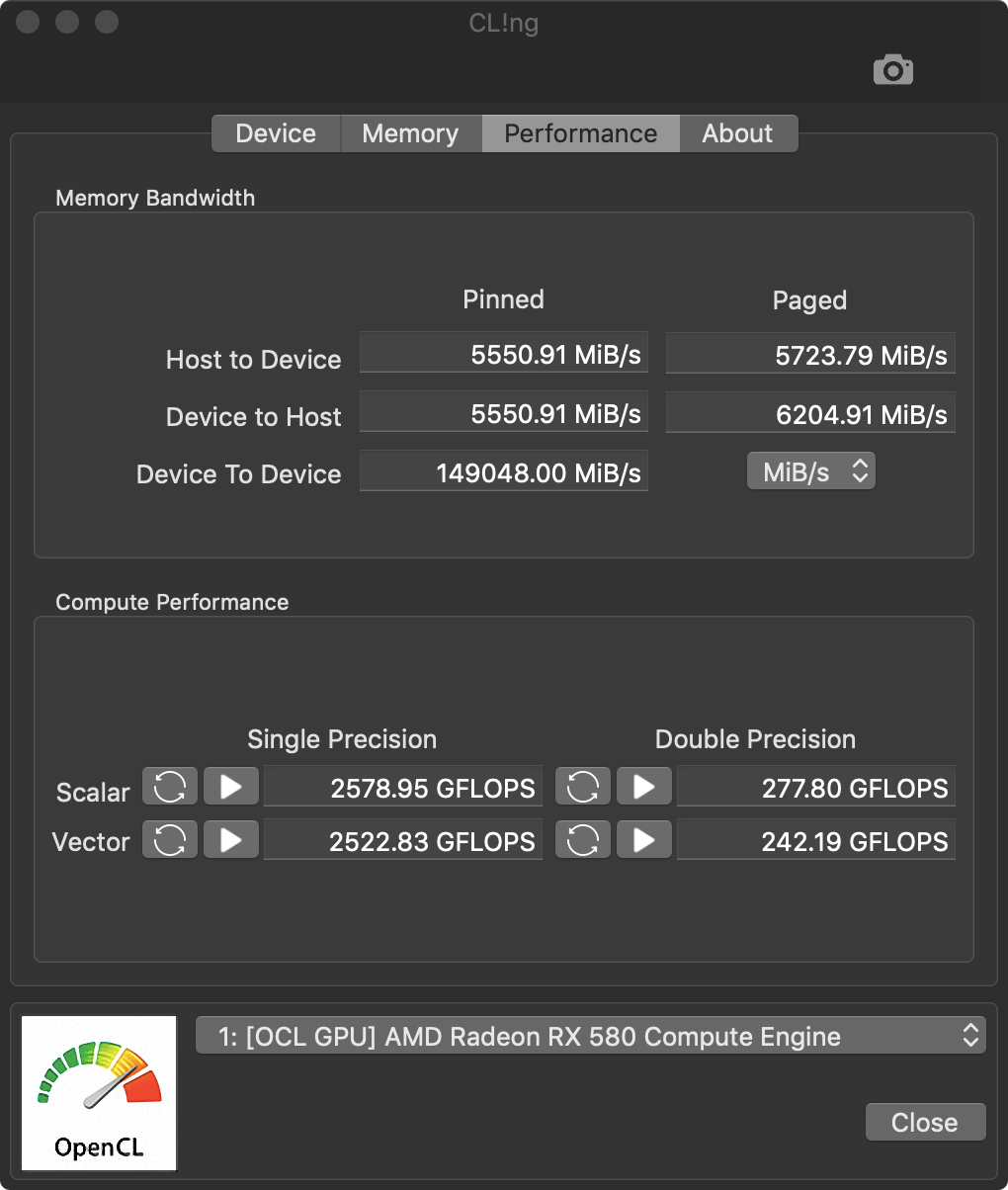

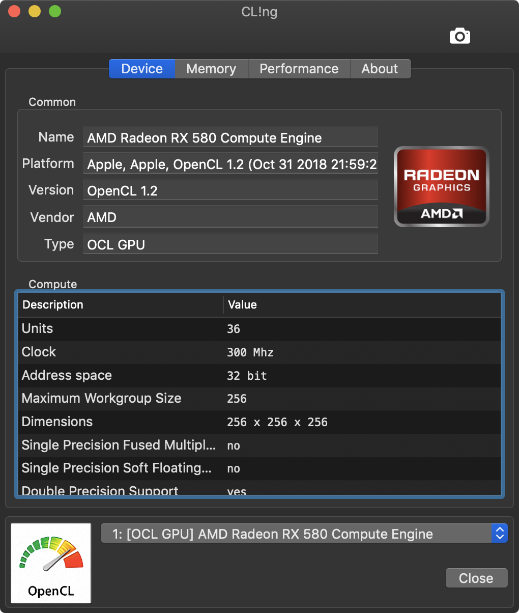

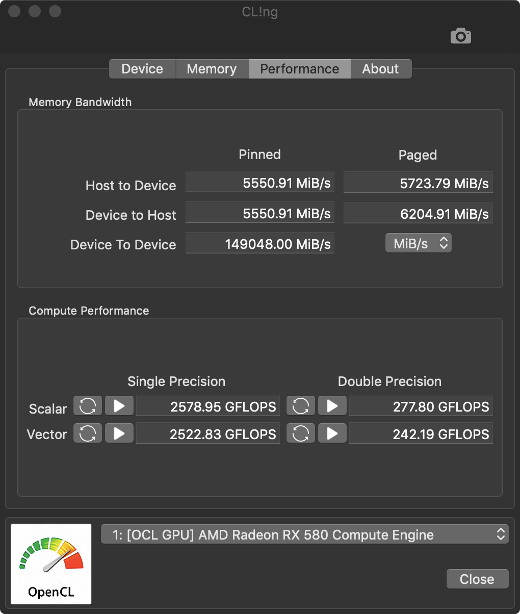

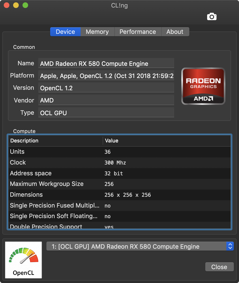

Not Vega but RX580 here. The reported clock speed is wrong in Mojave.
But the card performance few % better than in High Sierra in all aspect (or at least in the normal range). If only running at 300MHz can get this performance, I will be very very happy.
Check performance in productivity apps and games. If nothing wrong there then CLing is the culprit and needs to be updated for Mojave.

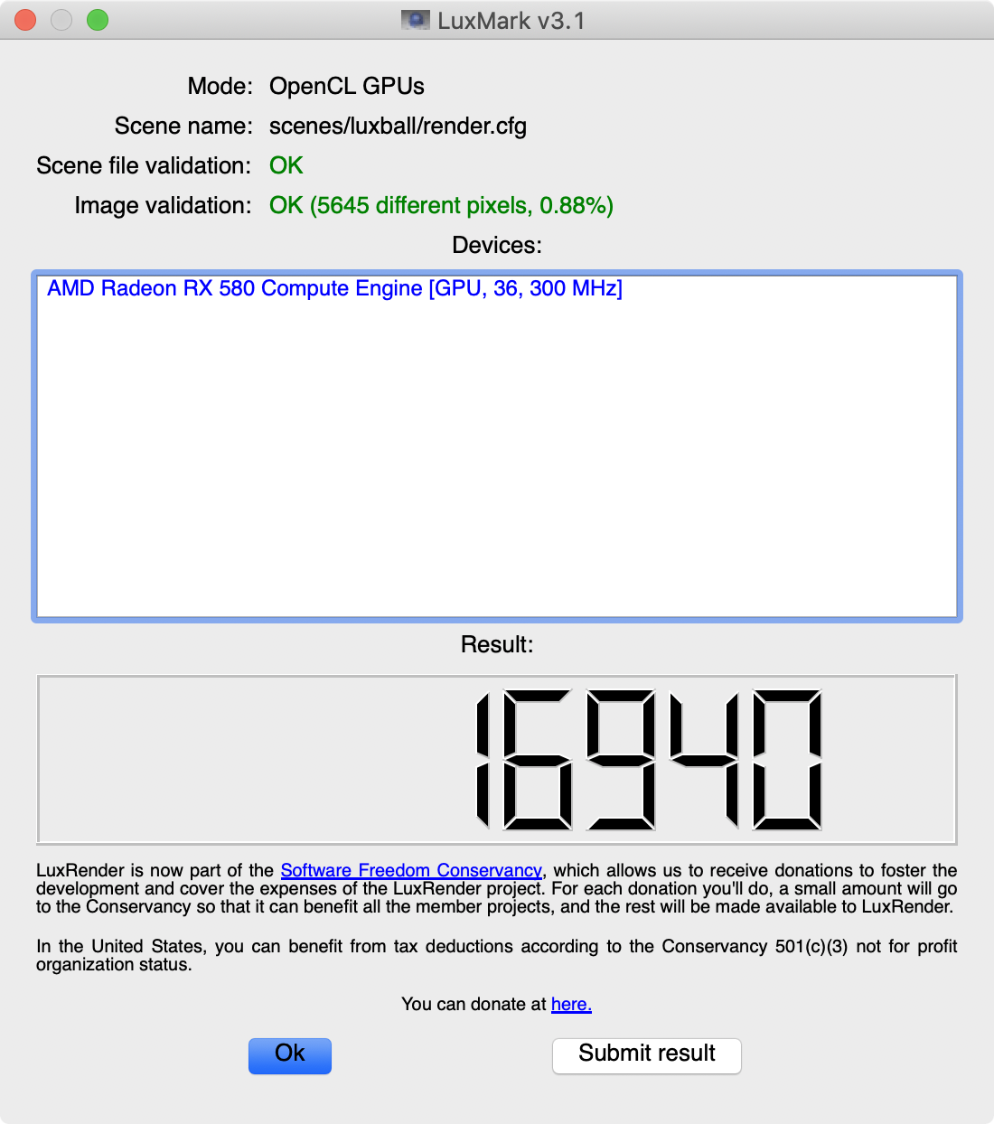

Each OCL app shows wrong clock speed in Mojave (Cling, Luxmark, Oceanwave).
Though performance and most benchmarks look okay - except Cling's Single Precision scores which seem to be too low.

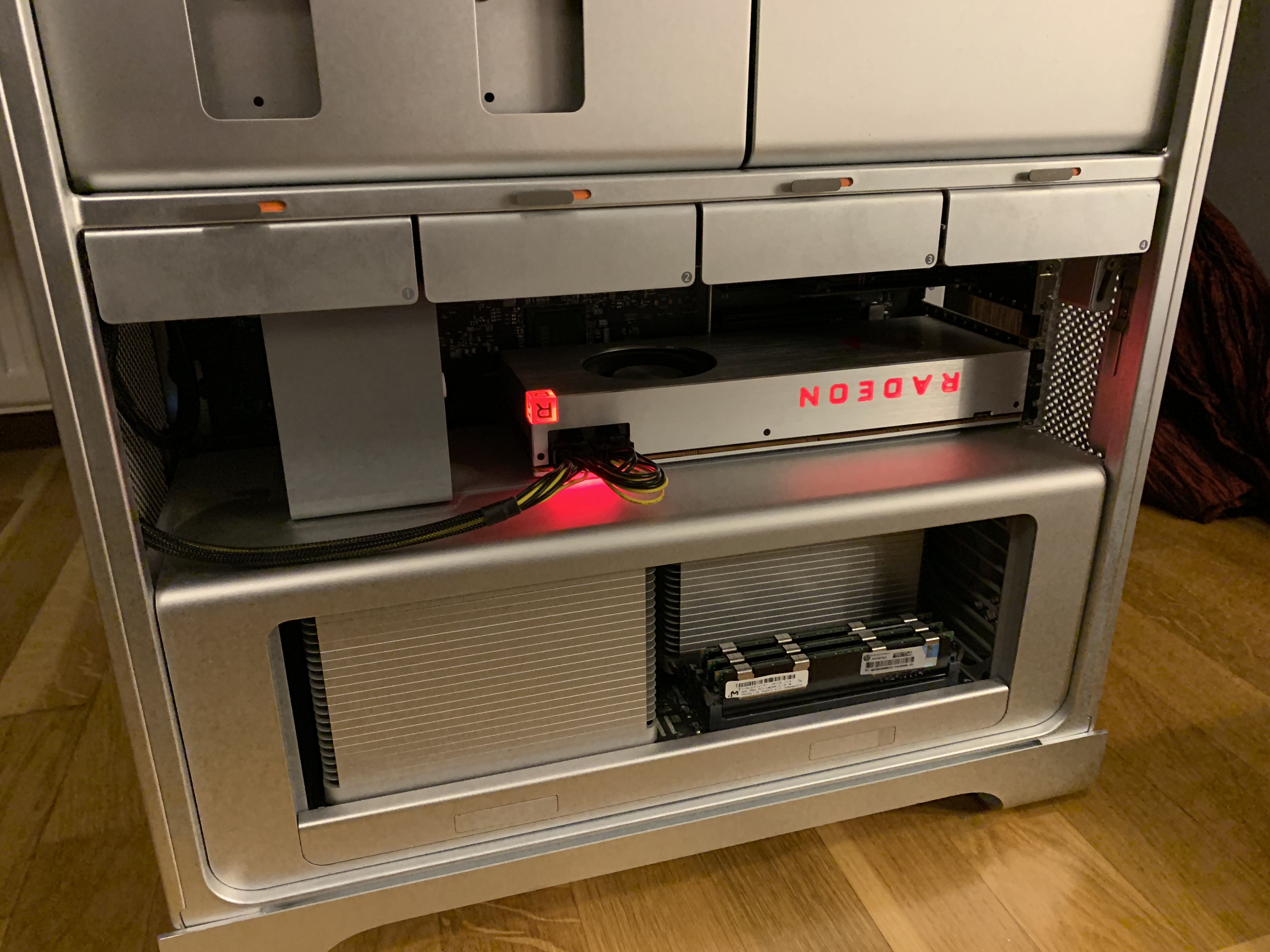

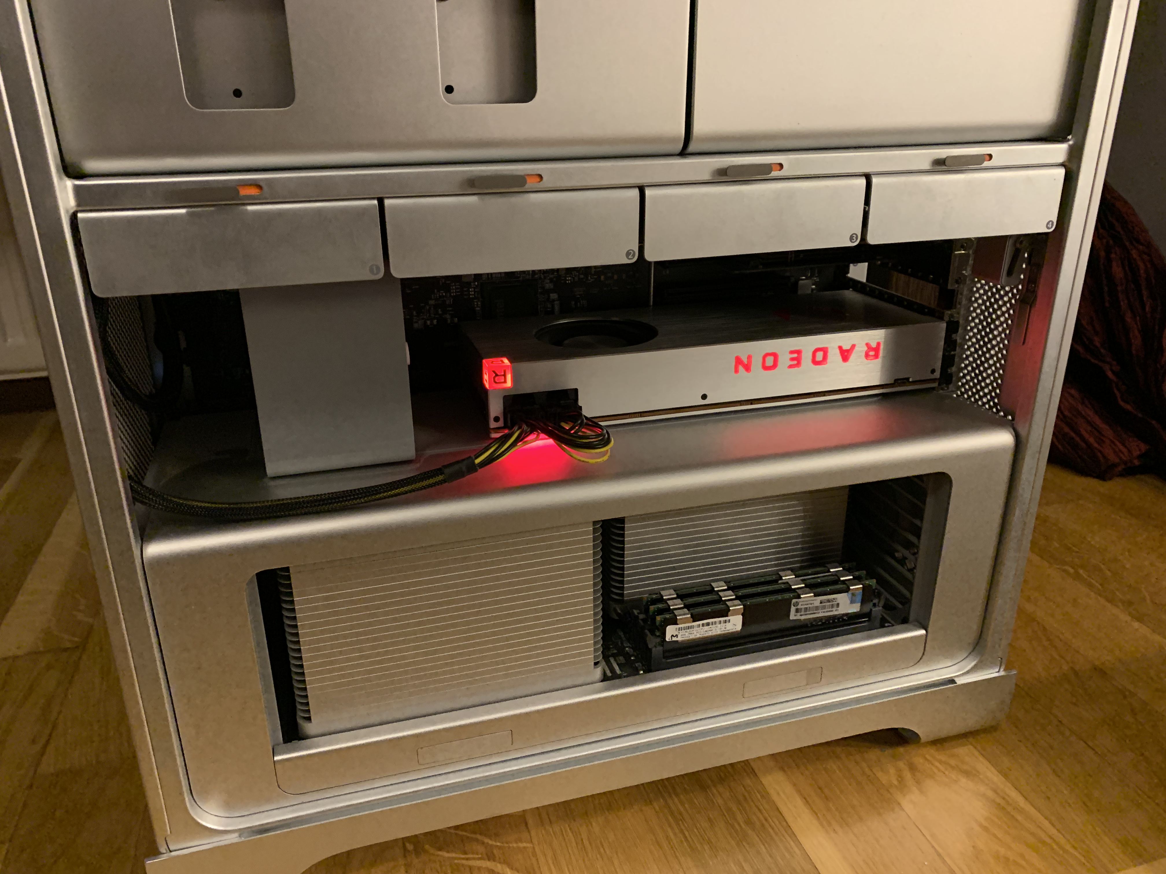

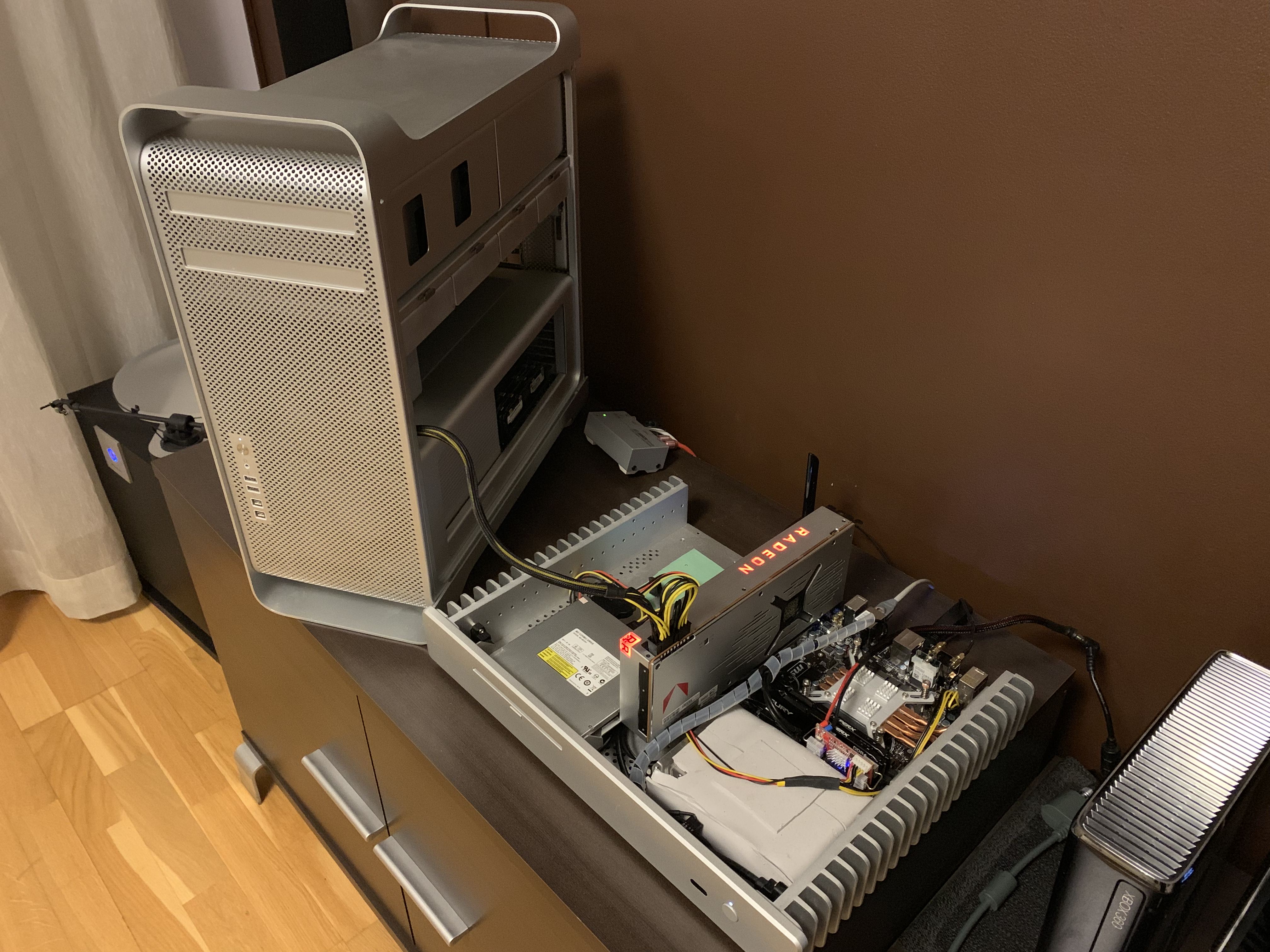

Finally upgraded my old 280X to Reference Vega 64 after adding the Pixlas mod.
Really didn't want to mess with Bootcamp for BIOS flashing, so I had to improvise with my ultra slim fanless HTPC and used Mac Pro as a power donor. Used the secondary BIOS (as per original post).
Fan is off on idle, spins up under load and then stops properly. Valley Benchmark on Extreme settings is 63 fps, and LuxMark Luxball is 28567. Of course on Windows Valley is 82 fps, but I'm still happy with MacOS performance.
Thank you so much for sharing! Your setup really looks awesome. Since the Vega 64 has this mini switch close to the connectors on the PCB, could you elaborate on the Bios flashing method? Does it make a difference which position the switch has during the sencondary Bios flashing process? I am all set and done, my Vega runs great with the Pixlas cable. But somehow I am a bit worry about the Flashing process. I don't want to brick my Vega. Could you give a recommendation or advice?
About the bios switch.
You can only overwrite the second bios. Primary bios is fixed and cannot be overwritten. I've tried, it doesn't allow the flash there.
This means nothing can go wrong. In case, you can always switch back to the working primary bios, boot, switch to secondary and flash.
You should be fine ;-)..
