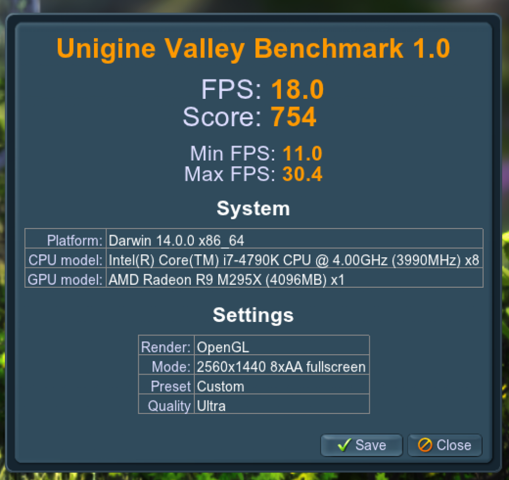

I did it 4 times to get it right.
Set a mark, lets say 2700 frame. Get a shot at fullscreen in 2700 framish, near the end. Do another test and when in 2700 frame, get the rpm for macs fan control or istat or what ever.
Now, you got two shots, for two different runs...but in fullscreen and rpm's are about there where they really are. Temps, frames etc are from the same test (from a fullscreen shot taken), but the final result is from another run. So, both runs are done in fullscreen from start to finnish without alt+tab desktop stuff or taking shots..

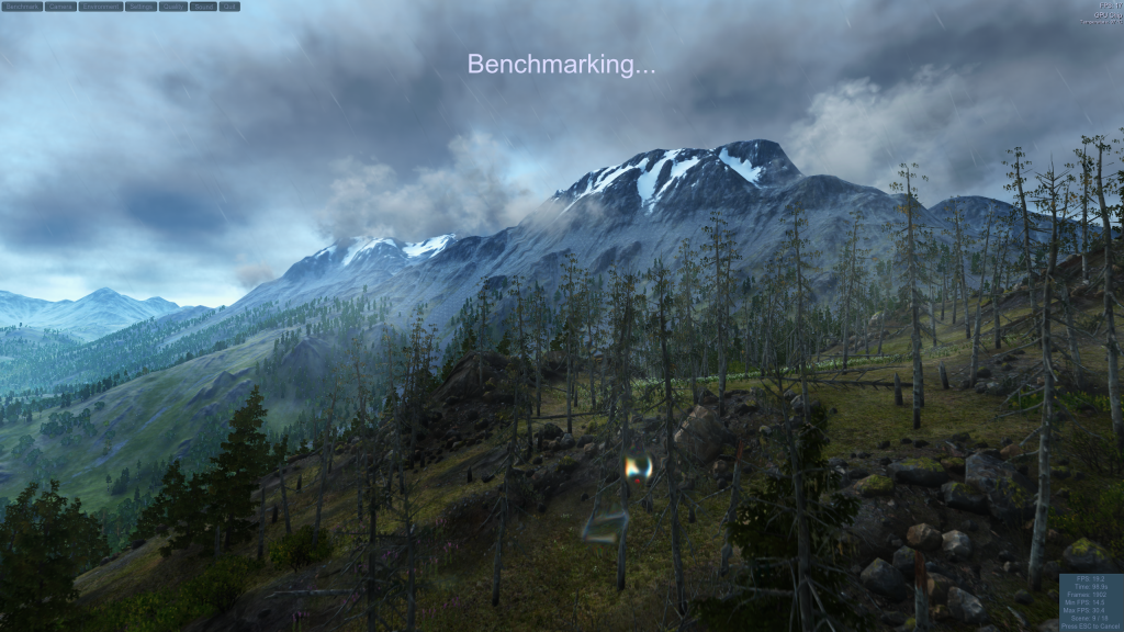

And where might be this fullscreen shot that we are all talking about? Why windows? I dont use windows. Macs fan control shows 1205rpm with 56c GPU? That's not taken in the middle of the run? So 4k resolution keeps your GPU cooler than 1440p windowed run earlier? Pretty much BS.
Screen shots after screen shots, but the one that counts is missing? I wonder why...

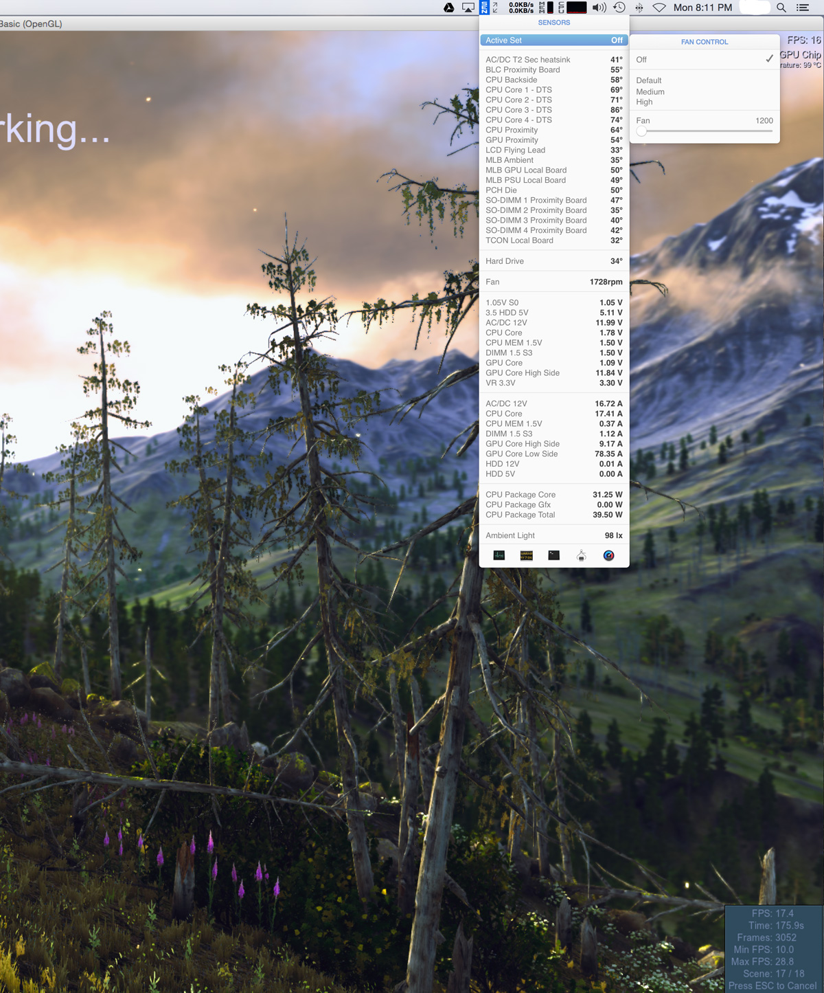

98° Under Os X at 17/18
Click for full resolution :
Windows is for a better analytics tool like afterburner, and don't look Macs Fan, is obvious that the rpm is running down after the test.
In my case I have same readings in all the software I'm using (Macs Fan, iStat, Afterburner and so on)

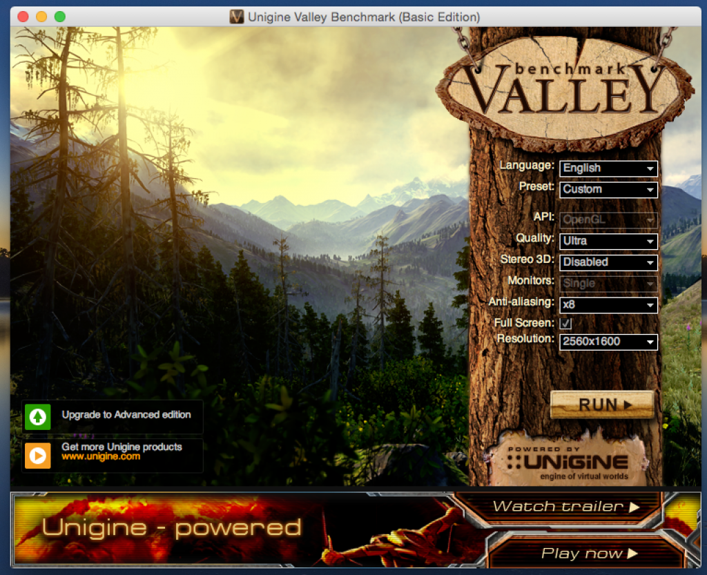

I decided to run this bench with the settings above on ultra full screen. temp got to 97c so i am quite happy with that, and if improvements come later with driver updates and even SMC updates i have a few tests to compare to, so far my rimac seems ok for heat, no complaints.

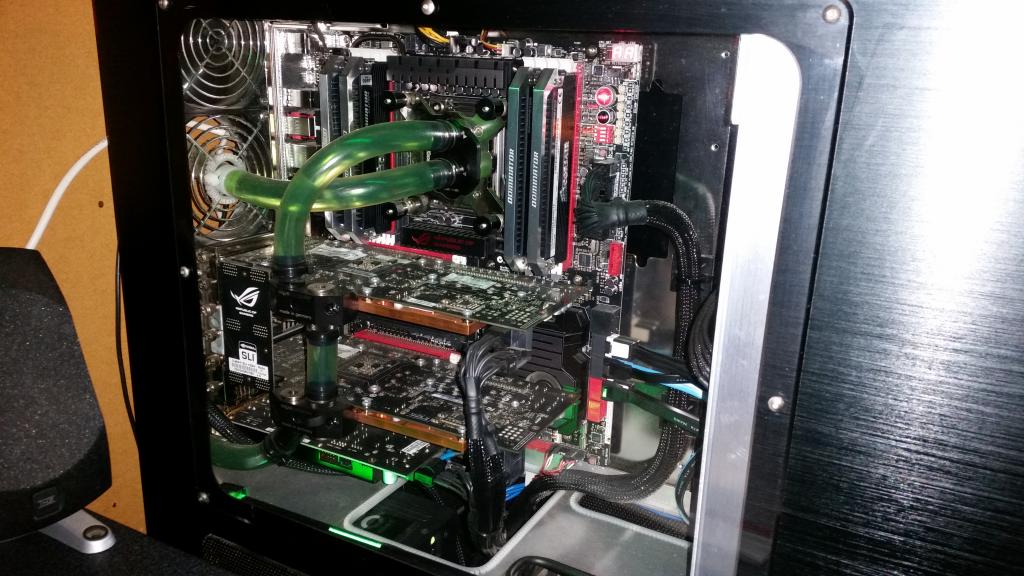

If you want gaming this is my gaming rig
no comparison in speed but rImac does ok for what it is.
If you run Valley fullscreen there is no way to check temperature precisely with istat. In the time needed to switch to istat and check temperature, even if you are very quick, gpu has cooled down a couple of degrees. Maybe running it windowed at full screen.
CMD+Tab works ;)
