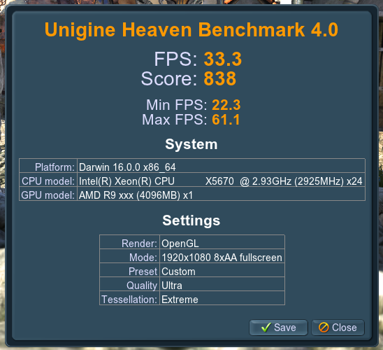

I bought an "XFX Radeon RX470 RS 4GB GDDR5 True OC 1226MHZ XXX Edition w/ Backplate HDMI/DVI/3XDP Graphic Card" from "ncix.com (Canada)" and installed it in my 3.33 6 core firmware upgraded 4,1. It works great. I'm getting very close to the same Unigine Heaven Benchmark results the orginal poster has.

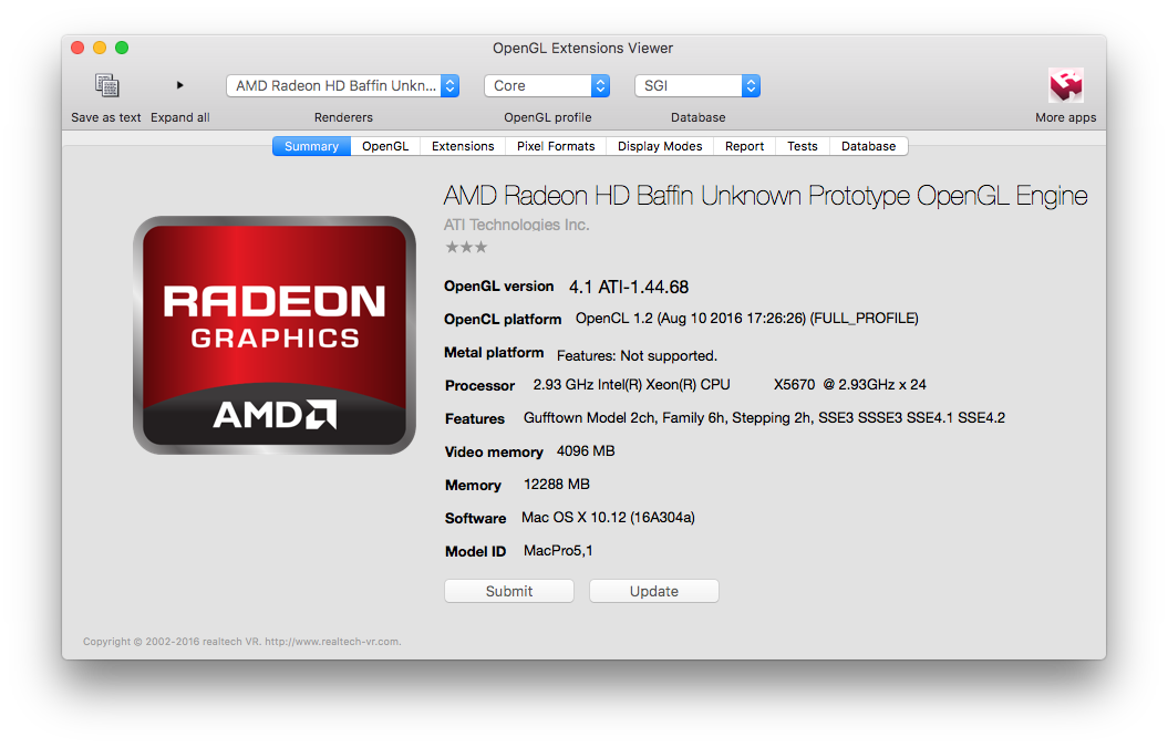

I installed GM today. RX 470 is fully functional after the kext mod. RX 480 still crashes in OpenGL. At this point, RX 470 is the better card to get for Mac Pro tower.

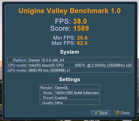

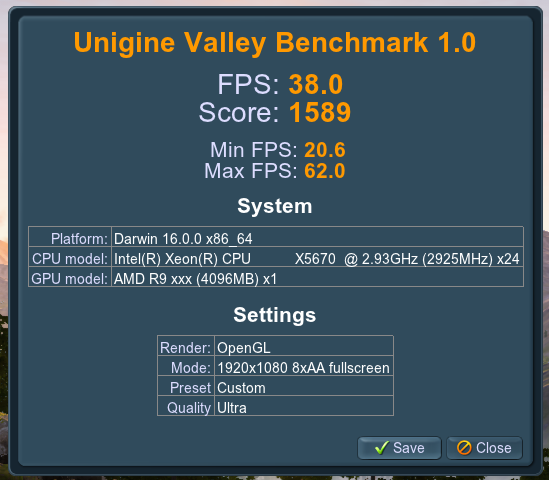

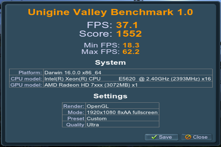

Got a great deal on an R9 280x last night off Craigslist. I ran benchmarks again in Sierra GM. Unflashed, RX 470 offers the same performance at half TDP.
I remember being able to run 2 x R9 280x was a big deal - lots of mods to make them work. With the RX 470, you can go to Best Buy/Mircro Center/Fry's, pick a pair off the shelves and that's all you need to do. 3 x RX 470s require a bit of work but that setup will beat GTX 1080 in certain tasks.
Reactions: killawat

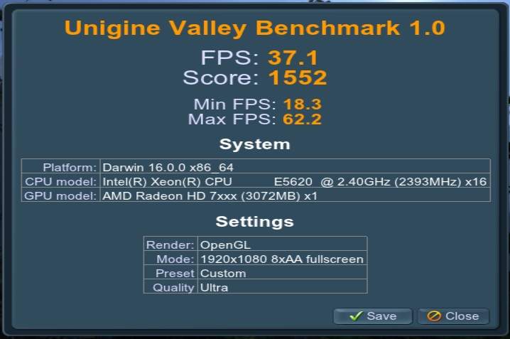

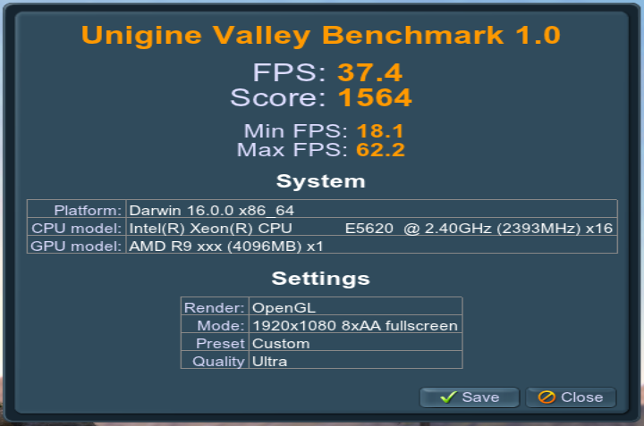

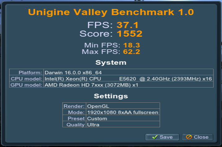

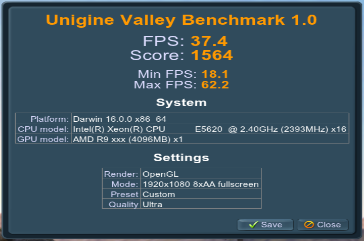

Identical performance between unflashed RX 470 and R9 280x.

Curious, the RX 470 @ 5 GT/sec has the same 3D performance as a 2.5 GT/sec R9 280x then? I'll wait until you test the resistor-removed R9 280x.
Of course it's a minor quibble since it's already hard to find 280xes and soon enough 470's will sell for even more decent prices, but it does matter to me a bit since I run BOINC tasks with my un-modded 280x.

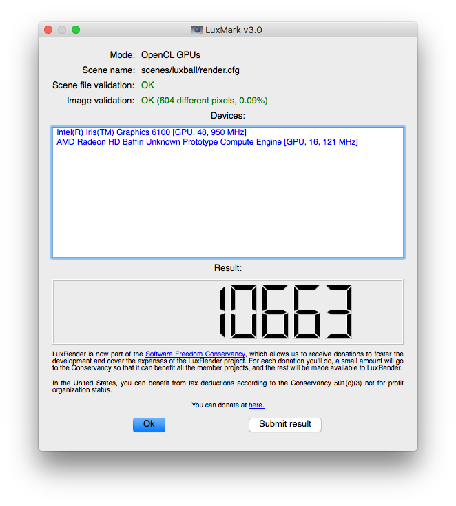

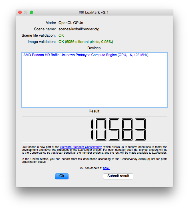

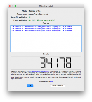

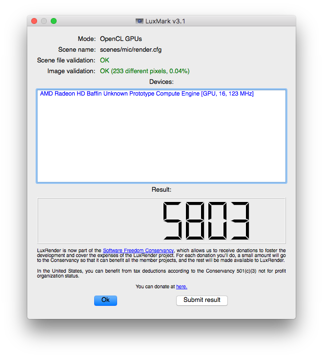

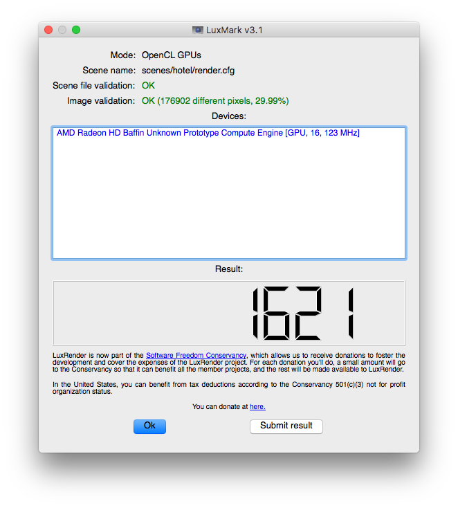

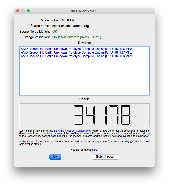

If you could run Luxmark 3.1 between all three cards in single fashion at some point, I'd appreciate it as the BOINC project I run supports OpenCL and currently I get better results with the 2.5 R9 280x than GTX 770's running full tilt with the web driver and CUDA.

Since the 470 have roughly the same performance as the R9 280X, so, I think we can safely assume that even the mod is avail, there should be around zero performance gain in real world. In other word, no need to bother this.

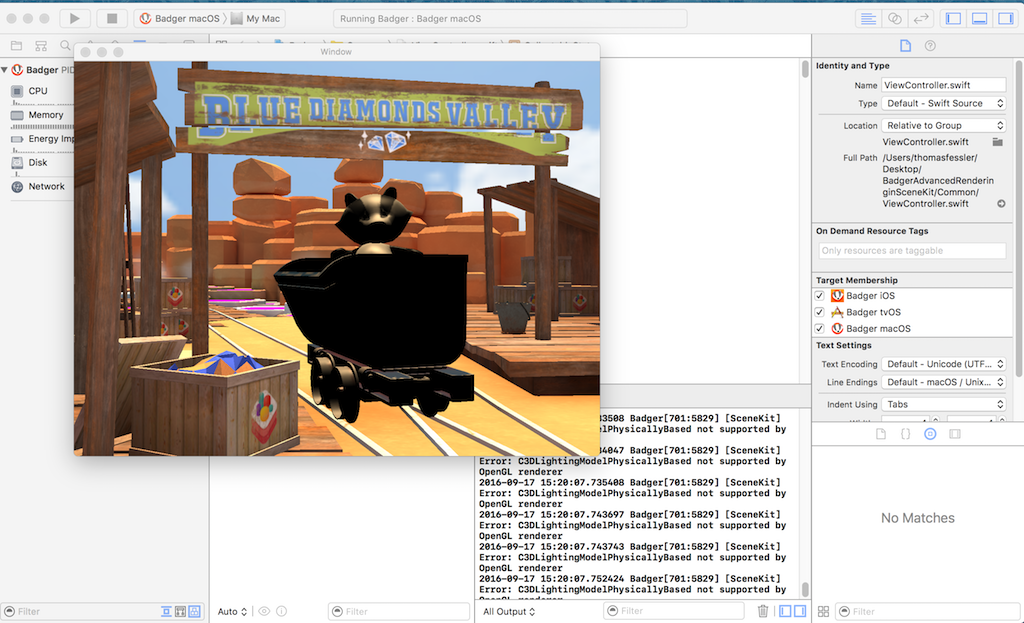

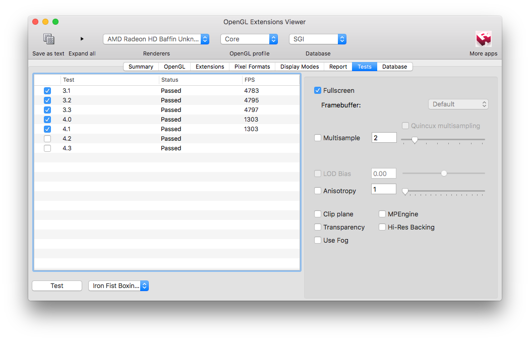

FWIW.. The "working" OpenGL surface on the 470 has issues with lighting and OpenGL effects. No rendering issues with a 7950. Lighting issues are illustrated below with failed lighting on the player in the center of the screen.
To be expected since the driver used is for a different version of the chip. The only drivers in macOS are for the 460.

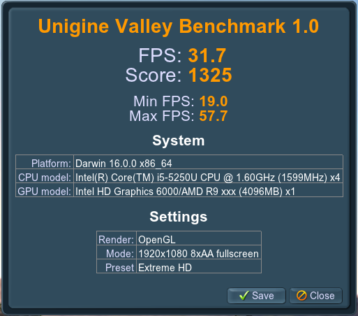

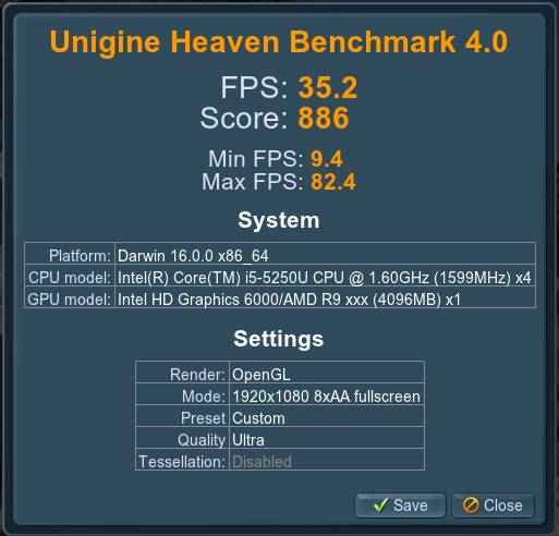

RX 470 runs slightly slower in an eGPU setup. I'm using a Dell DA-2 220W power brick with a Y splitter - barrel plug to AKiTiO board and 6-pin PCIe to GPU.
Screen Shot 2016-09-17 at 10.07.05 PM.png Screen Shot 2016-09-17 at 10.16.35 PM.png
