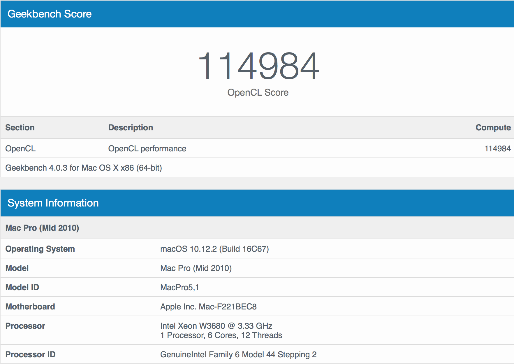

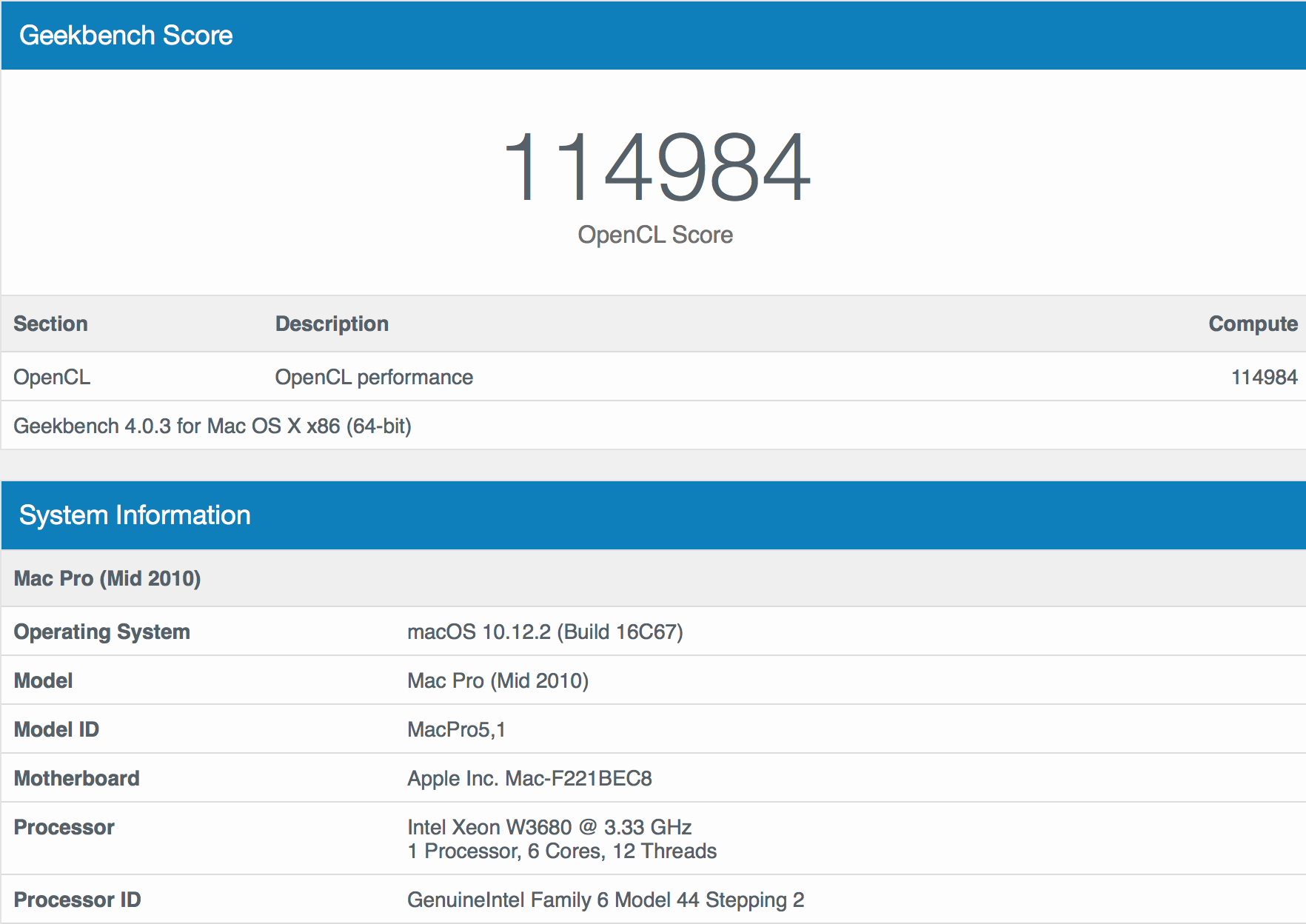

I just enabled some more CU's with a script i found in another thread (End of first post). It seems that the CU's are hard coded or something like that as my RX470 should have 32 CU's as far as i know and not 36 CU's.
Compute Score got better:
Geekbench:
up about 33% from before (Geekbench Open CL score with 16 CU's was 86189).

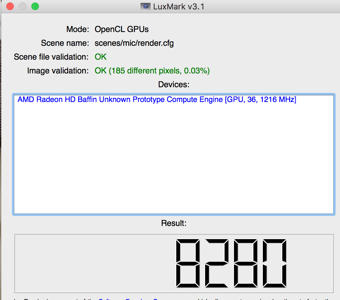

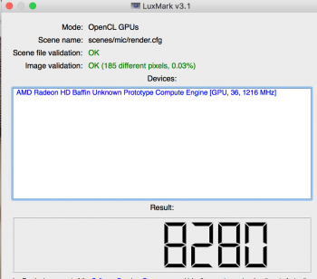

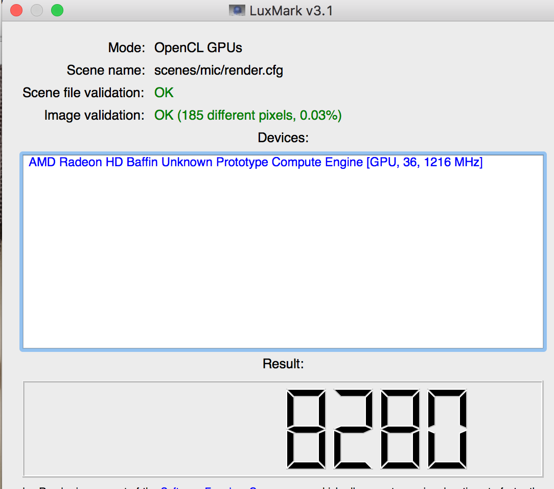

Luxmark:
I do not have the Luxmark score from before.
Open GL Score (Valley / Heaven) seems to be about the same as before.
Edit:

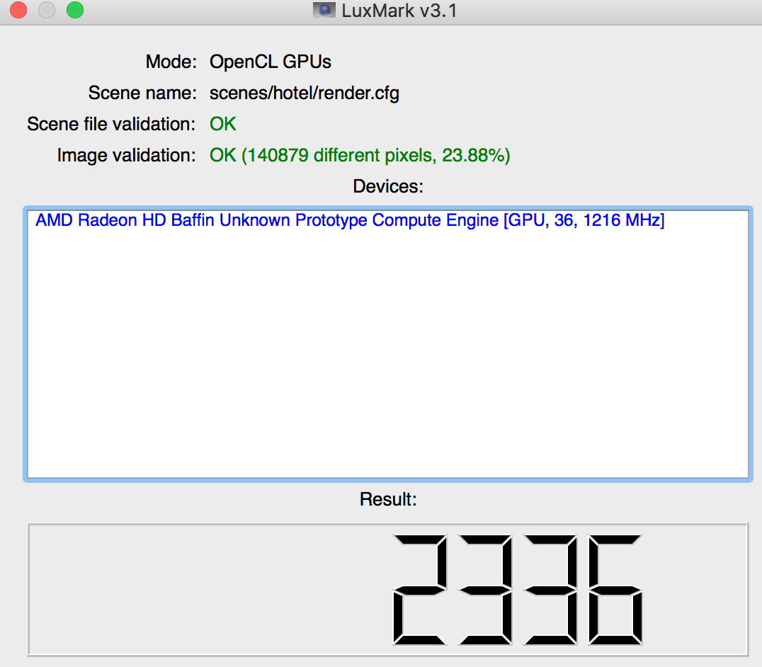

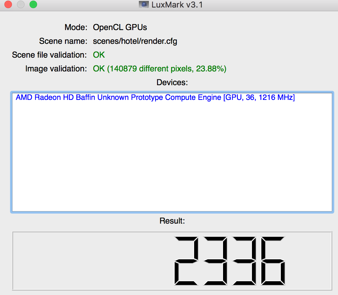

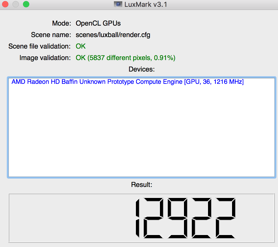

Did some more tests with Luxmark.
Hotel Scene:

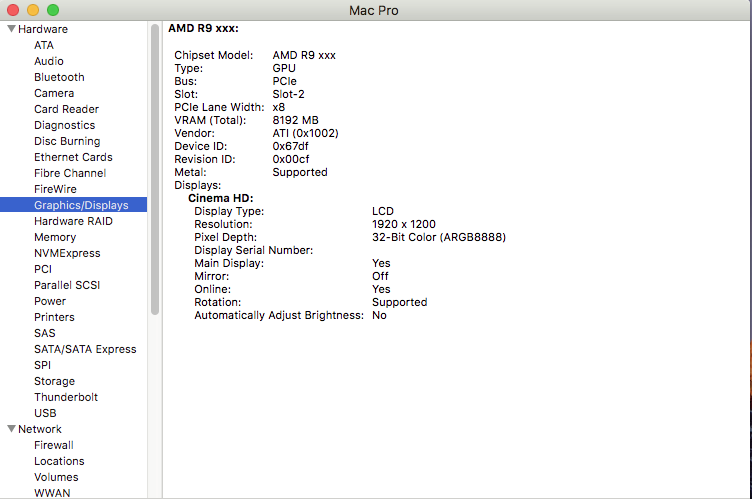

Nope nothing else plugged in and it's reading the same in 1 and 2. I know that when my 5770 was in it was being read as a 16x card so I think all that's ok. So now wondering if any of the pins are damaged or somesuch.

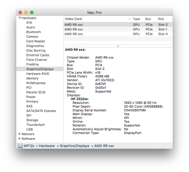

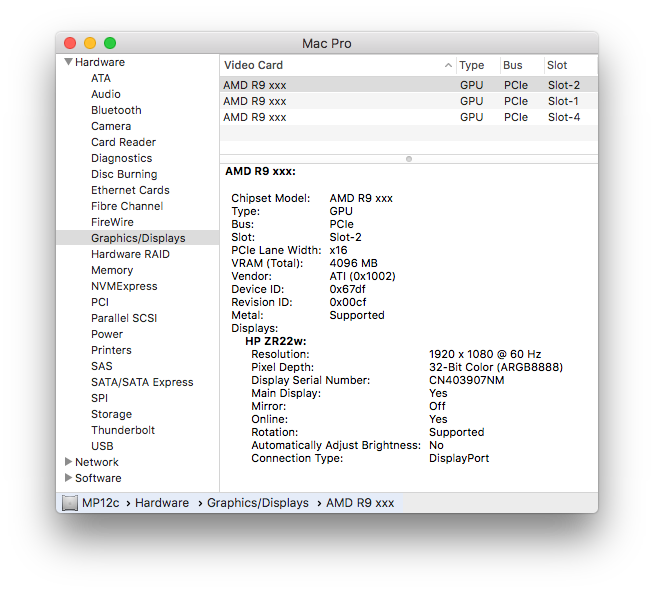

Can you post the screen shot of PCI section in System Information? I remember when I had 2 Polaris cards in my Mac Pro, one of the GPUs show 8x 5.0 Gt/s while the other one show 16x 2.5 Gt/s.
Unfortunately I just get the "There was an error while gathering PCI card info" message.
