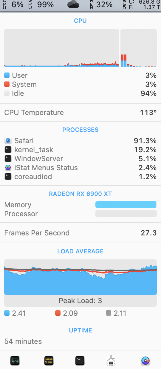

Also, do you guys see GPU memory taxing at 100% even at idle? Is this normal for non-Apple GPU? I don't recall seeing it like this with other cards (Mac Edition GTX1080, W5700X and Radeon 5870) I wonder why this is happening. I also have RTX3090 installed together.
Update: it looks like it's an unfixable issue by istats. https://bjango.com/help/istatmenus5/knownissues/

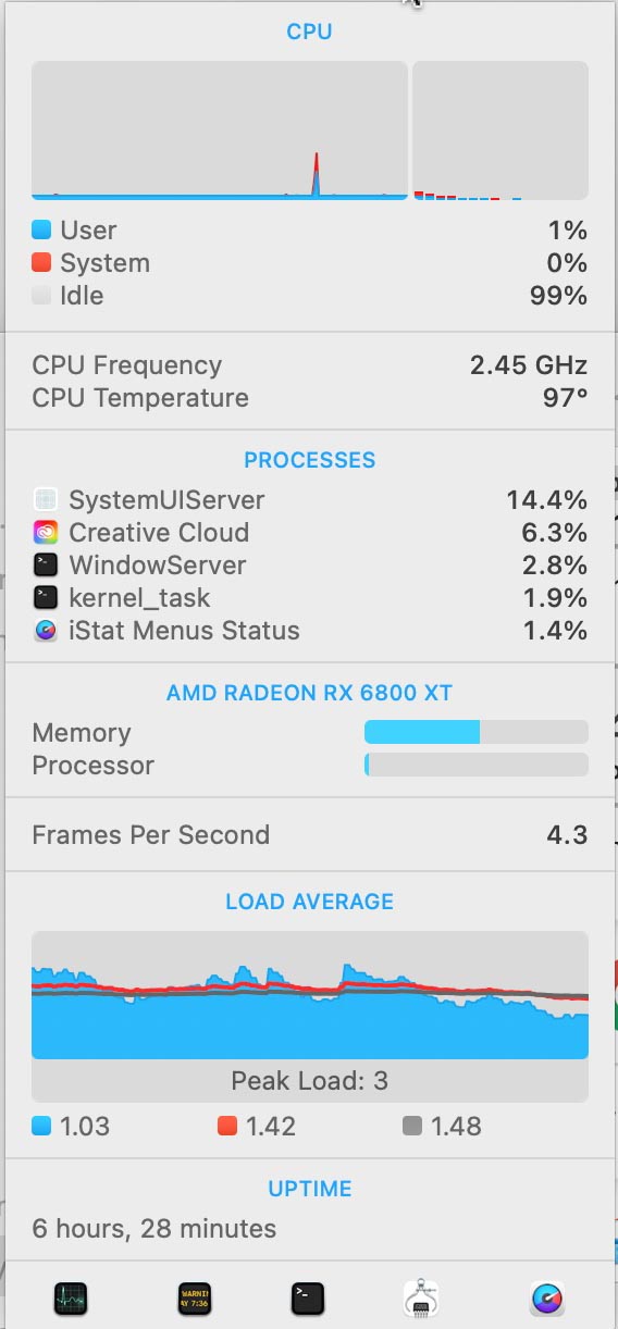

Again - Not the case for me:
BTW - I'm on V6.60
Use HiDPI resolution can greatly increase the VRAM consumption, I use 3840x1080 HiDPI, which can even saturate my Radeon VII’s 16GB VRAM.
If you are using any HiDPI resolution, you may temporary select that back to the normal x1 resolution (e.g. your monitor’s native resolution), and see if the VRAM usage still stay high.
If you believe that’s iStat issue, you can grab the VRAM usage from terminal.
BTW - I'm on V6.60
Lou
