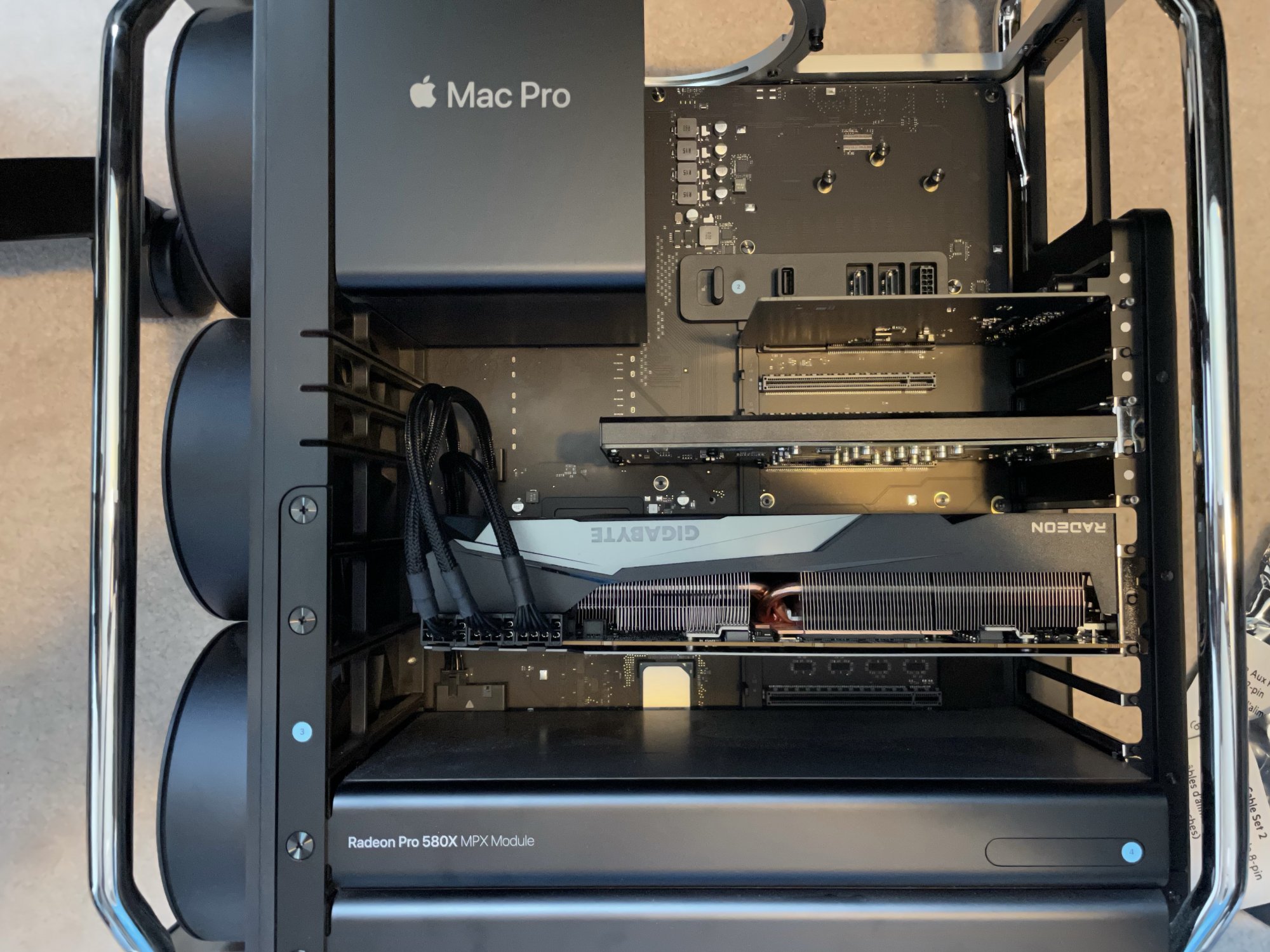

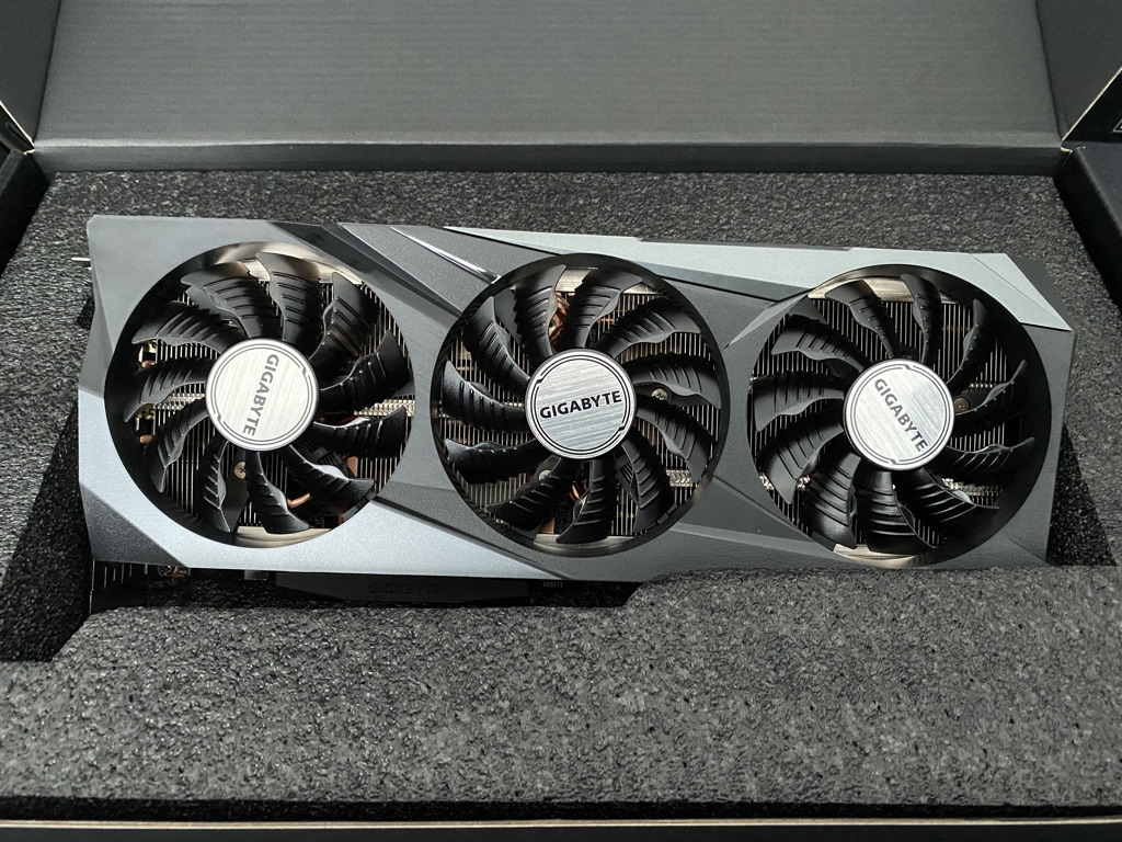

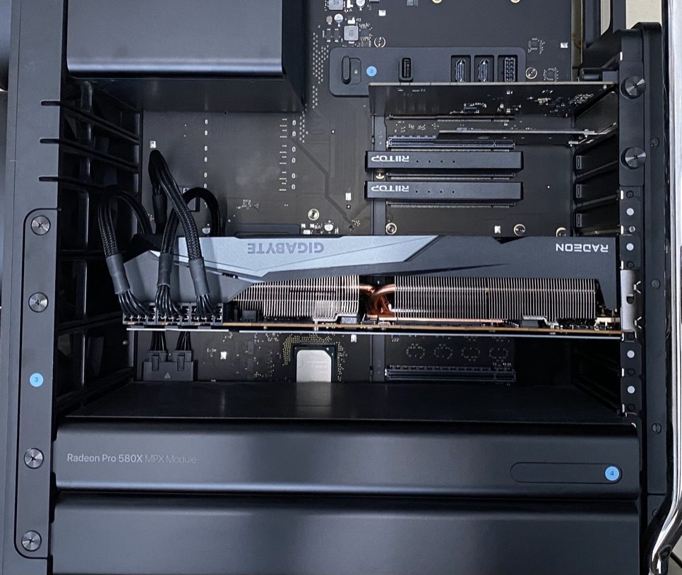

Just installed a Gigabyte RX6900XT OC 16 gig
Install went fine, no size issues, here's a couple of photos. No bench's yet and don't think I need to do them for you guys as there are many already.

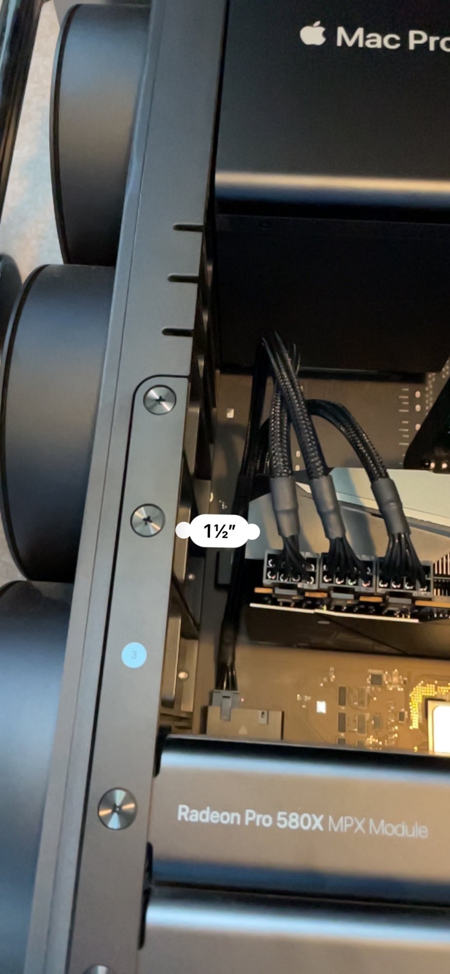

Used the iPhone 12 to measure the space so take it with a grain of salt.
Happy card hunting for those still looking.

Yes. Everything works as it should. You do need 2 four pin to four pin cables however. Some third party RX6900XT cards require 3 cables, but not the one you have pictured which is a reference card.
Note I am running a Gigabyte RX6800XT a non-reference card.

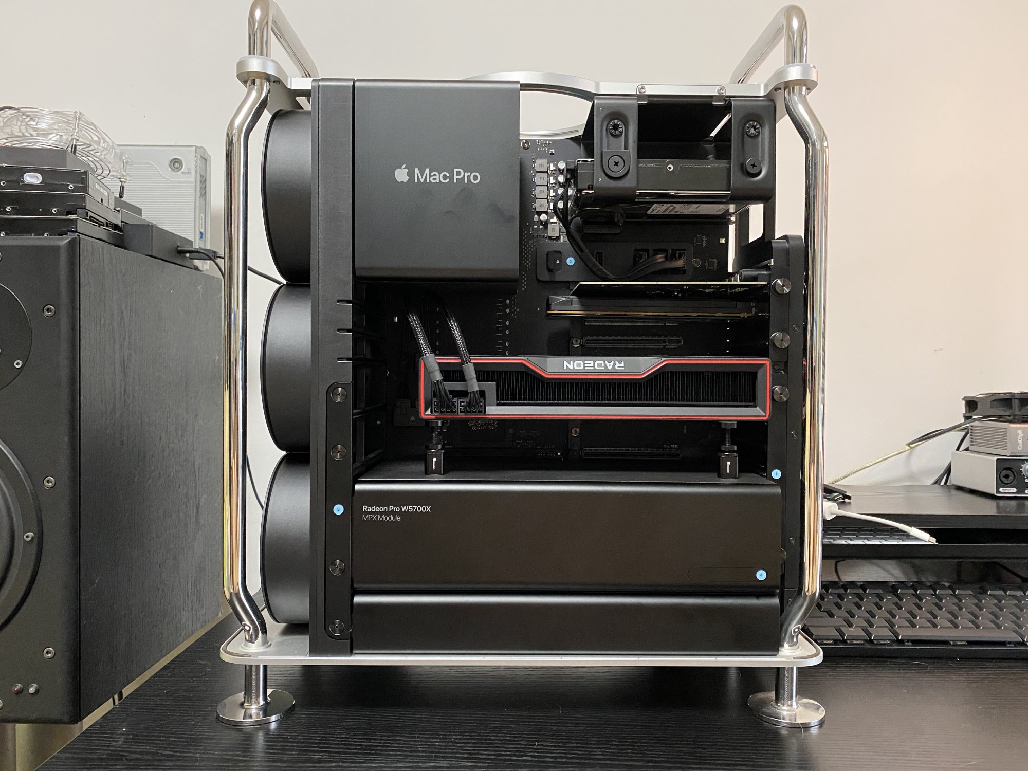

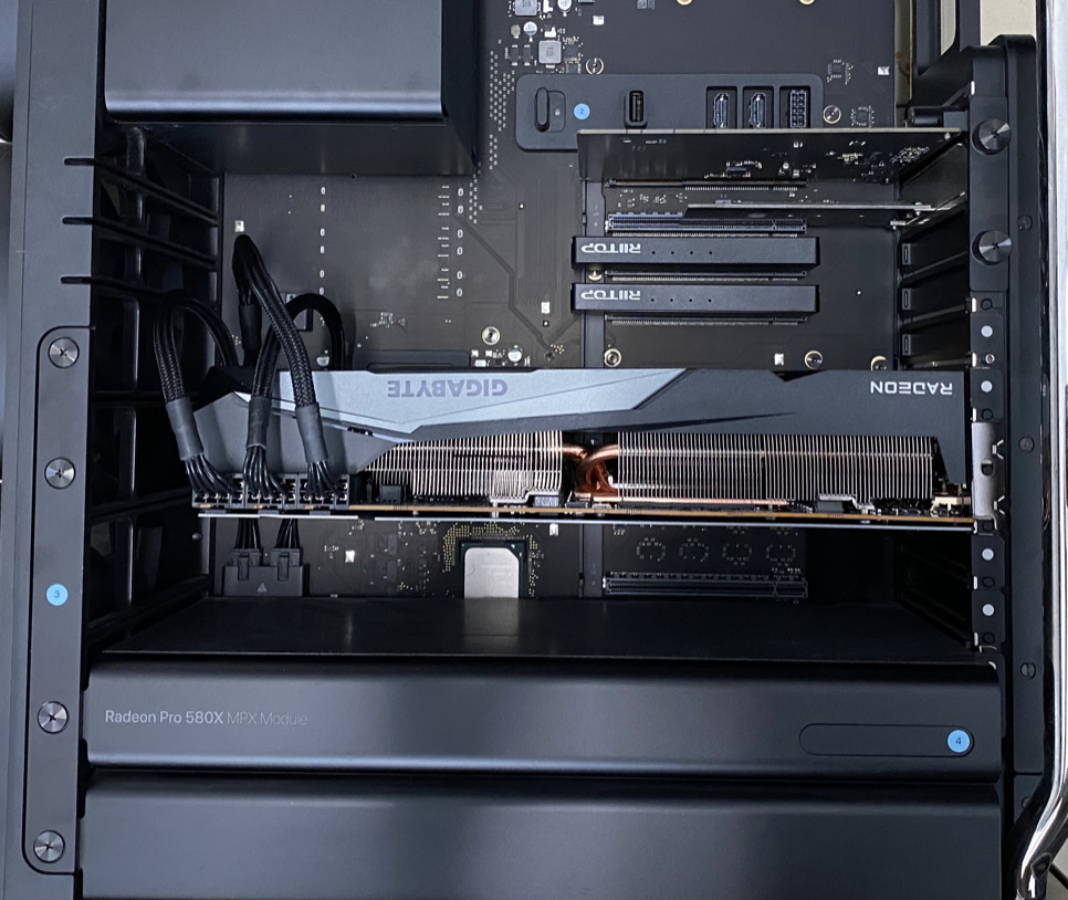

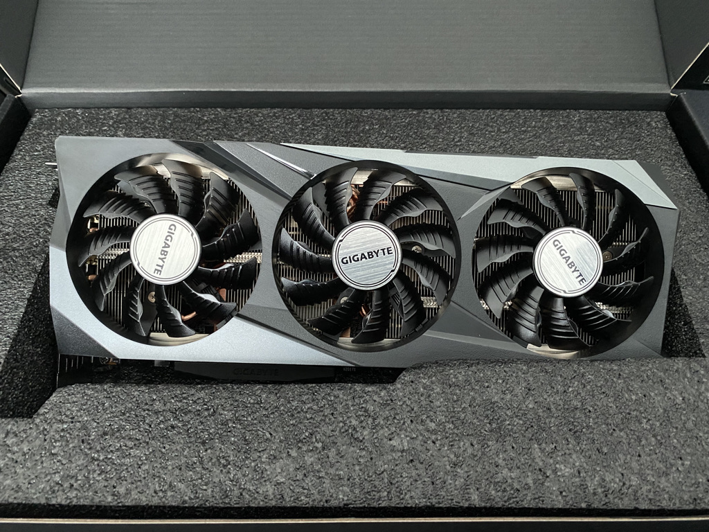

^^^^Go back and review Page 29 of this thread. Here's one of the posts from P29 that looks at sizes and the poster's Gigabyte RX6900XT cards:
Finally got a working card. I got an exchange for a Gigabyte RX 6900XT Gaming OC, which is 29cm so there's a bit of clearance, which I prefer vs the Sapphire which is just 31cm.
Below are my updated notes as to which card should work, some basic benchmarks and usage notes.
Card has to be <= 310mm to fit. 31cm is the absolute max, keep in mind graphic card manufacturer have no problem miss-labelling by a cm or two.
Benchmarks (all Geekbench 5.1.0 Metal):
Usage notes, with MPX 580X & 6900XT in the Mac Pro:
  • To use the 6900XT with an app that does not support GPU selection you need to plug the display cable directly in the GPU and run that app on the monitor. That can be done while the Mac Pro is running.
  • Apps that support gpu selection work seamlessly, just select the GPU you want to use.
  • It looks like there's a ~8% perf advantage if you plug the display cable directly in the RX6900XT. Not too sure why that applies to compute only usages, but GB5's benchmark shows a difference.
Fits (tested / seen working):
Should fit (but didn't see first hand):
  • Gigabyte Radeon RX 6800 XT & RX 6900 XT 16G: L=267 W=120 H=49 mm, should fit
  • ASRock RX 6800 Challenger Pro: 305x131x55mm, might just fit
Does not fit:
Pics of the Gigabyte RX6900XT Gaming OC in the Mac Pro:
