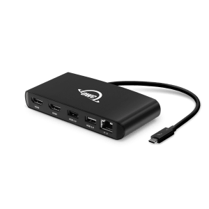

Actually OWC does make a Thunderbolt 3 > Dual DP adapter, but I am not sure it will work in the opposite direction. But I do know it is capable of doing 2x 3840x2160 @ 59.94Hz outputs; and I have hooked 2 adapters to 1 iMacPro before and had 4x 4k outputs at 59.94hz; being driven by Millumin.
A Thunderbolt 3 to Dual DisplayPort adapter is just a cut-down bus-powered Thunderbolt dock. You can't do DisplayPort input to a Thunderbolt dock so you can't do DisplayPort input to this adapter. Thunderbolt docks do not expose the DisplayPort inputs of their Thunderbolt controller. Only the Blackmagic eGPUs and Sonnet eGPU Puck 5500 XT / 5700 have ever used the DisplayPort inputs of a Thunderbolt controller (outside the Thunderbolt controllers of Macs).

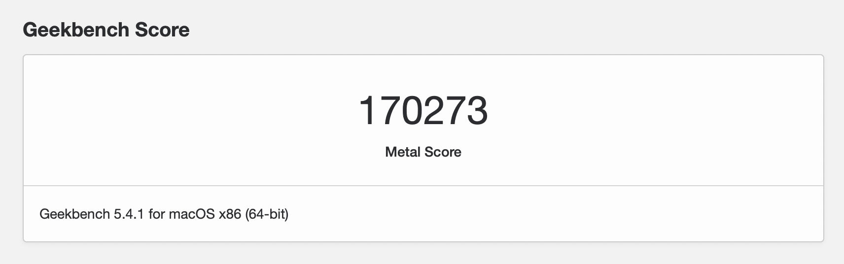

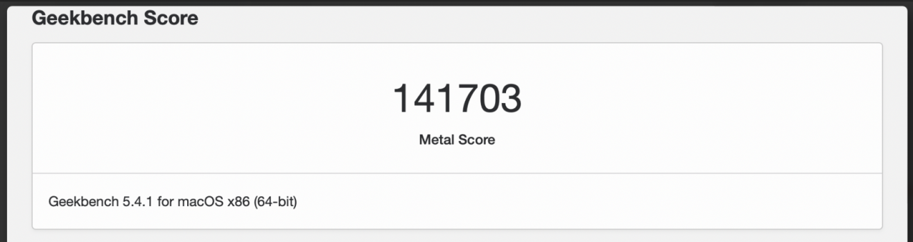

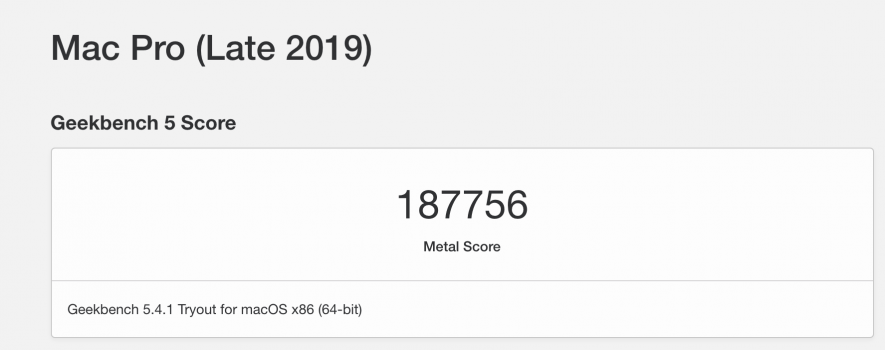

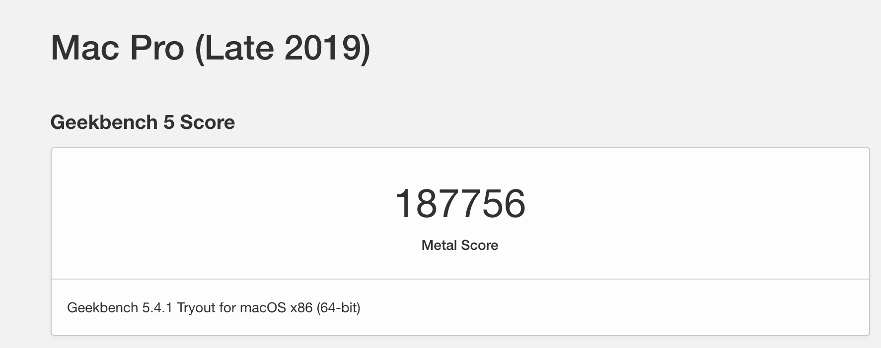

Well, I did something sorta stupid 1387914497.gif I just replaced my Reference RX6800 with a Gigabyte RX6800XT13879dunno.gif
Checked Metal scores:
My RX6800
My RX6800XT
RX6900XT (from another post)
BTW - My Reference RX6800 is now for sale. Check the MarketPlace if interested.
Lou
