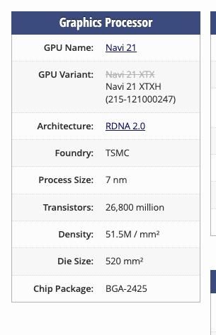

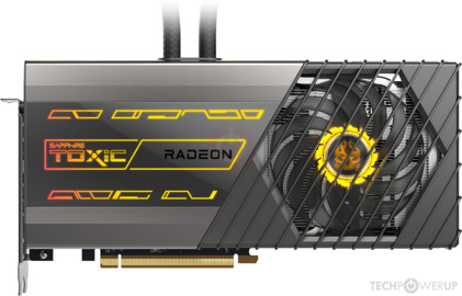

TOXIC AMD Radeon™️M RX 6900 XT Extreme Edition. What is the likelihood that this card will be compatible with the Mac Pro 2019?"
There are two very different things at play here.
First is if the device-id of the GPU is supported by Apple drivers, only 73BF is supported:
Navi 21:
  • 6900 XT device-id 73BF = supported,
  • 6900 XTH device-id 73AF = not supported,
  • 6950 XT device-id 73A5 = not supported,
Second is if the card can be fitted and powered by the Mac Pro.
Before buying anything, check both. If you buy a 6900 XTH or a 6950 XT, you'll need to re-flash it with a compatible 6900 XT firmware or spoof the device-id via OpenCore.

It turns out that you can't hold on?

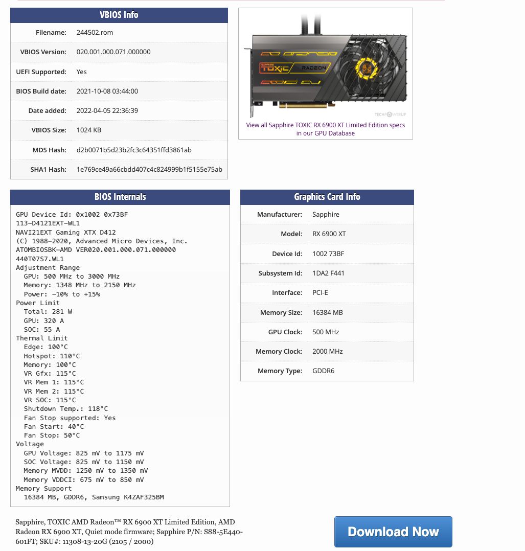

Is there a firmware file, and what is the likelihood of installing everything without issues?"
Obviously you have to do your homework and find a GPU firmware that work with your card, have the same memory and etc. No one can do it for you.
If you flash an incorrect GPU firmware, you could brick the card until you re-flash with a correct one.
Most likely you'll need to test several firmware files until you find the correct one. So, you'll brick the card sometimes until you get it right, be prepared.
Read about from people that did it, this is not news here and on the thread below:
Reactions: Romandini
There are good questions, for example, not extra. But specifically, the limited edition as shown in the screenshot has 73BF, so it should be quite suitable, right?"

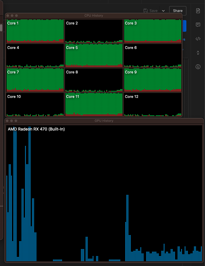

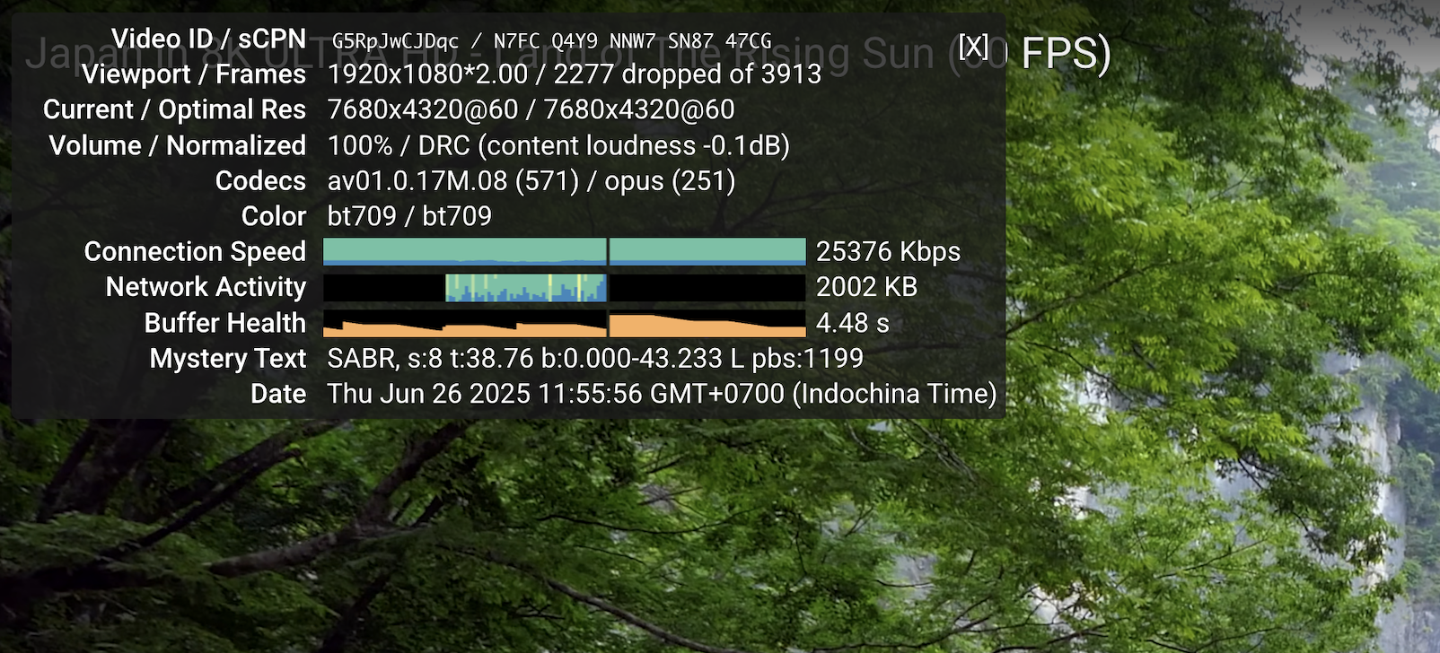

Do you have a test file?

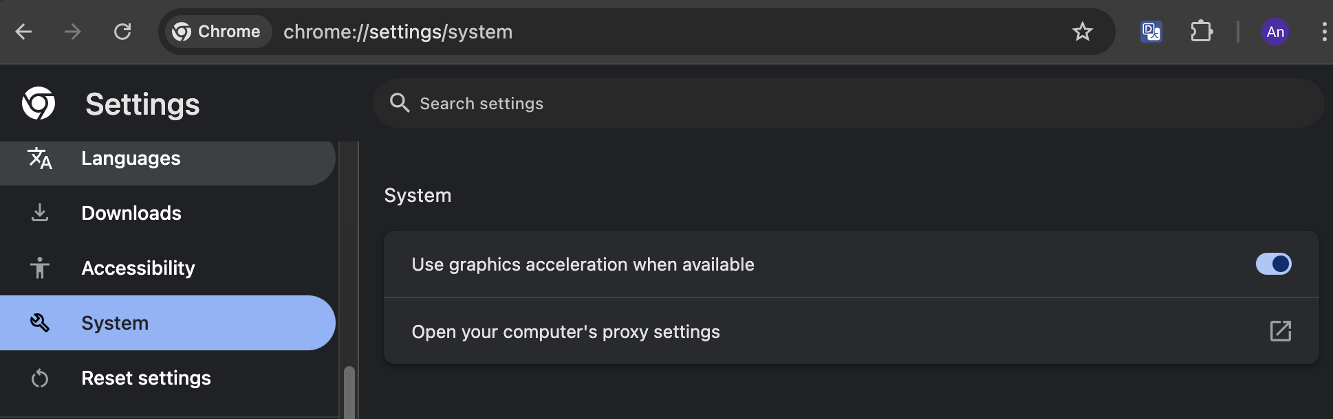

Hi @startergo , could you help test it like this?
  1. Play a YouTube video in 8K resolution (Use Google Chrome with graphics acceleration enabled in settings)
  2. Open Activity Monitor, then in the menu bar, go to Window > CPU History and GPU History.
  3. If you see very high CPU usage, like in the screenshot I attached, it likely means the system is doing software decoding (CPU-based).
  4. If CPU usage stays low and GPU activity increases, then it’s using hardware decoding (GPU-based AV1 decoding).
This would help confirm if AV1 hardware decoding works with RDNA2 on macOS. Thanks a lot!
  1. Play a YouTube video in 8K resolution — for example:
FWIW in RDNA1 / Radeon Pro W5700X tried this out to see for myself, and for a start, it won't let me go above 4k in the browser. Safari media encoding or similarly named is ~140%, the GPU's may as well be inert carbon rods for all the work they're claiming to do.
Reactions: kobietci
AV1 Hardware decoding does not work in Chrome on macOS. From what I can see even in Windows 8K is an issue:
Thanks a lot for testing it, I agree — 8K is an issue. I only chose an 8K video because it's easier to clearly observe very high CPU usage if the system is doing software decoding. That makes it easier to distinguish between software and hardware decoding behavior.
