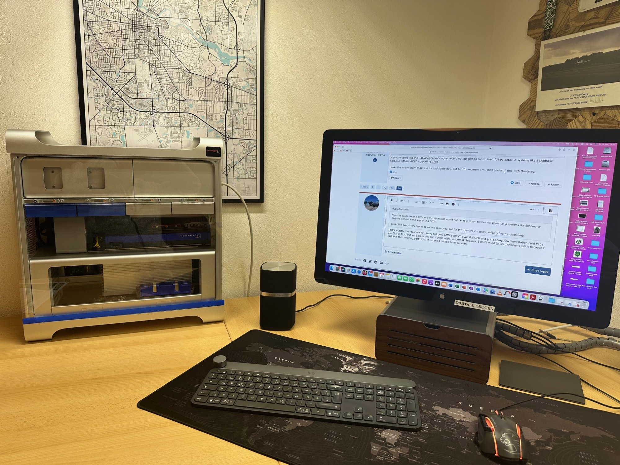

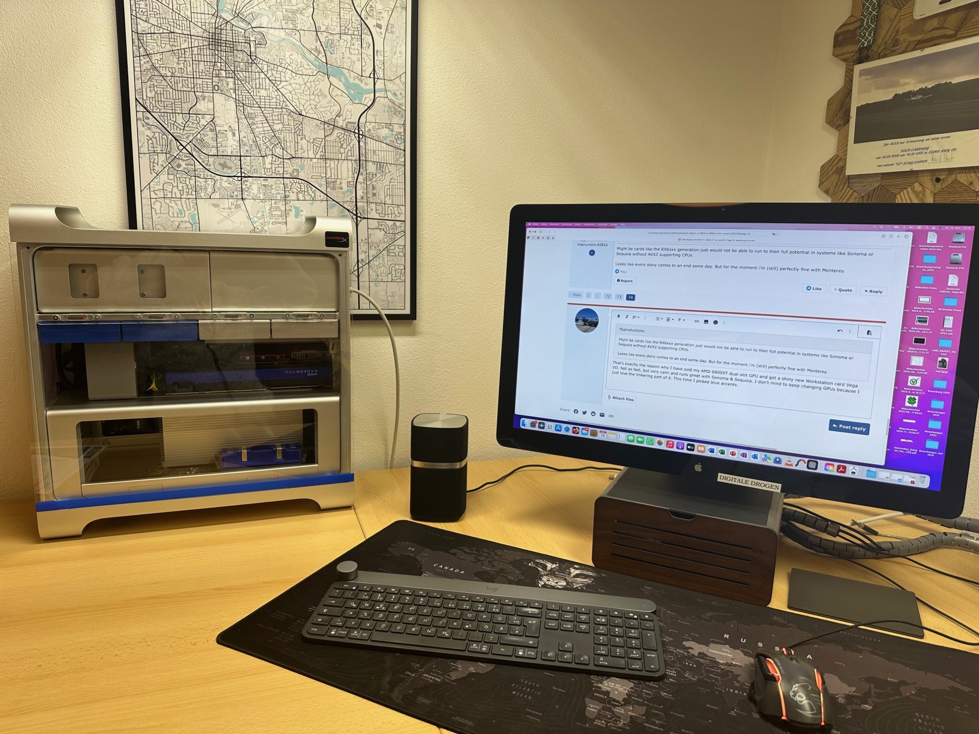

The danger here is if Apple should take the same route with other types of cards as they did with RX6x000 drivers. It would very much limit the continued use of the CMP by forcing everyone back to Monterey or earlier.
Might be cards like the RX6xxx generation just would not be able to run to their full potential in systems like Sonoma or Sequoia without AVX2 supporting CPUs.
Looks like every story comes to an end some day. But for the moment i'm (still) perfectly fine with Monterey.
