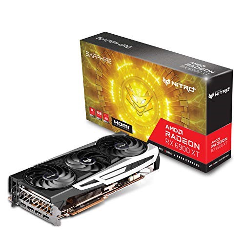

An update on my list above.
It seems that the Sapphire Nitro+ AMD Radeon RX 6800 XT (NON Special Edition) just barely fits
. Dimension (as per manufacturer's website): 310(L)X 134.3(W)X 55.3 (H)mm. So 310mm might be the limit, but... the margin is so small I dont think I would risk it with any other model, its difficult to know what a manufacturer uses as a measurement reference.
CORRECTION: It is the non special edition in the video, which does fit. The Special Edition DOES NOT fit as it is actually 320mm even though the website indicates 310mm.

That's not true. You linked my own video and in this video I used the Special Edition version. And it fits absolutely EXACTLY = no mm left = fits perfectly like and MPX module

Is it possible that the Sapphire 6800xt SE is shorter than the Sapphire 6900XT SE? From what I am seeing on this forum, the people that bought an SE 6900XT couldn't get it to fit, but Margonaut didn't have any problem with the 6800XT.

I never trust to anybody, people say lot of crap on internet. I only trust to my own testing and I recommend only components I personally tested and verified. So when I say in my video that Sapphire Nitro+ RX 6800 XT Special Edition fits perfectly to 2010 Mac Pro, then it's true. It's even clearly visible in my video.

This says - The Same:

I'm hoping if I could hear from people who have Sapphire cards installed. It seems there are conflicting experiences installing Sapphire branded cards, even though 6800xt and 6900xt Nitro+ lines come with the same dimensions specified by the manufacturer.
So how was your experience installing it? Was it too close/tight in lengthwise? Were brackets(clamps) on the either side hard to put it back on?
I'm being optimistically cautious here, since my own experience with Asus' Vega 64 card; brackets wouldn't close.
edit: I was able to find a post on a different website measuring Nitro+ 6900 xt SE to be 320mm.

Do you think I used saw to cut my 6800 XT SE down to fit?? No, as I showed in my video it fits perfectly.
The Sapphire manufacturer published the wrong size for the 6900xt SE, and the naming is very similar so its very confusing...
