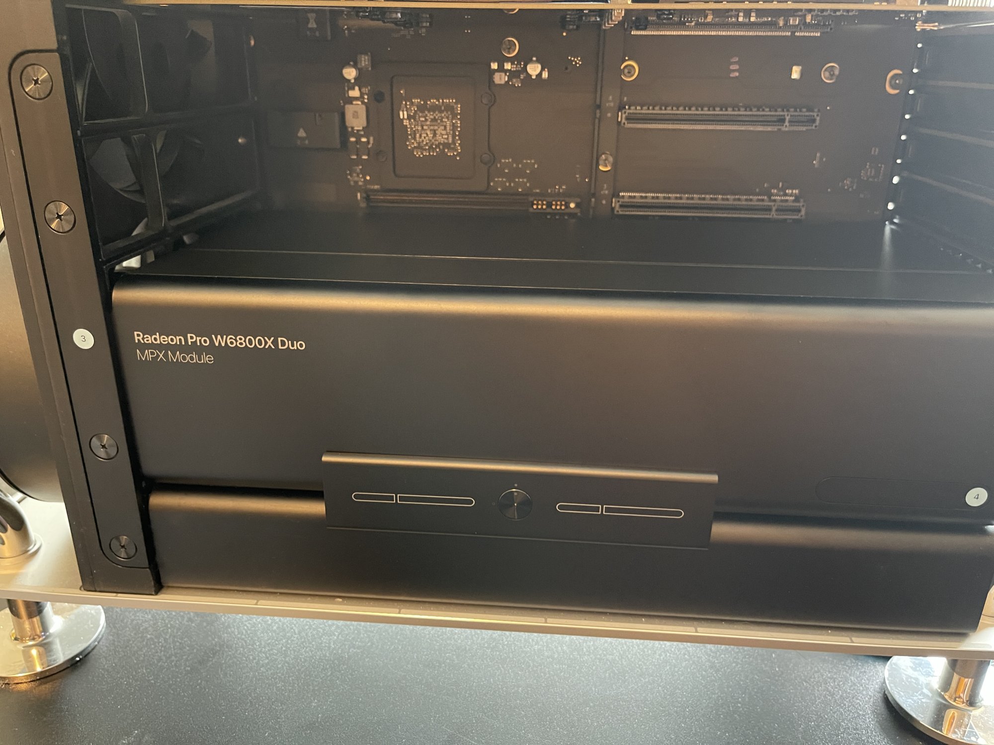

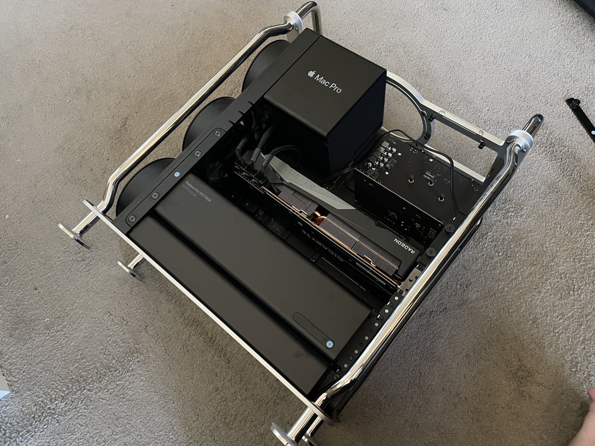

Has anyone bought or considered the w6900x? Curious if so.
‘’I went for the w6800x duo - seems just better priced for the performance. If 4 gpus work in FCP, two duos, will be interesting. If not, then 2 w6900x will still be fastest.
Mines arriving tomorrow
