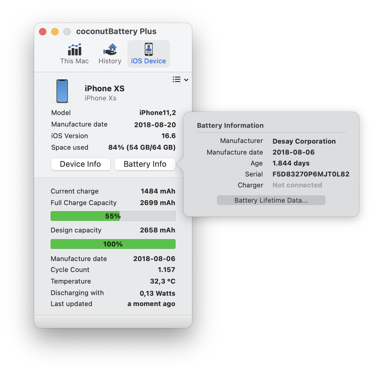

Hi guys,
I want to show you that it is indeed possible that the battery can last much more than the 500 cycles, which are specified by Apple. I bought my iPhone Xs on September 2018 and it has the first battery up to this day. On the attached screenshot of the Mac app "coconutBattery" you can see the cycle count up to this point, and also the remaining capacity, which is still above 100%.
I achieved this by only using the battery between roughly 70% - 30% SoC and taking care of good battery operating conditions in general. For me with the help of shortcuts, that remind me of keeping it charged or end the charging, it is really easy to keep the battery in this range. But I won't recommend it for somebody else😅

Absolutely amazing. Shows how much of an effect using a lower state of charge affects battery health especially years down the road vs using 100% SoC.

I’d be inclined to say that it’s one of those cases in which they program the battery to always read 100% (I don’t know if that affects Coconut too though), but since it is the original battery, that’s impressive.
Still extremely convoluted for absolutely negative gain, because I am seeing that the device is on iOS 16, so you already lost runtime (which you wouldn’t have regardless of health if the device were on iOS 12), but an interesting exercise nevertheless.
I didn’t think it was possible. If I had to hazard a guess, I’d say above 90% is definitely possible, maybe even above 95%, but I didn’t think it could still be above design capacity with more than 1100 cycles. An exercise in futility due to the iOS version, but like I said, interesting regardless.
Edit: I remembered that was somebody with an iPhone 6+ on iOS 9 with a similar number, I think he had like 1900 cycles and 96% health with a similar approach, so I knew something like that was possible, but yeah, above 100% is still impressive.

I have to admit though that the battery health provided by Apple in the settings says that the battery has only 90% SoH. I think this settings SoH is something that the battery can deliver under load, and the coconutBattery health can be rather the max capacity, that you can get out with the smallest load attached to the battery. The difference can be that the internal resistance of the battery has risen and therefore the more power the battery has to deliver, the less capacity can be supplied.
BUT I don't trust the battery health provided in the settings BECAUSE it has shifted straight from 100% to 96% exactly at 350 charge cycles. And a similar jump happened at exactly 1000 cycles. So maybe this value would only be updated on certain charge cycle numbers OR this value is calculated by a physical model and not measured in any way. So I'm not sure about this and only looking on coconutBattery.
This seems to mirror behavior other users have who go from 100% health for long periods of time and then drop like a brick after days/weeks.
I always knew that batteries were not an exact science because of their chemistry but ... seems like something funky is going on with Apple's BMS ...
Wait, settings shows 90%? I’m inclined to believe that then. It sounds a lot more reasonable. 90% after more than 1100 cycles is impressive, but far more realistic, matching the battery capacity of other users with similar approaches. That makes a LOT more sense.
