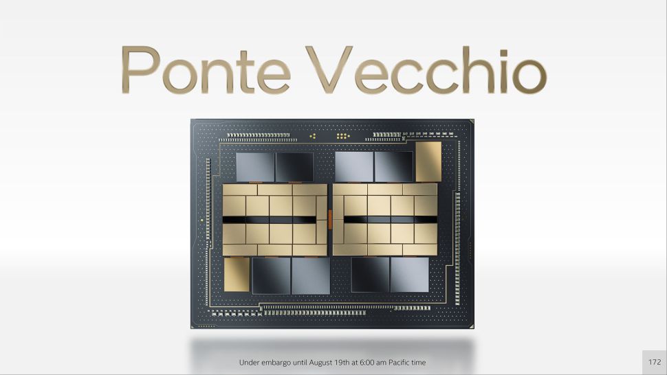

You are certainly right on this regard. M1 Max's size is already really extreme on N5P; an 16+64 SOC as predicted for the iMac will easily exceed the reticle limit for the manufacturing process and simply be unfeasible.
However, there is currently no clear evidence regarding the existence of high-speed intra-chip connections on the M1 Pro/Max, which is crucial for a multi-processor heterogeneous computer designed The Apple Way. Simply put, it looks like M1 Max can't be easily packaged by two or four to form a bigger chip just yet.
So my prediction would be some large package with CPU&GPU chiplets the AMD Ryzen way. But this makes designing the memory subsystem really difficult, itself being a big selling point of the M1 family architecture. 4 cpu chipsets with 10 cores each and 4 GPU chips with 32 cores each to form a 40+128 config, with memory/IO crammed into another chiplet with 2048 bit LPDDR5??? This would be a nightmare to design with all the cachelines and packaging technologies.
Ahh, sure, there is the Magical, twice-delayed Intel Ponte Vecchio...
https://www.tomshardware.com/features/intel-ponte-vecchio-and-xe-hpc-architecture-built-for-big-data
But is it just me who thinks M1's design topology is too exotic and expensive to scale beyond M1 Max? Like, craaaazy cool for a super low volume halo Mac product but way too expensive to not go into a multi-billion dollar super computer cluster...
