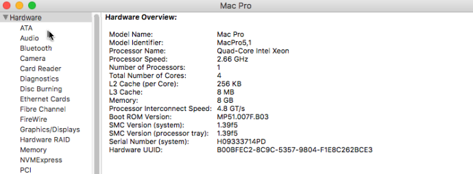

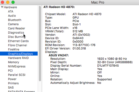

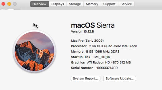

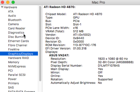

Thanks you and I do appreciate your patience,
1). Yes I did the firmware update and it seems to be successful. It now says 5.1 and the boot rom is MP51.007F.B03
2). I can get it to boot up in 10.12 and everything seems to be working. The issue is when I go to restart (Apple menu - Restart) it will not. That is when I get the flashing power light.
3). Not sure if there is any specific scenario it just flashes on-off with fans on ( but I do not think they are on hight)
4). Yes, when I get the flashing power light I can then force shutdown and it will boot to the desktop.
5). See attached
I have read that the video card could cause issues but I can't find anything on the card I have so not sure if that could be the issue.
Thanks again for your help.
5). See attached

Ok, now is much more clear. It’s nothing to do with the firmware, and you only have one problem, which is you can’t perform a warm restart.
For every warm restart, it’s basically “shutdown -> POST (the “don” sound) -> boot to desktop again”. Does your computer hang before or after POST?

[doublepost=1508790234][/doublepost]And regardless of what I start from 10.12 SSD 10.12 USB or 10.11 HD it will not do a warm restart.
[doublepost=1508790536][/doublepost]Would a NVIDIA GeForce 7300 GT be a card I could use?

Sure, okay, sorry. On instructions from tsialex, who has been wonderfully patient and helpful, via email, I got a new flash drive (the one I'd been working with was bad), and turned it into an El Capitan boot drive. One of his instructions included: "Do a BootROM dump using ROMTool, attached here. You need SIP disabled and no AV/anti-malware running. ROMTool is usually a false-positive to every AV/anti-malware because flashrom and DirectHWAcess.kext." So I disabled SIP, tried to run the RomTool, it asked for a password which I assumed I didn't have after trying the administrator password, and thought running the 2009-2010 firmware update, since I'd finally been able to disable SIP, would work.
This is exactly what tsialex was trying to prevent. He wanted me to send him the results of the BootRom dump so he could help me. So, after running the firmware update, shutting down the Mac Pro and starting it by pressing the power button until it flashed and beeped, my display showed a different apple-and-status bar than I'd seen before (thicker, and sort of white with darker edges), and then turned off.
I expected, finally, to start it and be able to see the 5,1 in the "about this Mac" screen, but it just wouldn't boot as the ROM chip on the backplane no longer works due to my ineptitude. Doesn't matter if I have the hard drives out and try to boot from the flash drive, the ROM chip in the backplane has the wrong information on it and that's a hardware issue--as I understand it. After explaining what happened, and asking for clarity, as I know very little, he wrote:
