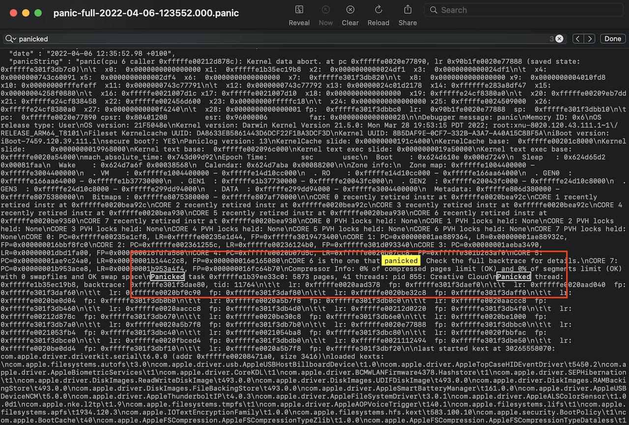

Did you try looking in the panic log for panicked or panic as my screen shot?

I always have a lot of trouble finding anything useful in Console, and my screenshot was by going direct to the panic log file which I think (can't check at mo) is in /Library/Logs/DiagnosticReports or possibly /Library/Logs/DiagnosticReports/Recent/

BINGO.
In Logs/dignosticreports I found a text document named 'panic-base-2022-07-16-093626.panic' with the timestamp 09.36.26 which corresponds to my last crash:
{"bug_type":"210","timestamp":"2022-07-16 09:36:26.00 +0200","os_version":"macOS 11.6.3 (20G415)","incident_id":"129E4CF9-4AA4-4AF9-80A8-D54BE1EB43A7"}
"build" : "macOS 11.6.3 (20G415)",
"product" : "Macmini9,1",
"kernel" : "Darwin Kernel Version 20.6.0: Wed Jan 12 22:22:45 PST 2022; root:xnu-7195.141.19~2\/RELEASE_ARM64_T8101",
"incident" : "129E4CF9-4AA4-4AF9-80A8-D54BE1EB43A7",
"crashReporterKey" : "C33BDB64-F198-9E32-0A84-F52BCA8DD664",
"date" : "2022-07-16 09:36:26.28 +0200",
"panicString" : "Unexpected SoC (system) watchdog reset occurred",
"panicFlags" : "0x0",
"foregroundAppHash" : "0",
"binaryImages" : []
I guess this is like the 'clue'…
Can you make anything out of it?

Afraid I can't suggest anything from "Watchdog" which I think is an Apple not a third party process.
Did you see anything like the block of fine text in my screenshot?

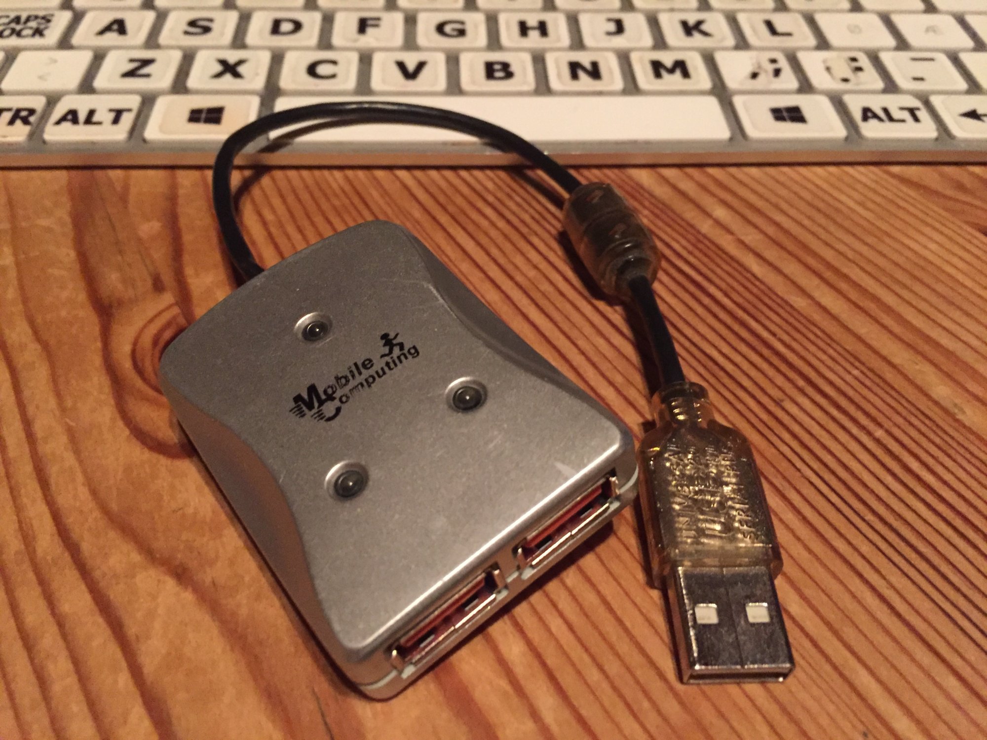

I'm 99% convinced that my problem came from using a very old USB-1.0 "splitter" in my USB-3 port. Anyone with this problem should check it. Report back if you can confirm.

Over ten days, and no return of the crash/restart problems.
I'm confident now, that this old USB 'splitter' was the cause of my problems. They started after I started using it, and went away after I unplugged it:
Lesson: If you suddenly start getting problems like people have described here, check your (possibly) old peripherals, and certainly ones added recently. IHTH.
