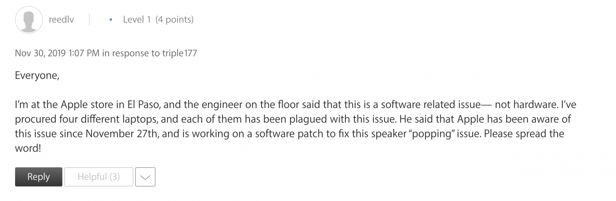

From here https://discussions.apple.com/thread/250867287 but be sure to fill out the complaint form: https://www.apple.com/feedback/macbookpro.html
