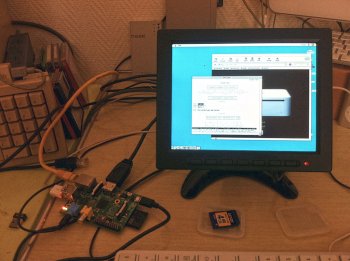

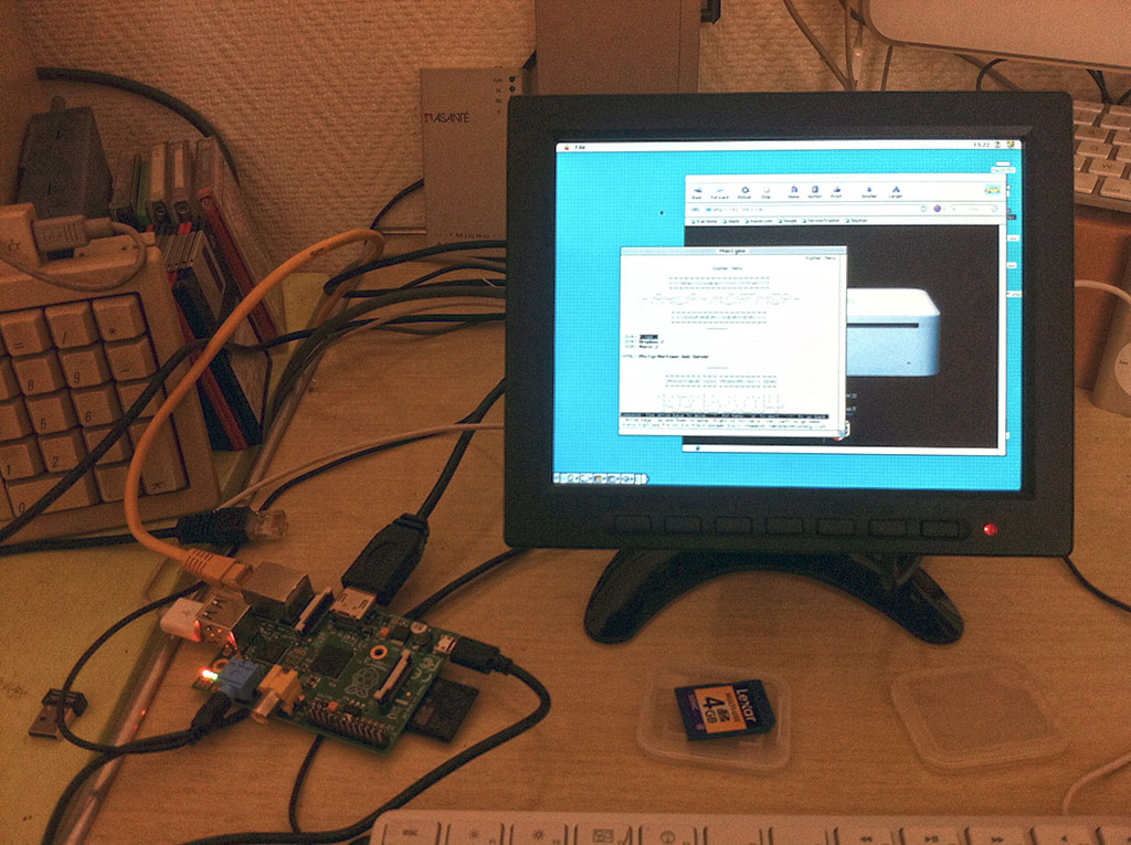

hardware wise, The R-Pi 3 is connected to a 8" lcd , can’t find the exact same model I bought some years ago, but something like these should do :
https://www.ebay.fr/itm/8-inch-LCD-...876505?hash=item2ce6458419:g:zPQAAOSwNydcd7v3
https://www.ebay.fr/itm/8-Inch-HDMI...422208?hash=item2ad0a9e780:g:9OgAAOSwRfxcGXhH

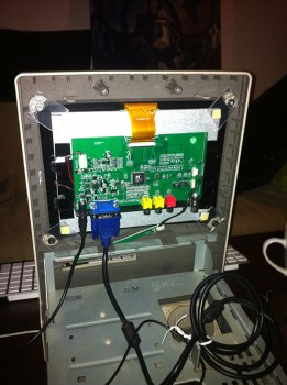

Mine doesn’t have a HDMI port , so it’s connected via an VGA-HDMI adapter, but as you can see in links above, easy to find some with HDMI.

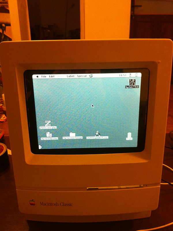

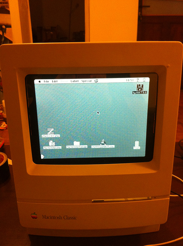

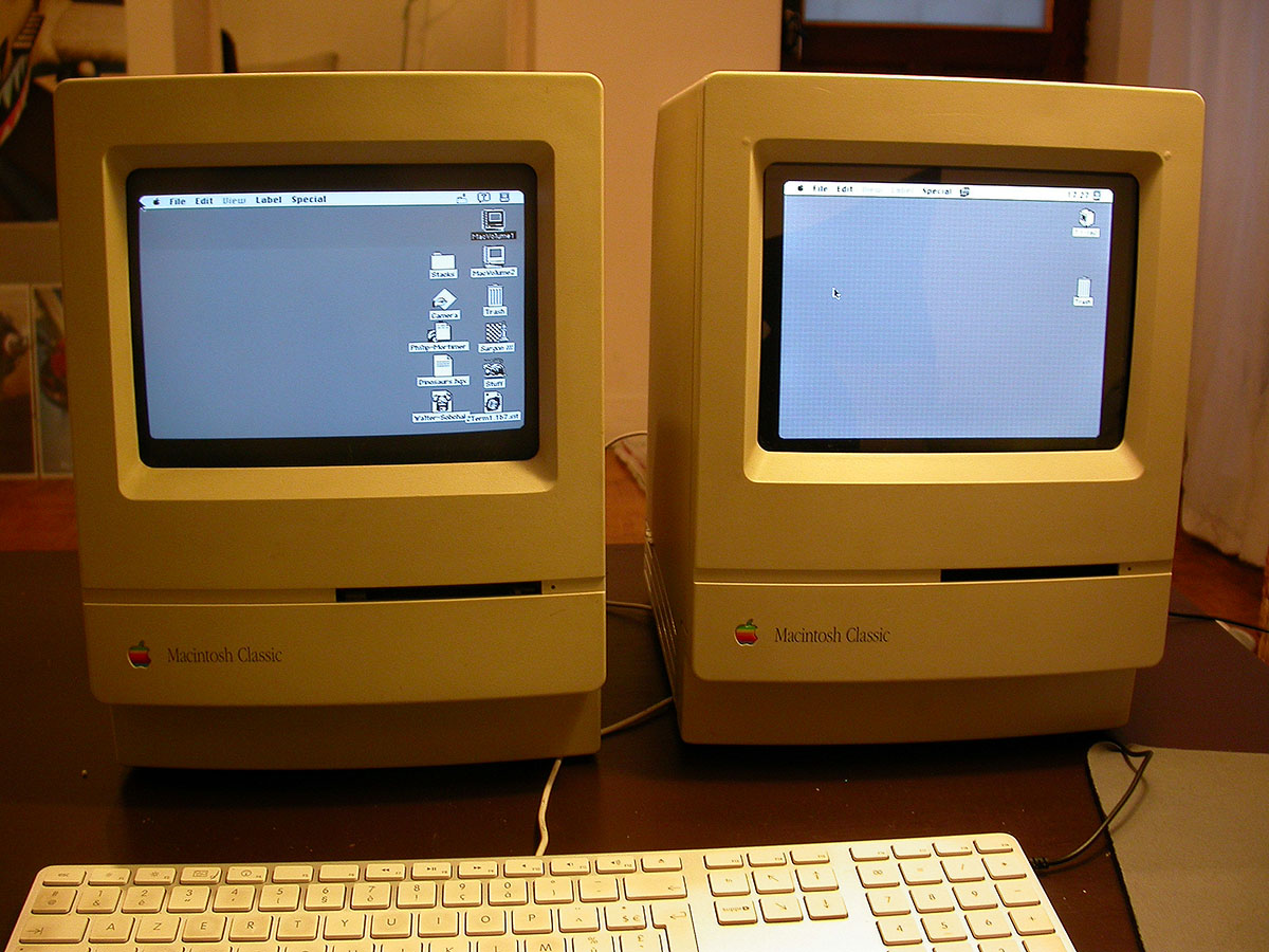

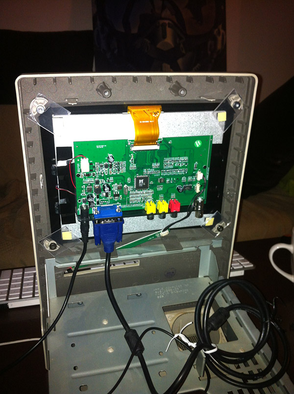

The LCD is removed from his case with his board , then attached to the Classic front case like so :
In front of the screen I’ve inserted a clear acrylic plate , it stays in place between the four screw holders. The plate corners are cut at an angle and a bit larger than the emplacement, so that I bend a bit the acrylic plate to insert it in place. This gives a small curved look, though not enough to look like a real CRT.

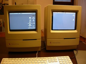

I used black tape to make the black borders like on the CRT.
(Left one is an original Classic)

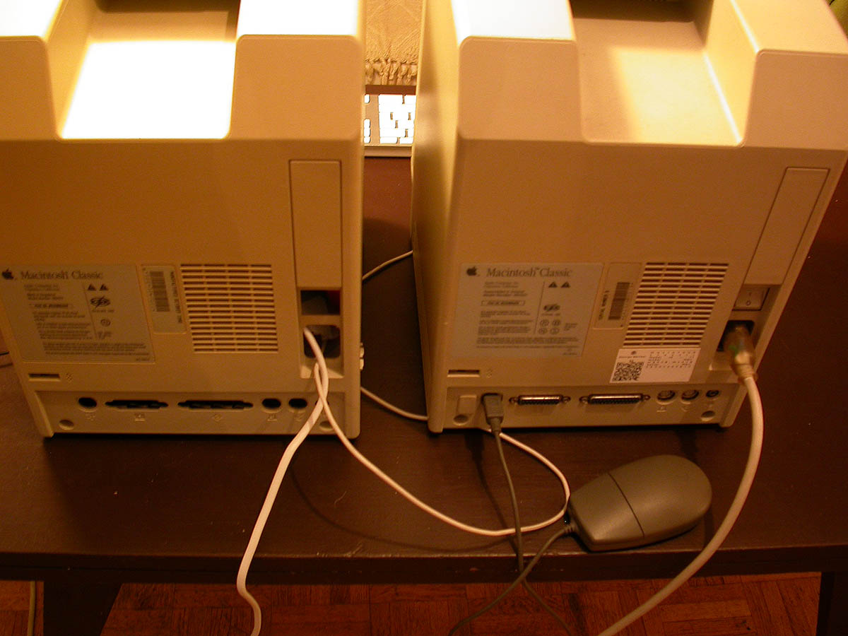

Then you can put the R-Pi inside the case, and let all the wires get out via the empty Classic case ports.
Did that earlier, then I bought a 250GB HD for my Pi, and decided to leave the Pi and the HD outside on the side of the Classic case, cause it’s more convenient when I want to access it.
Software : the R-Pi 3 runs Rapsbian 8 Jessie. With Windowmaker.
