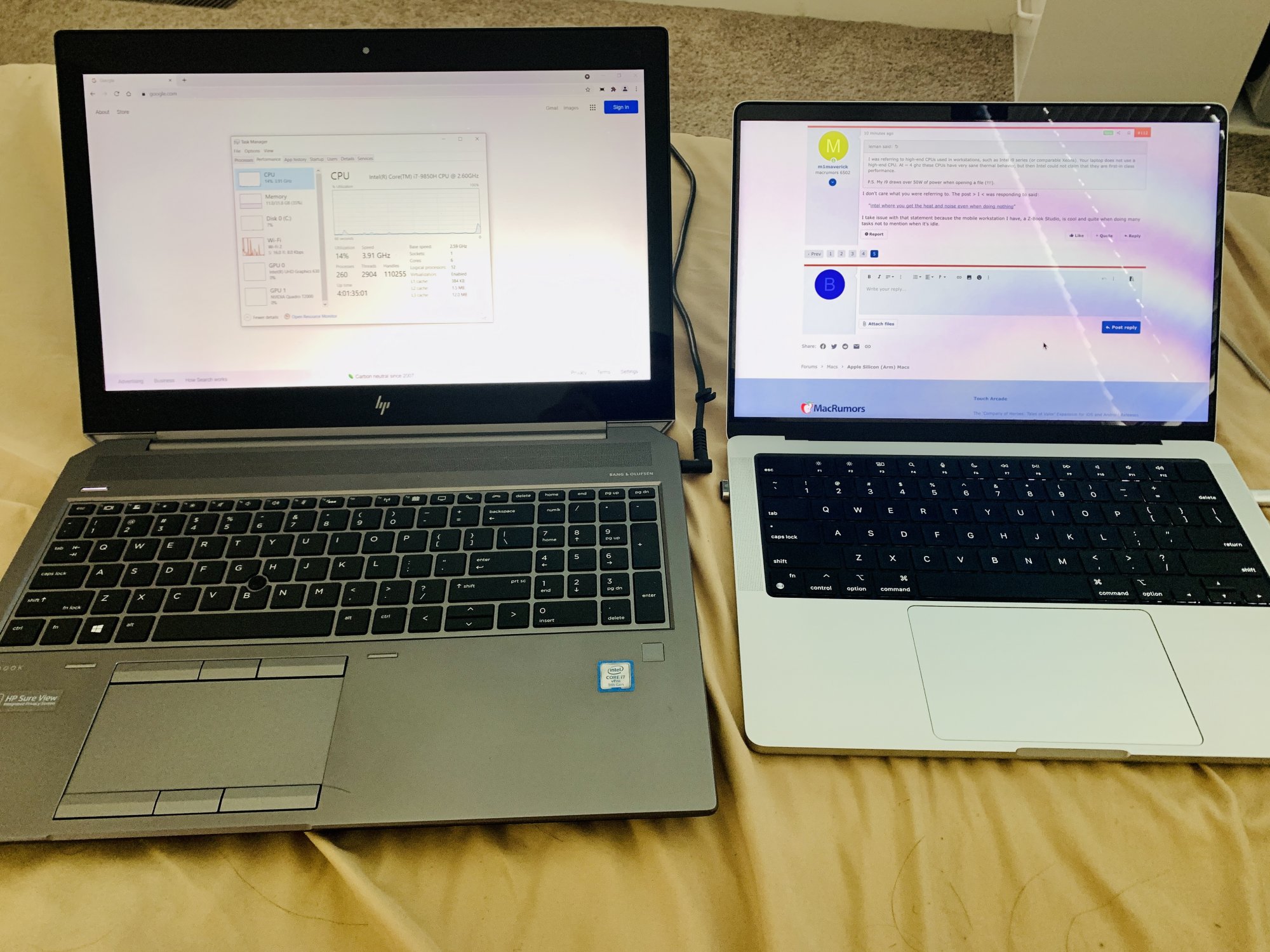

Then allow me to respectfully disagree with you. This thing next to my MacBook is not cool or quiet even when it's literally doing nothing.
The fan is buzzing at 33dB while under 14% load (mostly due to Task Manager) in a room that's 26dB ambient. As soon as any load starts, it'll whoosh up like crazy. Meanwhile, the MacBook's fan is completely off right now.
Edit: also it is much warmer/hotter compared to the 14", which is cool to the touch. Also note that the chip is very boost-happy. It always wants to boost to 4GHz even when there's really nothing that needs that.

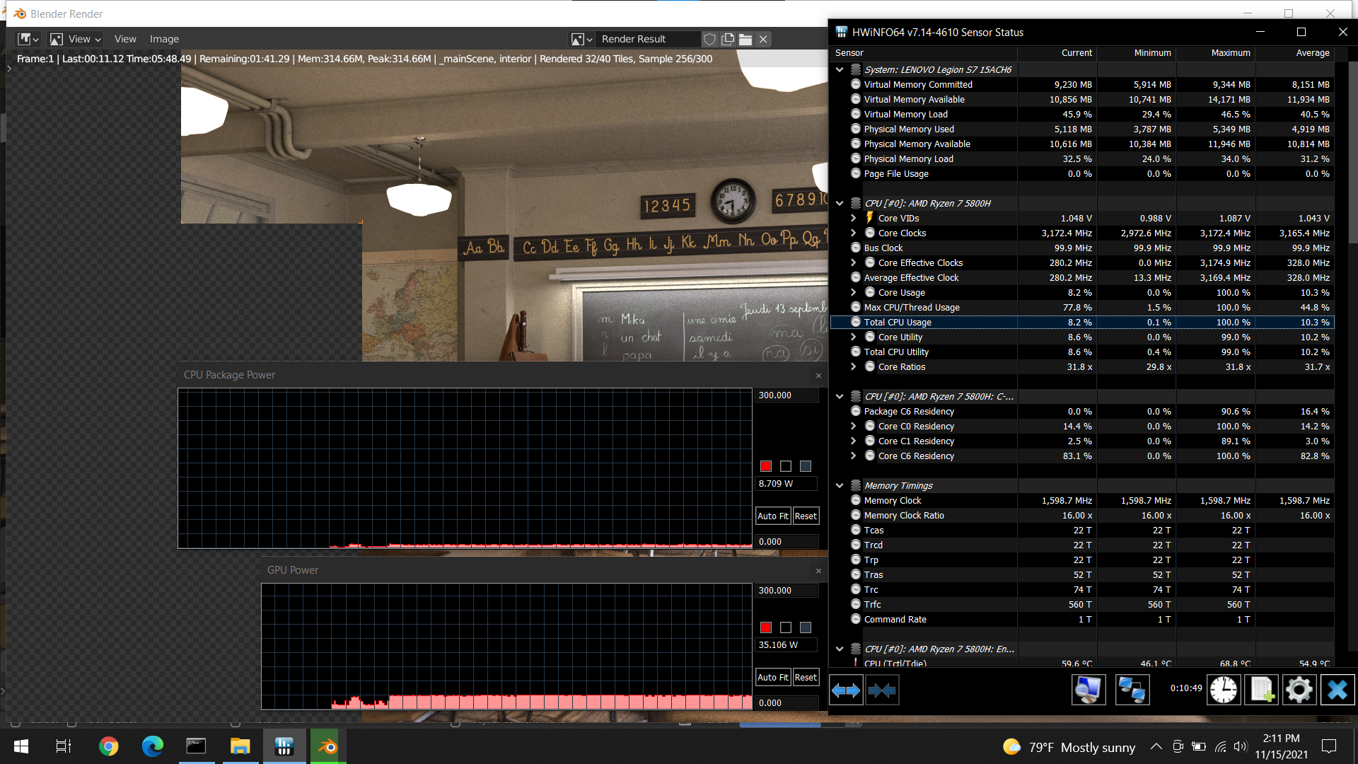

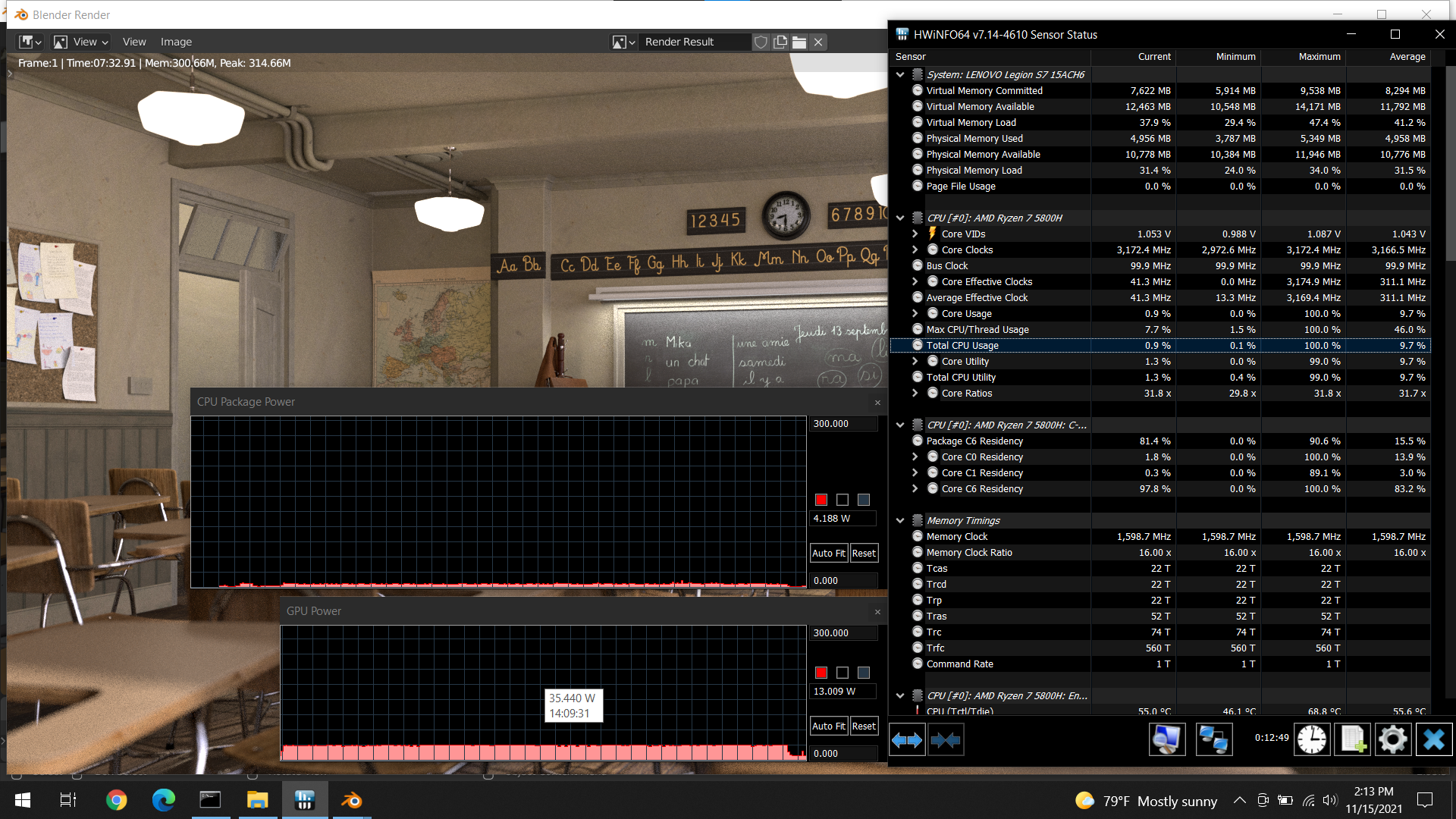

Why is there a High Performance Mode on the 16" M1 Max that has to be manually toggled? Intel is tuned to run at high frequency. Just like if you want a car tuned for the track to not guzzle gas you have to tune it more like a Honda Civic.
I'm talking about total compute performance so that means GPU+CPU. I know GPU compute is new to Apple only users but CPU has been a slave to GPU compute for like a decade for cross platform users. Any heavy compute gets offloaded to GPU. My early exposure to GPU compute was with 9800GX2 which was released in like 2008.
The M1 Max does not need to have High Performance Mode turned on. Auto works just fine.
Also why are you trying to compare M1 against a CPU + GPU combo and then saying M1 is not fast? You're basically saying that a combination of 100W in power consumption performs... twice as fast as a 15W chip.
Even the M1 Pro is not an power hog. I haven't seen mine go over 50W power consumption yet. Even the worst case scenario is just about 48W when both the CPU and GPU are maxed out at the same time.
Cinebench is outdated CPU benchmark. No professional renderer or professional of any kind uses CPU over GPU or GPU compute/render farm. Your power consumption info is outdated too. Here's ~44W total GPU+CPU in quiet mode completing Blender Classroom render in 453 seconds vs ~580 seconds for M1 Max. Until software are updated to support M1 Max to see what difference it makes it's just reality that it's slower.
~44W GPU+CPU power consumption
Render completion in 453 seconds
M1 Max 580s for comparison
https://opendata.blender.org/benchm... Max&benchmark=classroom&blender_version=2.93
