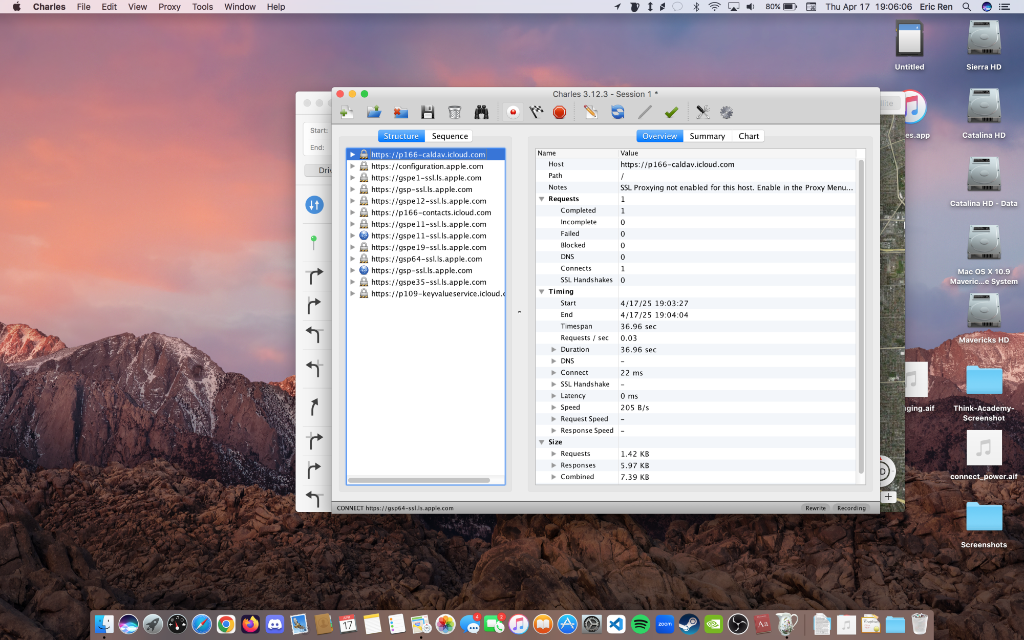

If anyone wants to install CharlesProxy/MitmProxy on a newer and older Mac and look at the URLs being called, maybe we could investigate further. I just don't care that much about 2013-era Apple Maps. There's a reason everyone panned this thing when it came out, sure it got better over time but this is the early one.
this is a screenshot taken from macos 10.12.6 sierra, where the stock maps app still works fine
plus, is there a way to do the gspe__.ls.apple.com to gspe__-ssl.ls.apple.com rewrite in charles?

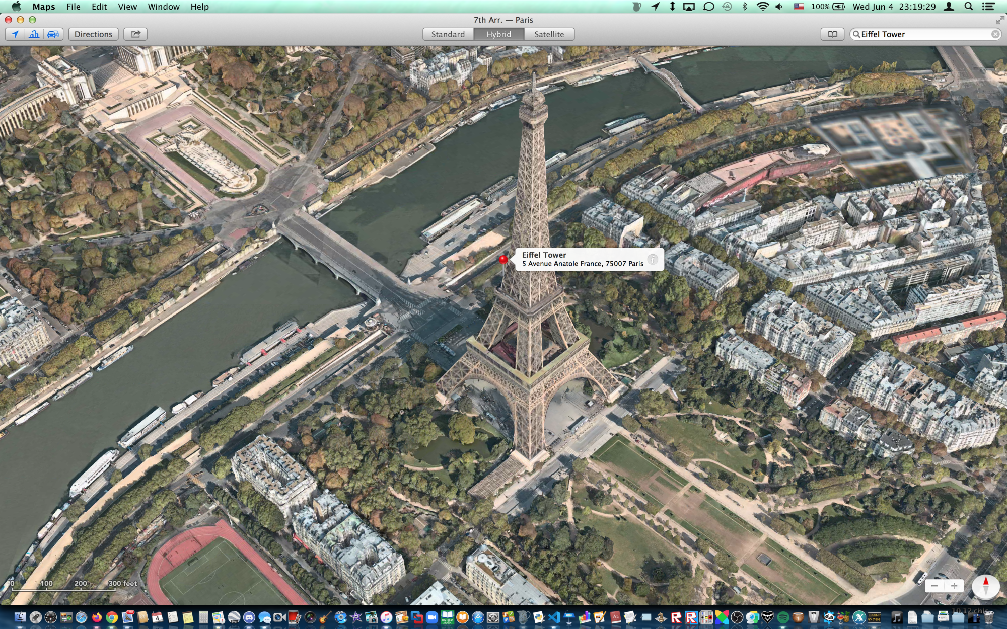

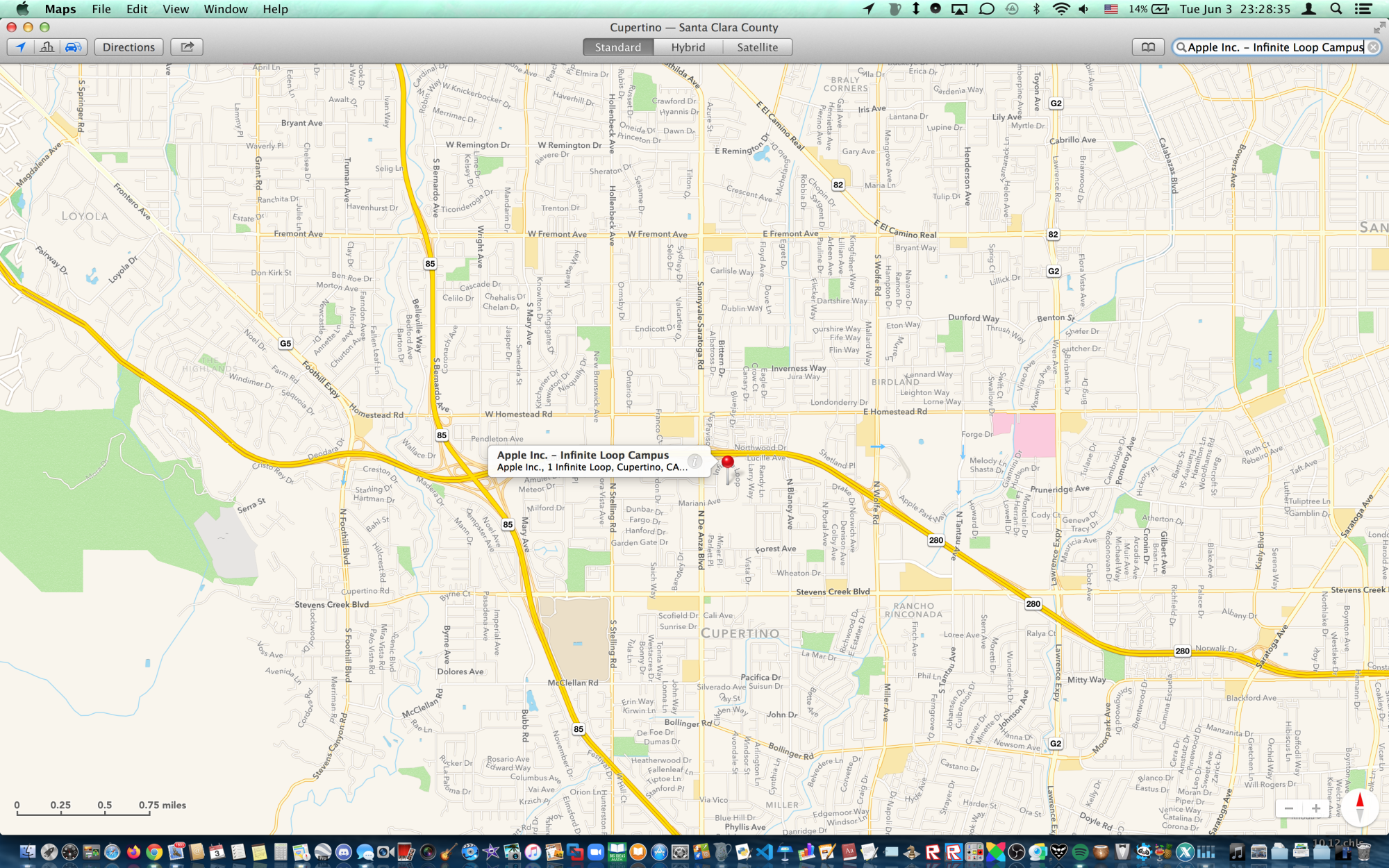

whats working:
standard tiles (can get VERY slow sometimes)
pois, labels, roads
satellite tiles
3d/flyover (not available everywhere)
traffic colored dots
traffic alerts
reviews (i think reviews has always worked)

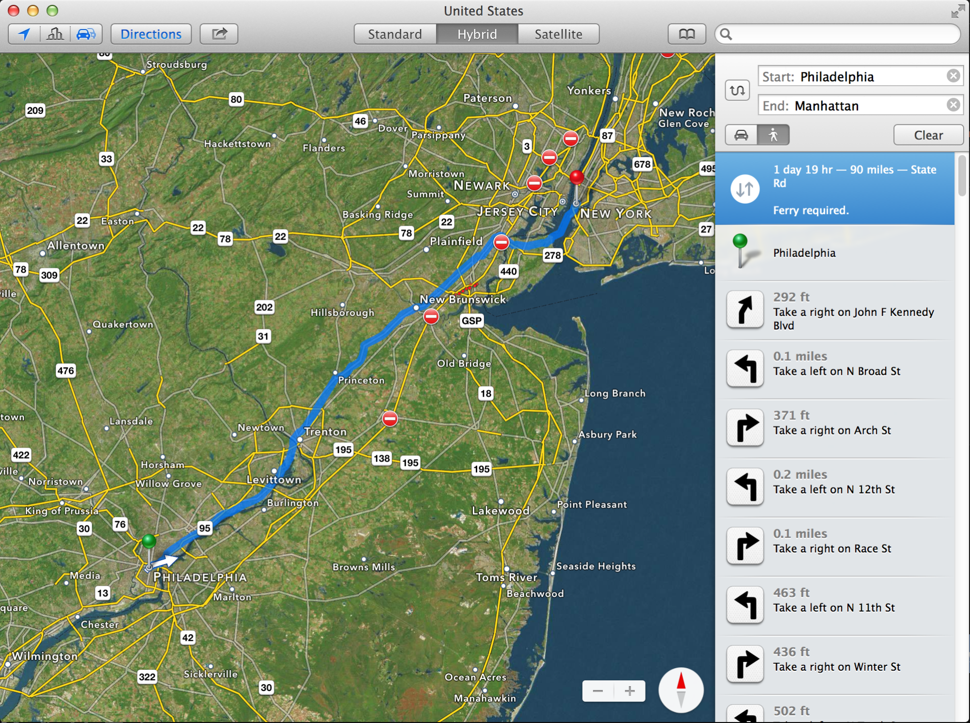

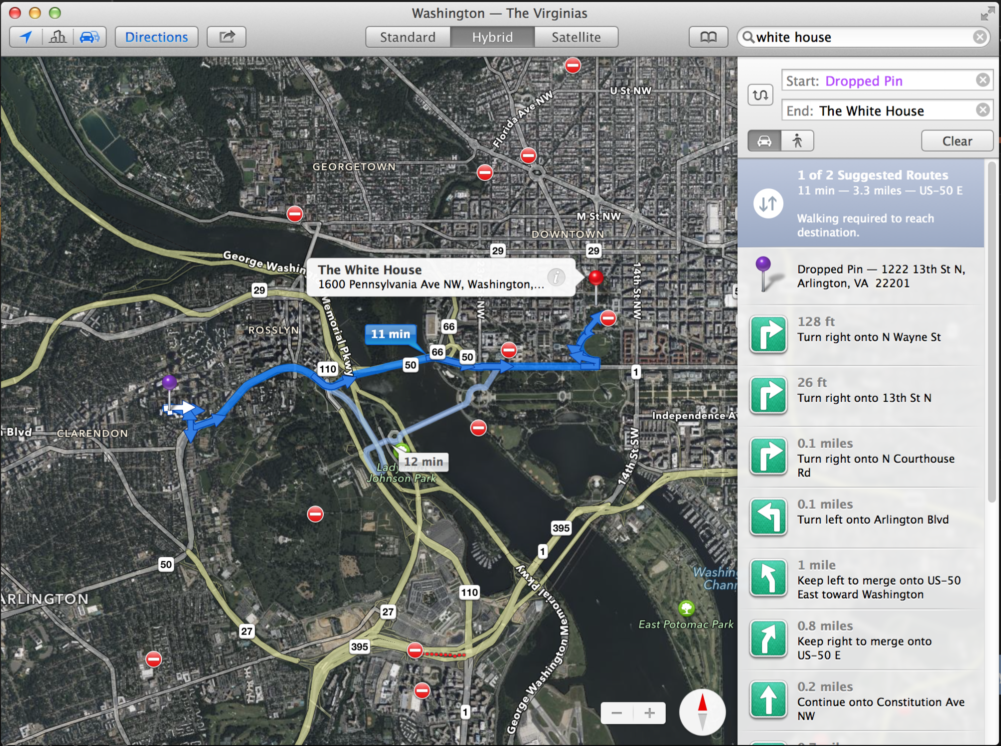

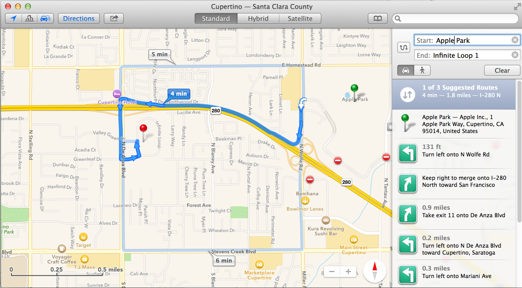

spent a couple hours in xcode and made a simbl plugin that fixes maps directions (shoutout to gpt-5 "extended thinking" for helping debug and write pseudocode), for both driving and walking. the server no longer accepts search queries inside the directions request, so the plugin is programmed to connect to maps.apple.com/data/search to obtain gps coordinates if there is not enough usable data in the destination waypoint to make a successful request. MAKE SURE TO SSL PROXY WITH MAPS.APPLE.COM BECAUSE DEFAULT MAVERICKS SSL CANNOT CONNECT! aquaproxy should be able to handle that. simply place it into /Library/Application Support/SIMBL/Plugins, and relaunch the Maps app if it's currently open. this does not fix the actual tiles, so you will have to still use the manual token method, i am trying to write a plugin to take care of that, but i am not having much luck. enjoy!
ANOTHER BIG THANKS TO PRELOADING (same dude who made the twitter bridge) FOR DEVELOPING THE DIRECTIONS PATCH FOR IOS 6 AND IOS 7! THE PLUGIN IS BASED ON THE SAME LOGIC AS THE MAPSX SOURCE CODE.
more details:
it requests 3 routes, but depending on the distance of the waypoints, the server may give back only one or two. the plugin also requests the route eta based on traffic, so it should be the same eta data as you would get on ios/macos 26 maps. unfortunately, i couldn't get the calendar eta working because com.apple.CalendarAgent isn't an application, but more of a daemon (according to gpt, so a simbl plugin can't affect it).
