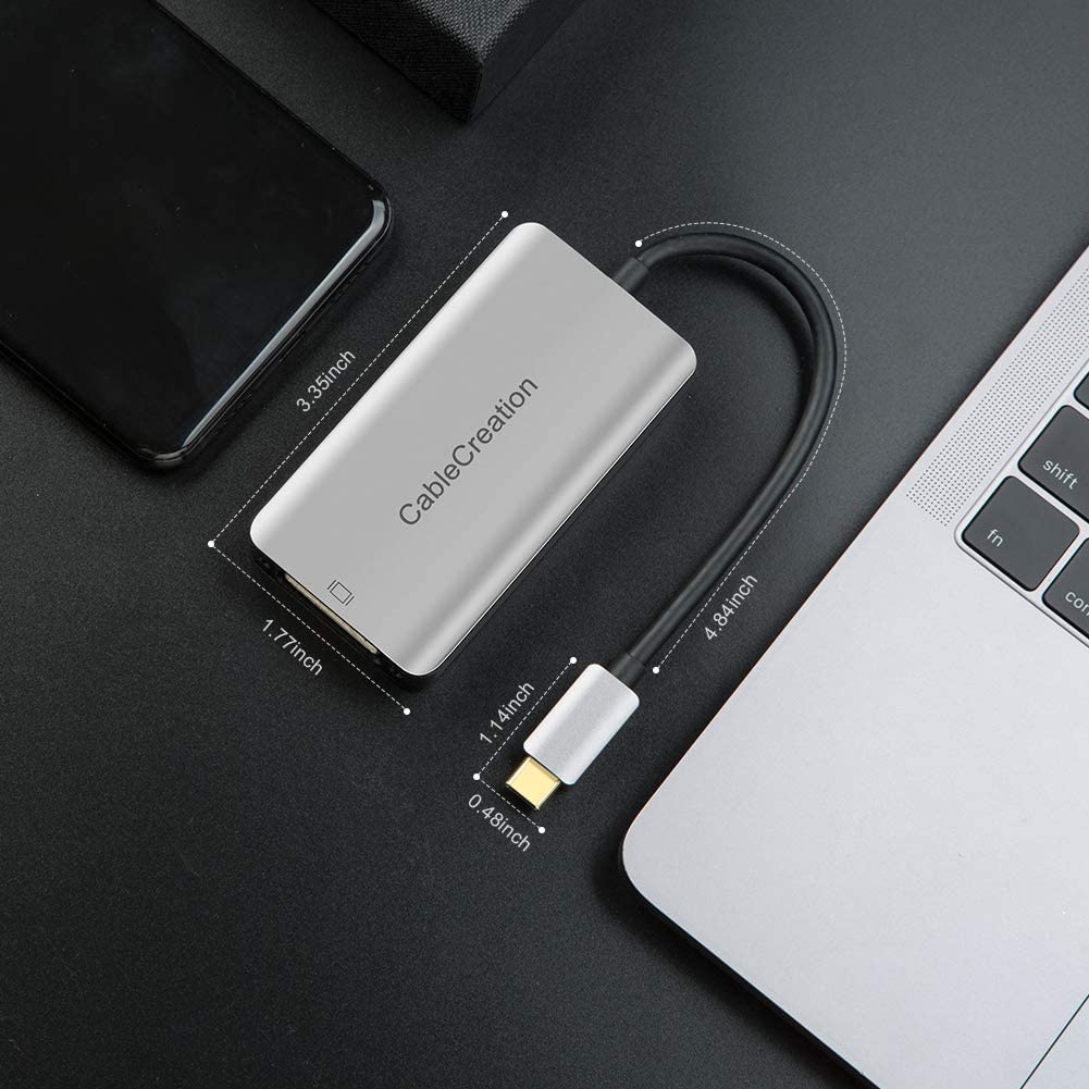

After I ordered the Club3D one, I found out that there is also a CableCreation model that does the same thing and which is considerably cheaper:
In fact, it looks identical, aside from the fact this one has a gold-plated connected and a slightly shorter 5" cable.
However, it specifically says it is not compatible with the iPad Pro in this image:
But then in the main description for the CableCreation, it says it works with the iPad Pro.
The Club 3D one has at least one reviewer that says it works with the 2020 iPad Pro with 30" Cinema Display.
Both have reports of failures after three months, and both have reports of screen anomalies on some units, although there are a few more of the reports with the CableCreation one.
I wonder if they are actually the same hardware from the same OEM, or if they are using different internals.

Despite my post earlier, I ended up ordering both the CableCreation USB-C to dual-link DVI adapter as well as a USB-C hub. And I've cancelled my Club 3D adapter order for now. If the CableCreation one doesn't work, then I'll order the Club 3D one again.
I've had been looking for a simple USB-C to USB-C + USB 3 adapter for a long time for my iMac, but couldn't find a decent one for a decent price, but it turns out CableCreations has one now which even includes USB-C power delivery so I ordered one. They don't actually recommend connecting monitors to it but if it doesn't work with the dual-link DVI adapter on the 12" MacBook, that's OK since it's really for the iMac. If the combo works on the 12" MacBook, then bonus.
EDIT:
Warning. It seems this is an HDCP-on adapter. I had no idea, but it turns out my 30" is from 2007 and supports HDCP, which is why it works with this adapter. See my new post here:

When you get the CableCreations Dual Link DVI adapter, connect it to a relatively modern Intel Mac and verify the DisplayPort link rate and link width with the AGDCDiagnose command.

Why would the adapter need 4 lanes? Can't you theoretically do 2560x1600 at 60 Hz over 2 lanes?
FWIW, CableCreation told me that USB-C hub supports DisplayPort Alt Mode.

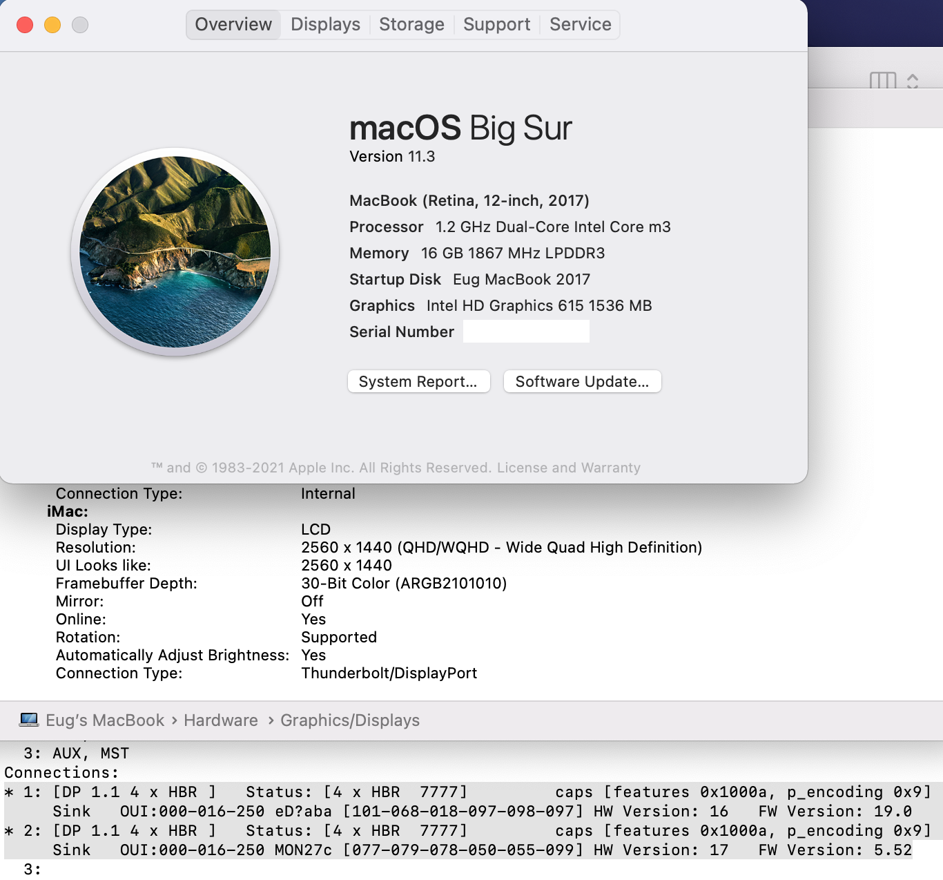

The adapter may be limited to HBR link rate (DisplayPort 1.1). At least HBR2 (DisplayPort 1.2) is required to do 2560x1600 60Hz with two lanes.
Then they should have put a DP icon over the USB-C port next to the USB icon (like the HP Thunderbolt Dock G2 does).
Bah! I had mistakenly assumed everything these days would be at least DP 1.2 HBR2. Guess not.

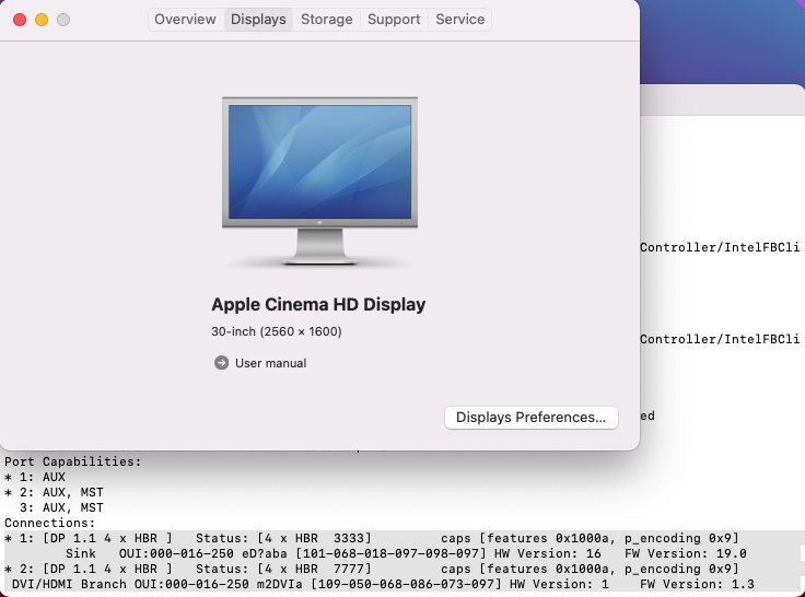

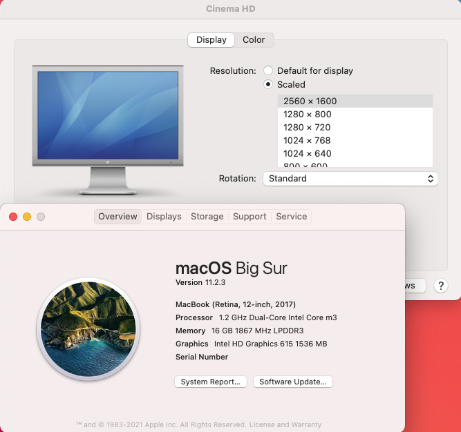

Anyhow the CableCreation USB-C to dual-link DVI adapter (CD0720) works fine with the 30" Cinema HD Display. 👍 Not bad for CAD$46.99 / US$34.99. I wonder if this is the same chipset as the Club 3D.
However, as we expected, the dual-link DVI adapter does not work through the USB-C hub. I'm not going to complain for 14 bucks though (5 Gbps USB 3.0 version).

AGDCDiagnose data dump:
Code:
AGDCDiagnose Version: 6.2.2 (AGDC node count: 3)
### Start: GPUWrangler #######################################################
Stats: GPUCAdded:0 GpuAdded:1 Eject:0/f0/fd0/c0 Remove:0/t0 Un:0
gpu 0x3147 flags 0xb2000010 (IG,published,quiet,pubSched,pubArmed) vid.did=8086.591e b:d:f=0:2:0
gpu 0x3147        pci 0x10000019d IOService:/AppleACPIPlatformExpert/PCI0@0/AppleACPIPCI/IGPU@2
gpu 0x3147       agdc 0x100000333     /AppleIntelFramebufferController/IntelFBClientControl
gpu 0x3147       gpuc 0x000000000
gpu 0x3147 agdpclient 0x10000035a     /AppleIntelFramebufferController/IntelFBClientControl/AppleGraphicsDevicePolicy/AGDPClientControl
gpu 0x3147      accel 0x100000320     /IntelAccelerator
gpu 0x3147      fb0:0 0x100000328     /AppleIntelFramebuffer@0
gpu 0x3147      fb1:1 0x100000329     /AppleIntelFramebuffer@1
gpu 0x3147      fb2:2 0x10000032a     /AppleIntelFramebuffer@2
### End: GPUWrangler (took 0.006 sec) ########################################
### Start: EFIDisplayInfo ####################################################
Not present
Dumping EFI data for GPU Path IOService:/AppleACPIPlatformExpert/PCI0@0/AppleACPIPCI/IGPU@2
### End: EFIDisplayInfo (took 0.006 sec) #####################################
### Start: Mux ###############################################################
### End: Mux (took 0.000 sec) ################################################
### Start: Ports #############################################################
### Start: AGDC[1] 0x100000347 ###############################################
IOService:/IOResources/AppleGPUWrangler
Vendor: Apple [0000106b]: AppleGPUWrangler [8 10000] (0)
### End: AGDC[1] 0x100000347 (took 0.001 sec) ################################
### Start: AGDC[2] 0x100000333 ###############################################
IOService:/AppleACPIPlatformExpert/PCI0@0/AppleACPIPCI/IGPU@2/AppleIntelFramebufferController/IntelFBClientControl
See 0x10000035a
### End: AGDC[2] 0x100000333 (took 0.000 sec) ################################
### Start: AGDC[3] 0x10000035a ###############################################
IOService:/AppleACPIPlatformExpert/PCI0@0/AppleACPIPCI/IGPU@2/AppleIntelFramebufferController/IntelFBClientControl/AppleGraphicsDevicePolicy/AGDPClientControl
Vendor: AppleIntelFramebufferController [0000106b]: IntegratedGPU [1 10000] (0)
FBs: 3, Ports: 0xe mst:0xc ddc:0 aux:0xe, Streams: dp:0 dvi:0 mst:2 max:3
Framebuffers:
* 0: Address:  1.0 Stream: Not Associated Group: 0   Online                     Fixed
* 1: Address:  2.0 Stream: Enabled  Group: 0   Online   Assoc'd
  2: Address:  0.0 Stream: Not Associated Group: 0
Port Capabilities:
* 1: AUX
* 2: AUX, MST
  3: AUX, MST
Connections:
* 1: [DP 1.1 4 x HBR ]      Status: [4 x HBR  7777]      caps [features 0x1000a, p_encoding 0x9]             Sink   OUI:000-016-250 eD?aba [101-068-018-097-098-097] HW Version: 16   FW Version: 19.0
* 2: [DP 1.2 4 x HBR ]      Status: [4 x HBR  7777]      caps [features 0x1000a, p_encoding 0x9]      DVI/HDMI Branch OUI:144-204-036 SYNA#  [083-089-078-065-035-032] HW Version: 16   FW Version: 2.33
  3:
## Register Dump Port 1 - Start ##
000000: 0x11 0x0a 0x84 0x41 0x00 0x00 0x01 0xc0 0x02 0x00 0x00 0x00 0x1f 0x01 0x00 0x00
  Reg: 000000: 11 : DPCD_REV: 1.1
  Reg: 000001: 0a : MAX_LINK_RATE: HBR
  Reg: 000002: 84 : MAX_LANE_COUNT: 4, TPS3_SUPPORTED: 0, ENHANCED_FRAME_CAP: 1
  Reg: 000003: 41 : MAX_DOWNSPREAD: 0.5% down, NO_AUX_HANDSHAKE_LINK_TRAINING: 1
  Reg: 000004: 00 : NORP: 0
  Reg: 000005: 00 : DOWNSTREAMPORT_PRESENT: DWN_STRM_PORT_PRESENT: 0, DWN_STRM_PORT_TYPE: [0] DisplayPort, FORMAT_CONVERSION: 0, DETAILED_CAP_INFO_AVAILABLE: 0
  Reg: 000006: 01 : MAIN_LINK_CHANNEL_CODING: ANSI 8B/10B
  Reg: 000007: c0 : DOWN_STREAM_PORT_COUNT: DWN_STRM_PORT_COUNT: 0, MSA_TIMING_PAR_IGNORED: 1, OUI: 1
  Reg: 000008: 02 : RECEIVE_PORT0_CAP_0: LOCAL_EDID_PRESENT: 1, ASSOCIATED_TO_PRECEDING_PORT: 0
  Reg: 000009: 00 : RECEIVE_PORT0_CAP_1: BUFFER_SIZE: 32
  Reg: 00000a: 00 : RECEIVE_PORT1_CAP_0:
  Reg: 00000b: 00 : RECEIVE_PORT1_CAP_1:
  Reg: 00000c: 1f : I2C Speed: 1Kbps 5Kbps 10Kbps 100Kbps 400Kbps
  Reg: 00000d: 01 : eDP_CONFIGURATION_CAP: ALTERNATE_SCRAMBLER_RESET_CAPABLE: 1, FRAMING_CHANGE_CAPABLE: 0
  Reg: 00000e: 00 : TRAINING_AUX_RD_INTERVAL: 100 us, EXTENDED_RECEIVER_CAPABILITY_FIELD_PRESENT: NO
  Reg: 00000f: 00 : ADAPTER_CAP: FORCE_LOAD_SENSE_CAP: 0, ALTERNATE_I2C_PATTERN_CAP: 0
000020: 0x00 0x00 0x00
  Reg: 000020: 00 : FAUX_CAP: FAUX_CAP: 0
  Reg: 000021: 00 : MSTM_CAP: MST_CAP: 0
  Reg: 000022: 00 : NUMBER_OF_AUDIO_ENDPOINTS: 0
000060: 0x00 0x00 0x00 0x00 0x00 0x00 0x00 0x00 0x00 0x00 0x00 0x00 0x00 0x00 0x00 0x00
  Reg: 000060: 00 : DSC Support: 0
  Reg: 000061: 00 : DSC Algorithm revision: 0
  Reg: 000062: 00 : DSC RC Buffer Block size: 0
  Reg: 000063: 00 : DSC RC Buffer size: 0
  Reg: 000064: 00 : DSC slice Capabilities 1 : 0
  Reg: 000065: 00 : DSC Line buffer bit depth: 0
  Reg: 000066: 00 : DSC Block prediction support: 0
  Reg: 000067: 00 : DSC Maximum bit per pixel: 0
  Reg: 000068: 00 : DSC Maximum bit per pixel: 0
  Reg: 000069: 00 : DSC Decoder color format capabilities: 0
  Reg: 00006a: 00 : DSC decoder color depth capabilities: 0
  Reg: 00006b: 00 : DSC Peak Throughput: 0
  Reg: 00006c: 00 : DSC Maximum Slice width: 0
  Reg: 00006d: 00 : DSC Slice capabilities 2: 0
  Reg: 00006e: 00 : Reserved: 0
  Reg: 00006f: 00 : DSC Bits per pixel increment: 0
000090: 0x00
  Reg: 000090: 00 : FEC Capability: 0x0
000080: 0x00 0x00 0x00 0x00 0x00 0x00 0x00 0x00 0x00 0x00 0x00 0x00 0x00 0x00 0x00 0x00
  Reg: 000080: 00 : DETAILED_CAP_INFO_AVAILABLE: DWN_STRM_PORTX_CAP: [0] DisplayPort, DWN_STRM_PORTX_HPD: 0, NON_EDID_DWN_STRM_PORTX_ATTRIBUTE: 0
  Reg: 000081: 00 : DETAILED_CAP_INFO_AVAILABLE: DWN_STRM_PORTX_CAP: [0] DisplayPort, DWN_STRM_PORTX_HPD: 0, NON_EDID_DWN_STRM_PORTX_ATTRIBUTE: 0
  Reg: 000082: 00 : DETAILED_CAP_INFO_AVAILABLE: DWN_STRM_PORTX_CAP: [0] DisplayPort, DWN_STRM_PORTX_HPD: 0, NON_EDID_DWN_STRM_PORTX_ATTRIBUTE: 0
  Reg: 000083: 00 : DETAILED_CAP_INFO_AVAILABLE: DWN_STRM_PORTX_CAP: [0] DisplayPort, DWN_STRM_PORTX_HPD: 0, NON_EDID_DWN_STRM_PORTX_ATTRIBUTE: 0
  Reg: 000084: 00 : DETAILED_CAP_INFO_AVAILABLE: DWN_STRM_PORTX_CAP: [0] DisplayPort, DWN_STRM_PORTX_HPD: 0, NON_EDID_DWN_STRM_PORTX_ATTRIBUTE: 0
  Reg: 000085: 00 : DETAILED_CAP_INFO_AVAILABLE: DWN_STRM_PORTX_CAP: [0] DisplayPort, DWN_STRM_PORTX_HPD: 0, NON_EDID_DWN_STRM_PORTX_ATTRIBUTE: 0
  Reg: 000086: 00 : DETAILED_CAP_INFO_AVAILABLE: DWN_STRM_PORTX_CAP: [0] DisplayPort, DWN_STRM_PORTX_HPD: 0, NON_EDID_DWN_STRM_PORTX_ATTRIBUTE: 0
  Reg: 000087: 00 : DETAILED_CAP_INFO_AVAILABLE: DWN_STRM_PORTX_CAP: [0] DisplayPort, DWN_STRM_PORTX_HPD: 0, NON_EDID_DWN_STRM_PORTX_ATTRIBUTE: 0
  Reg: 000088: 00 : DETAILED_CAP_INFO_AVAILABLE: DWN_STRM_PORTX_CAP: [0] DisplayPort, DWN_STRM_PORTX_HPD: 0, NON_EDID_DWN_STRM_PORTX_ATTRIBUTE: 0
  Reg: 000089: 00 : DETAILED_CAP_INFO_AVAILABLE: DWN_STRM_PORTX_CAP: [0] DisplayPort, DWN_STRM_PORTX_HPD: 0, NON_EDID_DWN_STRM_PORTX_ATTRIBUTE: 0
  Reg: 00008a: 00 : DETAILED_CAP_INFO_AVAILABLE: DWN_STRM_PORTX_CAP: [0] DisplayPort, DWN_STRM_PORTX_HPD: 0, NON_EDID_DWN_STRM_PORTX_ATTRIBUTE: 0
  Reg: 00008b: 00 : DETAILED_CAP_INFO_AVAILABLE: DWN_STRM_PORTX_CAP: [0] DisplayPort, DWN_STRM_PORTX_HPD: 0, NON_EDID_DWN_STRM_PORTX_ATTRIBUTE: 0
  Reg: 00008c: 00 : DETAILED_CAP_INFO_AVAILABLE: DWN_STRM_PORTX_CAP: [0] DisplayPort, DWN_STRM_PORTX_HPD: 0, NON_EDID_DWN_STRM_PORTX_ATTRIBUTE: 0
  Reg: 00008d: 00 : DETAILED_CAP_INFO_AVAILABLE: DWN_STRM_PORTX_CAP: [0] DisplayPort, DWN_STRM_PORTX_HPD: 0, NON_EDID_DWN_STRM_PORTX_ATTRIBUTE: 0
  Reg: 00008e: 00 : DETAILED_CAP_INFO_AVAILABLE: DWN_STRM_PORTX_CAP: [0] DisplayPort, DWN_STRM_PORTX_HPD: 0, NON_EDID_DWN_STRM_PORTX_ATTRIBUTE: 0
  Reg: 00008f: 00 : DETAILED_CAP_INFO_AVAILABLE: DWN_STRM_PORTX_CAP: [0] DisplayPort, DWN_STRM_PORTX_HPD: 0, NON_EDID_DWN_STRM_PORTX_ATTRIBUTE: 0
000100: 0x0a 0x84
  Reg: 000100: 0a : LINK_BW_SET: HBR
  Reg: 000101: 84 : LANE_COUNT_SET: LANE_COUNT_SET 4, ENHANCED_FRAME_EN: 1
000107: 0x00
  Reg: 000107: 00 : DOWNSPREAD_CTRL: SPREAD_AMP: 0, MSA_TIMING_PAR_IGNORE_EN: 0
00010a: 0x01
  Reg: 00010a: 01 : eDP_CONFIGURATION_CAP_SET: ALTERNATE_SCRAMBLER_RESET_CAPABLE: 1, FRAMING_CHANGE_CAPABLE: 0
000111: 0x00
  Reg: 000111: 00 : MSTM_CTRL: UPSTREAM_IS_SRC:0 UP_REQ_EN:0 MST_EN:0
000120: 0x00
  Reg: 000120: 00 : FEC Configuration: 0x0
000160: 0x00
  Reg: 000160: 00 : DSC Enable: 0x0
000200: 0x01 0x00 0x77 0x77 0x81 0x01 0x00 0x00
  Reg: 000200: 01 : SINK_COUNT: SINK_COUNT 1, CP_READY: 0
  Reg: 000202: 77 : LANE0: CR_DONE: 1, CHANNEL_EQ_DONE: 1, SYMBOL_LOCKED: 1
  Reg: 000202: 77 : LANE1: CR_DONE: 1, CHANNEL_EQ_DONE: 1, SYMBOL_LOCKED: 1
  Reg: 000203: 77 : LANE2: CR_DONE: 1, CHANNEL_EQ_DONE: 1, SYMBOL_LOCKED: 1
  Reg: 000203: 77 : LANE3: CR_DONE: 1, CHANNEL_EQ_DONE: 1, SYMBOL_LOCKED: 1
  Reg: 000205: 01 : SINK_STATUS: RECEIVE_PORT_0_STATUS: 1, RECEIVE_PORT_1_STATUS: 0
  Reg: 000206: 00 : LANE0: VOLTAGE_SWING: 0, PRE-EMPHASIS: 0
  Reg: 000206: 00 : LANE1: VOLTAGE_SWING: 0, PRE-EMPHASIS: 0
  Reg: 000207: 00 : LANE2: VOLTAGE_SWING: 0, PRE-EMPHASIS: 0
  Reg: 000207: 00 : LANE3: VOLTAGE_SWING: 0, PRE-EMPHASIS: 0
00020f: 0x00
  Reg: 00020f: 00 : DSC Status: 0
000280: 0x00
  Reg: 000280: 00 : FEC Status: 0
00042f: 0x00
  Reg: 00042f: 00 : DISPLAY_ROTATION: 0x0
002200: 0x00 0x00 0x00 0x00 0x00 0x00 0x00 0x00 0x00 0x00 0x00 0x00 0x00 0x00 0x00 0x00
  Reg: 002200: 00 : DPCD_REV: 0.0
  Reg: 002201: 00 : MAX_LINK_RATE: ???
  Reg: 002202: 00 : MAX_LANE_COUNT: 0, TPS3_SUPPORTED: 0, ENHANCED_FRAME_CAP: 0
  Reg: 002203: 00 : MAX_DOWNSPREAD: None, NO_AUX_HANDSHAKE_LINK_TRAINING: 0
  Reg: 002204: 00 : NORP: 0
  Reg: 002205: 00 : DOWNSTREAMPORT_PRESENT: DWN_STRM_PORT_PRESENT: 0, DWN_STRM_PORT_TYPE: [0] DisplayPort, FORMAT_CONVERSION: 0, DETAILED_CAP_INFO_AVAILABLE: 0
  Reg: 002206: 00 : MAIN_LINK_CHANNEL_CODING_SET: ??
  Reg: 002207: 00 : DOWN_STREAM_PORT_COUNT: DWN_STRM_PORT_COUNT: 0, MSA_TIMING_PAR_IGNORED: 0, OUI: 0
  Reg: 002208: 00 : RECEIVE_PORT0_CAP_0: LOCAL_EDID_PRESENT: 0, ASSOCIATED_TO_PRECEDING_PORT: 0
  Reg: 002209: 00 : RECEIVE_PORT0_CAP_1: BUFFER_SIZE: 32
  Reg: 00220a: 00 : RECEIVE_PORT1_CAP_0:
  Reg: 00220b: 00 : RECEIVE_PORT1_CAP_1:
  Reg: 00220c: 00 : I2C Speed:
  Reg: 00220d: 00 : eDP_CONFIGURATION_CAP_SET: ALTERNATE_SCRAMBLER_RESET_CAPABLE: 0, FRAMING_CHANGE_CAPABLE: 0
  Reg: 00220e: 00 : TRAINING_AUX_RD_INTERVAL: 100 us, EXTENDED_RECEIVER_CAPABILITY_FIELD_PRESENT: NO
  Reg: 00220f: 00 : ADAPTER_CAP: FORCE_LOAD_SENSE_CAP: 0, ALTERNATE_I2C_PATTERN_CAP: 0
068028: 0x00
  Reg: 068028: 00 : HDCP_CAPABLE: 0, REPEATER: 0
06921d: 0x00 0x00 0x00
  Reg: 06921d: 00 : VERSION: 0
  Reg: 06921f: 00 : HDCP_CAPABLE: 0, REPEATER: 0
069330: 0x00 0x00
  Reg: 069330: 00 : HDCP_Depth: 0
  Reg: 069331: 00 : HDCP_count: 0  HDCP2_0 Downstream: 0 HDCP1 Downstream: 0
069493: 0x00
  Reg: 069493: 00 : Ready: 0 , H' Available: 0, Pairing_available: 0 , Reauth_req: 0, Link Integrity: 0
## Register Dump Port 1 - End ##

  Reg: 000088: 08 : DETAILED_CAP_INFO_AVAILABLE: DWN_STRM_PORTX_CAP: [0] DisplayPort, DWN_STRM_PORTX_HPD: 1, NON_EDID_DWN_STRM_PORTX_ATTRIBUTE: 0
000100: 0x0a 0x84
000107: 0x00
00010a: 0x00
  Reg: 00010a: 00 : eDP_CONFIGURATION_CAP_SET: ALTERNATE_SCRAMBLER_RESET_CAPABLE: 0, FRAMING_CHANGE_CAPABLE: 0
000111: 0x00
000120: 0x00
000160: 0x00
00020f: 0x00
000280: 0x00
00042f: 0x00
068028: 0x00
069330: 0x00 0x00
069493: 0x00
## Register Dump Port 2 - End ##
You mean 1280x800 works but 2560x1600 does not appear in the list of resolutions.
Actually, I had done a couple of searches on the Mac and via Google already, and nothing came up regarding this command. I guess that's not a huge surprise though, since the command is hidden inside a kext.
No, if I try using the USB-C hub with the Cable Creation USB-C to dual-link DVI adapter, I get a black screen. Monitor is not detected.
Without the hub, it works fine. It shows as 1280x800, but I have the 2560x1600 option.
Which USB-C hub are we talking about? The one from CableCreations where they advertise no video support?
Yup. The ad says don't connect a monitor. However, I contacted them and the agent said DP Alt Mode was supported. Personally I think the agent was wrong and the original ad was correct, but I'm not going to worry about it.

Could it be reading the Apple adapter instead? Here are my two active displays (internal display and 30" Cinema Display using the Apple OEM mini-DP to DL-DVI adapter with the no-name USB-C to mini-DP adapter):
Code:
* 2: [DP 1.1 4 x HBR ] 	 Status: [4 x HBR  7777] 	 caps [features 0x1000a, p_encoding 0x9] 	 DVI/HDMI Branch OUI:000-016-250 m2DVIa [109-050-068-086-073-097] HW Version: 1    FW Version: 1.3
Both are 000-016-250.
The agent probably doesn't even know what DisplayPort Alt Mode is...
Isn't that what I said? That info is from DisplayPort. The 30" Cinema is not DisplayPort, therefore the info is from the adapter.
Code:
Yes, Apple has set the OUI of the internal display (eD?aba) and the adapter (m2DVIa) to 000-016-250 (Apple Inc.)
http://standards-oui.ieee.org/oui/oui.txt
http://standards-oui.ieee.org/cid/cid.txt
The EDIDs (included in the AGDCDiagnose output) for the internal display and the 30" Cinema Display both have vendor 610 = APP (Apple).
https://uefi.org/pnp_id_list
The USB-C to mini-DP adapter is not a DisplayPort device so there's no DPCD info for that. The adapter is a USB-C device so it may have a USB 2.0 Billboard Device which causes a message to appear if you connect it to a system that does not support DisplayPort Alt Mode (at least in Windows?).
Oh, I thought you were talking about the USB-C to mini-DP adapter, but I see that you've explained it below.

So, this does work with the 30" Cinema HD Display, with a couple of caveats:
1) Since I need to use the Apple mini-DP to DL-DVI adapter with the Cable Matters adapter, it also means I need to provide power to the Apple adapter, via a USB port. The problem is if I plug the USB port into the Cable Matters multi-adapter, I don't think the MacBook's USB-C port provides enough power, because the screen shuts off every so often. However, if plug in the power adapter for USB-C power delivery to the Cable Matters multi-adapter, then it all works fine. Screen doesn't shut off and the MacBook charges too. I could power the Apple DL-DVI adapter separately but the added benefit of connecting it to the Cable Matters is that then the display can act as a USB hub, since it has USB ports on the back. I have a third party webcam attached to the display's USB port, and it works fine with the MacBook this way.
2) Even in clamshell mode, the brightness buttons on Magic Keyboard don't do anything. They are linked only to the internal display, which is of course off in clamshell mode. Is there a setting somewhere to change this? I have to use the brightness buttons on the side of the display.
3) The lack of Retina! o_O I've been OK with it for video playback and as a secondary display, but I of course have been spoiled for text by my Retina iMac.
You can do a 1280x800 HiDPI mode... or anything between that and 2560x1600 (just making a joke; I know you meant the display doesn't have the dpi for retina)
