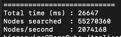

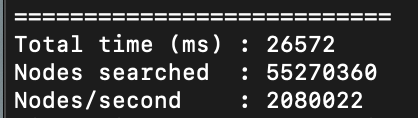

That what you're looking for? M1 MBP 13'
Yes, thanks. Your score is quite a bit lower than the 3024 kN/s reported on the forum I linked to.
Supposedly, the executable is M1 native since it's installed by homebrew. But your M1 is only about 35% faster than my iMac, while it should be more like 65% faster.

bigmcguire@BorgCube /Applications % file $(which stockfish)
/opt/homebrew/bin/stockfish: Mach-O 64-bit executable arm64
Interesting indeed :D

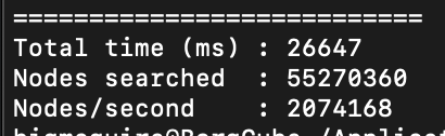

I rebooted, unplugged 4k monitor, waited for OS fresh boot to calm down and got similar results.
Thanks. The difference with the numbers posted online may reflect different versions of Stockfish. I think they used the "classical" version while we've installed the current (NNUE) version, which currently runs slower on M1 due to missing/insufficient SIMD optimisation. However, the NNUE version has the potential to be much faster on the M1 thanks to its Neural Engine (which would require someone to implement the algorithm in coreML, which may not happen anytime soon).

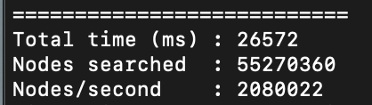

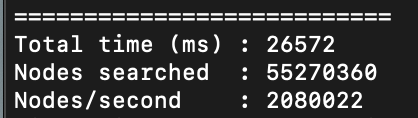

View attachment 1763327 Second Run: View attachment 1763330

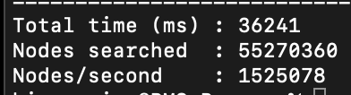

My 2019 MBP 15' i7: (fans were screaming)
Wow.

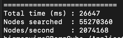

M1 got 2074168 nodes/second.
Looks like Stockfish doesn't use the Neural Engine in the M1 (which is expected, since it's a multiplatform tool apparently). If you could find a chess engine that uses the Neural Engine (using CoreML) the results might be quite different.
