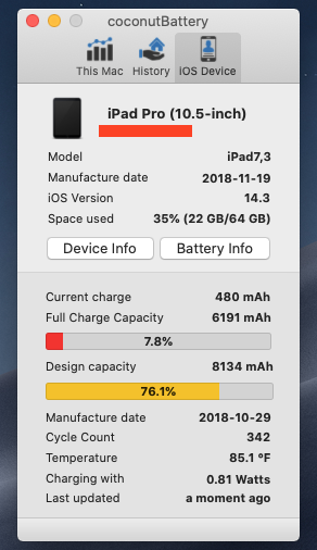

I have the same problem with my iPad Pro 10.5. When this thing was still under warranty and the battery performance was rapidly degrading, I went to Apple and they looked at me like an idiot when I tried to explain the situation. Fast forward 2+ years and I am stuck with an iPad that typically lasts 3-4 hours, perhaps a bit longer if I bitterly do nothing but light browsing. At only 342 cycles, coconut shows 75-76% battery life.
I am willing to give it a shot to see if Apple is willing to honor $99 battery service, but I wonder if I need to go to an Apple store, or could the diagnostics etc be done online?
I don't know if it is possible to do it online, but in my case they plugged my iPad into another iPad with a special app and made a test. My iPad failed the test at 56%. Coconut was reporting 40%. I have a friend at 64%. I suggested him to wait and wear down the battery a little more...
Yes! They will diagnose battery health via phone call to support. They will ask you to go to privacy setting then click ”share analytics data” with that switched on they will remotely connect to your iPad and run a short digital snapshot of your iPads performance..health etc. Usually done in minutes.

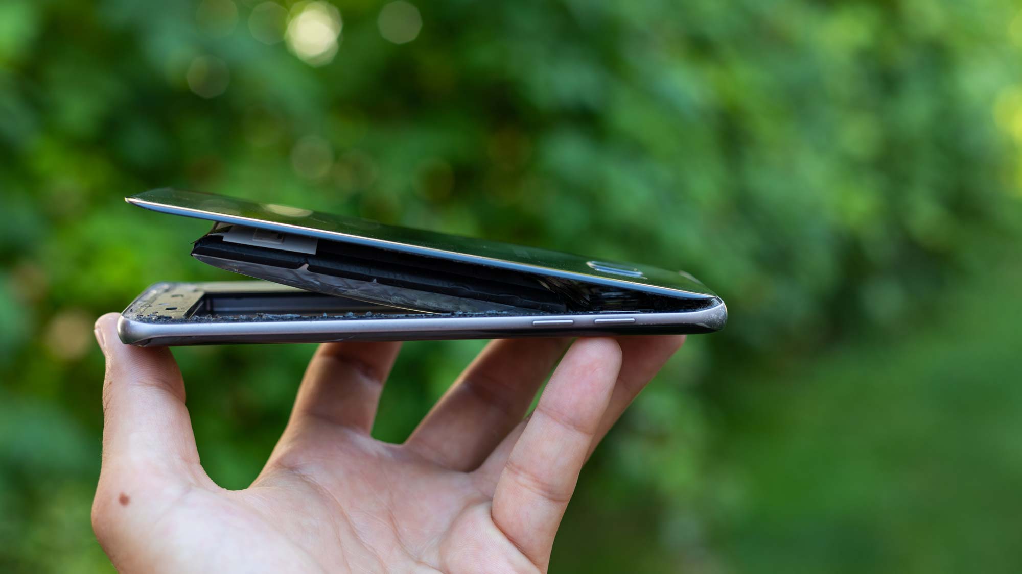

I had a similar issue with my iPhone SE. They said that the battery had swollen and it was dangerous to replace... The swelling was so minor I hadn't even noticed it at all... So they quoted me almost $300 for replacing the phone, which I refused and they send it back as it was...
  • Wow
Reactions: foliovision
It may be a bit dangerous to replace, though it's definitely dangerous to continue using a swollen/swelling battery.
No, it's not and they confirmed that the is no danger, especially if the swelling is minor. The only danger is if it takes a major shock, which it won't since it's not my main phone (which is a Samsung)
PS the danger of replacing was probably not big, but it was a good excuse to make more money...

There is a lot of misinformation about this... A swollen battery will not explode by itself, it needs to be pierced to explode. And the gas it creates are not dangerous. My iphone does not stay in my pocket but in a drawer and I charge it once a month on average, since I use it only every now and then as an ipod....

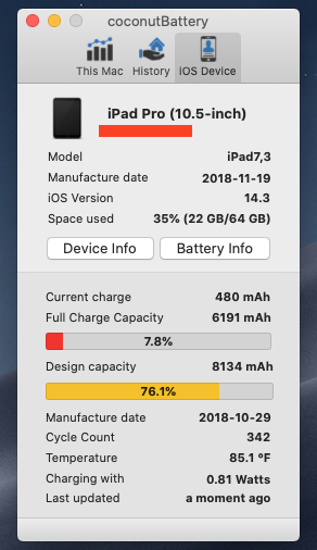

I have requested an out of warranty battery replacement for my iPad Pro 10.5 (2017). It's on about 524 cycles and Coconut Battery is showing 71,8% design capacity. I really feel the battery being really degraded after 3 years of use. On Safari browsing (for about 4 hours a day) my fully charged iPad Pro goes to somewhere in the 30% battery. Sometimes it would instantly drop from 60% to like 40% after a few minutes of use.
I have consulted Apple support by phone and the employee said the battery has degraded too much. He did not use the diagnose tool though even after i had requested him to do. He just said sent it to us and we will replace the battery for the stated out of warranty fee.
Hopefully Apple does not refuse the request as it seems their diagnostic tool has different readings compared to Coconut Battery. For me the battery is obviously degraded quite a bit as it can't last a day anymore. Enough for me to fork out the cash to replace the battery. The device itself is still pristine on the outside and is still working fine and i see no need yet to replace it with a newer model iPad Pro.
