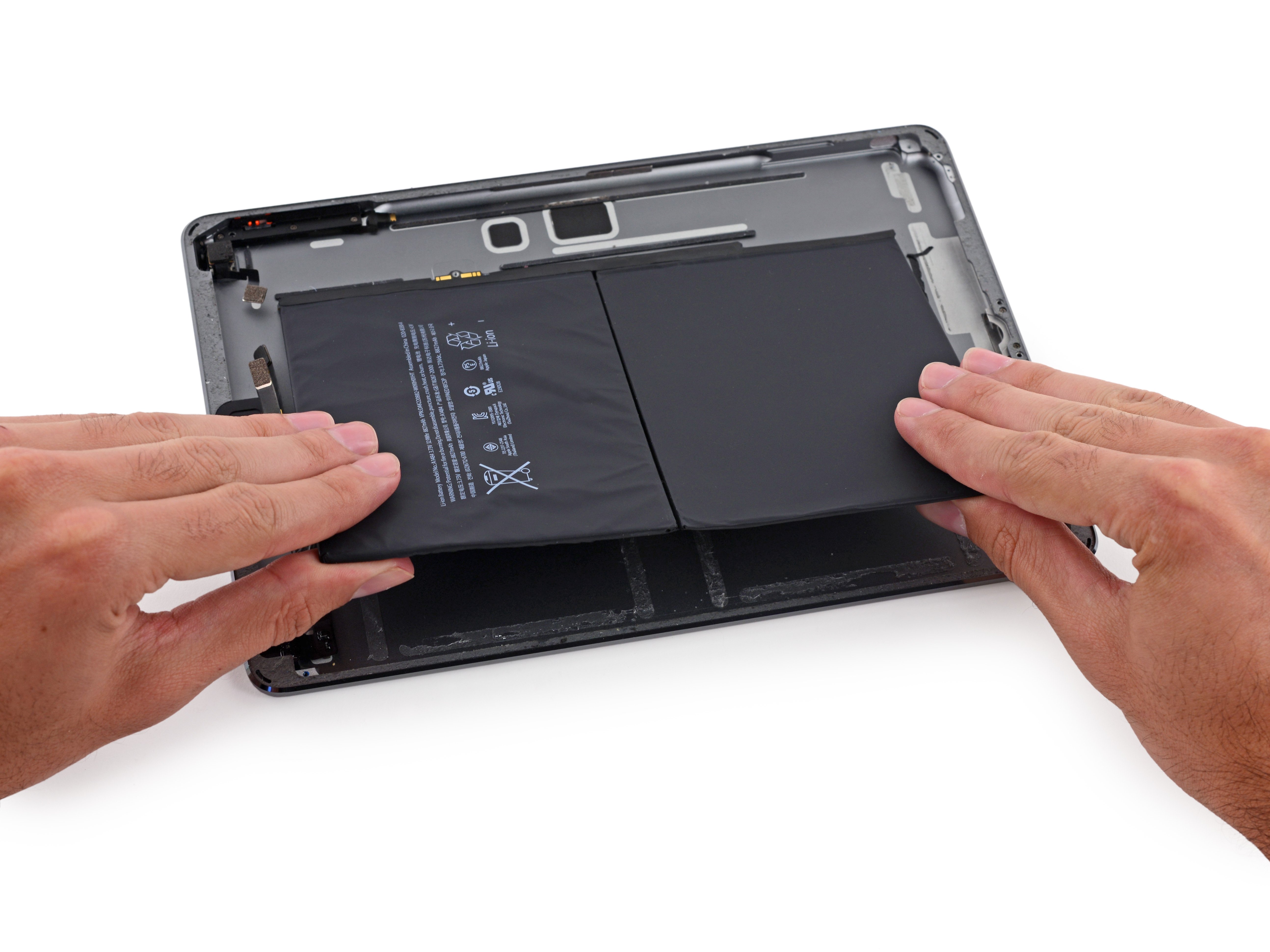

I just picked up my 5th gen iPad, 4 ½ years old, 128 GB Wi-Fi model. The battery had been diagnosed by Apple (remote diagnosis during a chat) to be at 45% and with 469 cycles. iMazing had reported 52% battery health.
Here is my experience.
I made an appointment with the local Best Buy, using the Apple site to schedule a service visit for the purpose of replacing the battery. When I arrived there, Best Buy told me that they would not be able to do the work at their own shop, they would send it to Apple, it would take 2 weeks or so, and I would receive a refurbished unit back. I decided not to do that because I didn't want to wait 2 weeks, and Best Buy referred me to a local shop that was also an 'Apple Authorized Service Provider'. They were only about 10 minutes away so I decided to drive there to see what they had to say.
The local 'Authorized' service provider was no longer in the location that Best Buy had referred me to, but there was another independent electronics repair shop in that small strip mall. So I went in with my iPad and talked to them. They told me that they could replace the battery, it would take a day, and quoted a price that was $10 less than what I would pay for the Best Buy service ($89 vs $99). I asked them how long they had been doing this kind of work and whether or not the battery could actually be replaced since I had heard conflicting reports. He explained how it was done, it made sense to me, and I decided to leave it there for service.
When I got home I was curious about what was involved in replacing an iPad battery, so I went to ifixit and looked at their battery replacement guide. It is clearly possible, it is not something I would want to attempt myself, and the process involved is exactly what the guy had explained to me at the local shop. I also checked out the shop ratings on Google and they were very good.
I picked up the iPad today, the new battery is installed, iMazing confirms battery health is 100% and 0 cycles, it looks perfectly fine, and I'm completely satisfied.
Bottom line is that what is being reported here by quite a few folks is partially correct in that Apple themselves apparently do not replace batteries, but small independent shops (including very possibly Apple Authorized repair shops) do replace batteries. The battery is not soldered in, it is held in place by a couple of screws (this is what the local shop had told me and confirmed by the ifixit instructions), but disassembly and reassembly is a non-trivial job that requires carefully heating the iPad to release the glue and separate the glass and display, carefully disassembling the insides in order to get access to the battery and replace it, and then putting it all back together including glueing it back together which requires clamping the device for several hours while the glue sets.
This was a good chance for me to get some experience with a local shop that I will definitely use again if I have a repair need for one of these devices.
And once again - iPad batteries can be replaced, even if Apple themselves chose not to do it.
