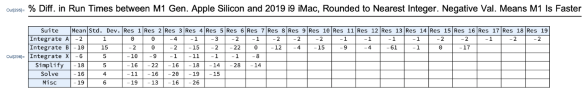

The challenge for me is that it's easy to get more cores (well, easy if you're willing to spend the money). But faster ST speeds have to wait for technology to advance, and I suspect it's going to be a while before AS is enough faster than my iMac for it to make a practical difference. For instance, here's a benchmark I created for myself using symbolic calculations in Mathematica. I ran it on my i9 iMac, then asked someone I knew from another site to run it on their 16" M1 Max MBP. All these calculations are ST. The average improvement for each suite of tests was only 2% to 19%.
Now it's possible there are more optimizations Wolfram could make for Mathematica to run faster on AS—the first native build of Mathematica for AS was 12.3.1 (released July 2021), and this comparison was made with 13.1 (released June 2022), so they've only had a year to tweak it, but still...

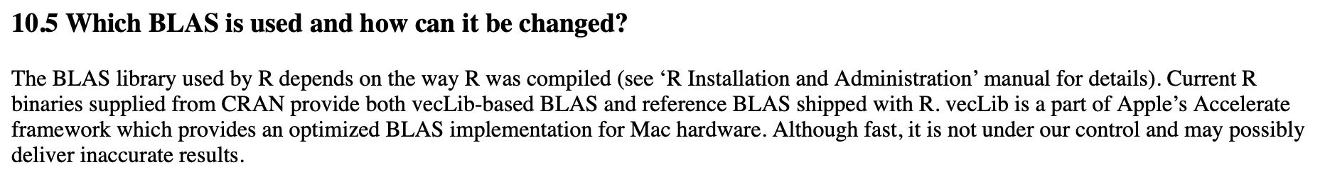

In R and Numpy, you can get massive improvements in some mathematical operations (but not others) on Apple Silicon when the software is made to use Apple’s Accelerate.framework, which leverages the built-in matrix math hardware on the M1/M2 when possible.
The last I read about using Accelerate with R was this statement from CRAN. Is this still the official stance—which makes it sound like Accelerate hasn't yet been fully validated on R—or is this posting out of date?:
Never used Mathematica, but it sounds like the kind of thing that could benefit from that kind of optimization!
I don't know how Mathematica operates internally, and thus don't know whether or not Accelerate would help the operations in my benchmark, which were entirely symbolic tasks (integrations, equation solving, expression simplification, etc.).
One of the other issues faced by Mathematica on AS its performance in numerical tasks. There the problem has been that the numerical libraries available on Intel (Intel MKL) are very fast, and what has been available on ARM hasn't been as performant--thus some numerical tasks can actually be slower on AS than on older Intel machines. Would Accelerate help with that?
Interestingly, that's also an issue for Mathematica on AMD. The numerical libraries available on AMD are significantly slower than MKL. You used to be able to spoof MKL into thinking it was running on an AMD chip, but Intel killed that workaround.
