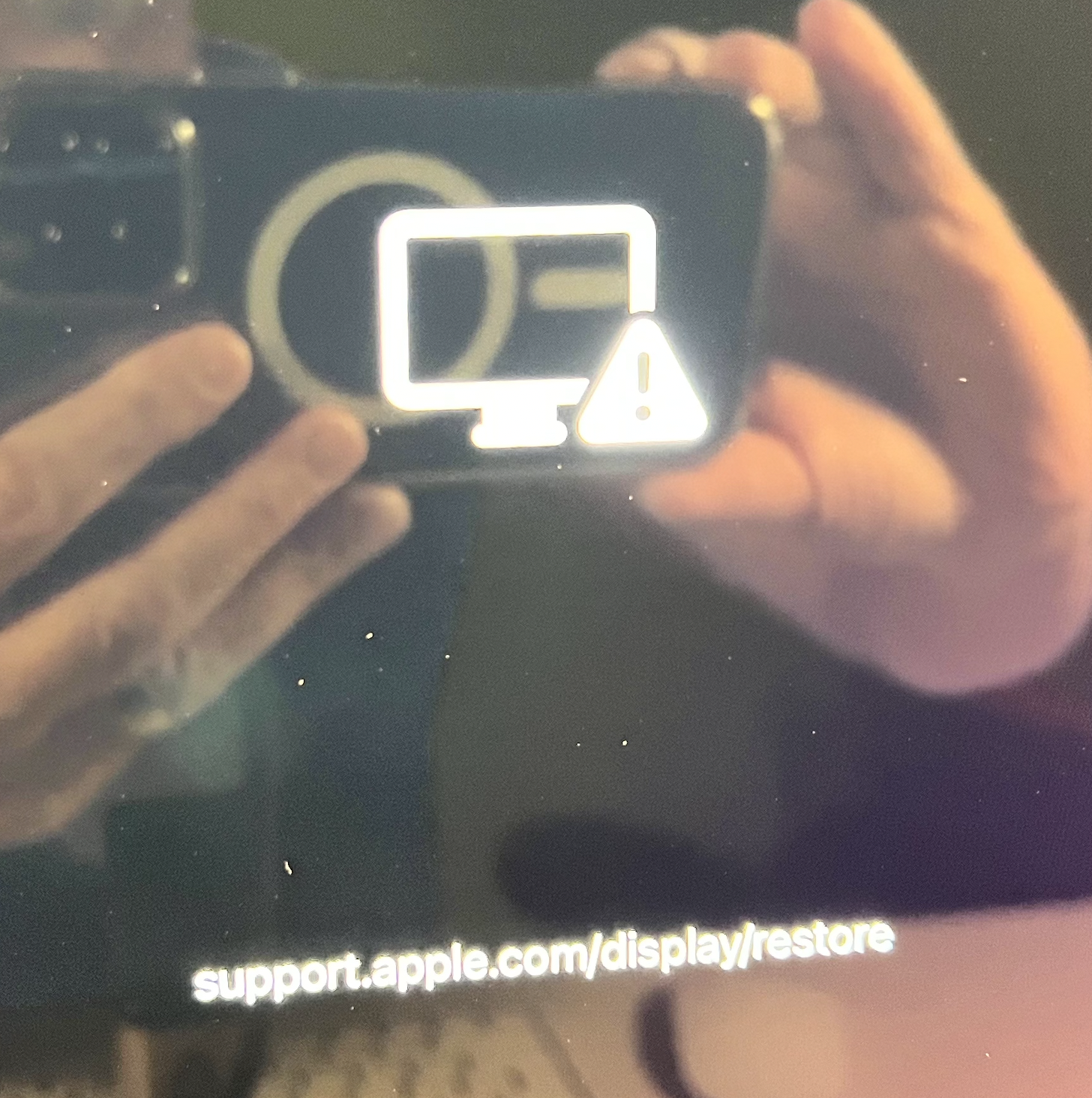

I just did a normal system software upgrade of monitor to "firmware" 15.4 and the monitor bricked itself for over 15 minutes with this on the screen:
See https://support.apple.com/display/restore
Reset everything and waited for a while ... the MacBook kept trying and eventually the upgrade succeeded.
