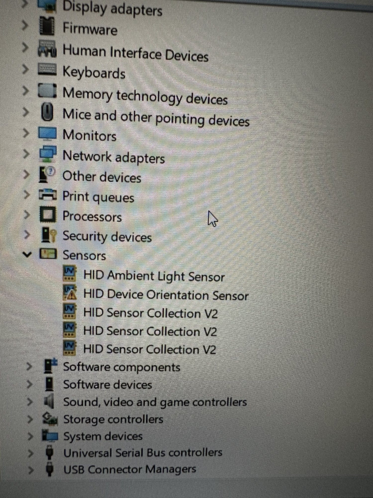

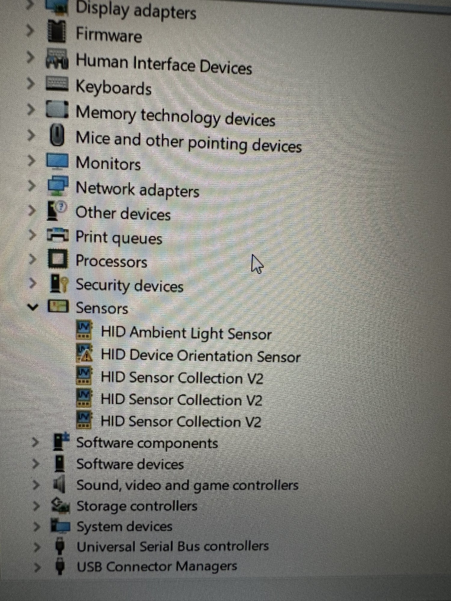

I connected my work Dell laptop (Latitude 5520) and it worked! The only issue is I can't change the brightness; audio, mic and webcam seem to work fine. I have no intention to use my ASD with a Windows laptop but I was just curious.
There are 5 unknown drivers in Device Manager, the first one is obvious but I don't know about the rest. The laptop struggles to power the 5K screen lol.
You need the boot camp drivers for the brightness and color space control

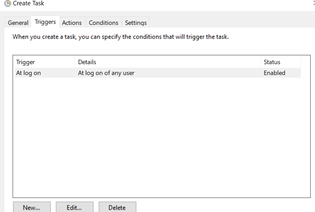

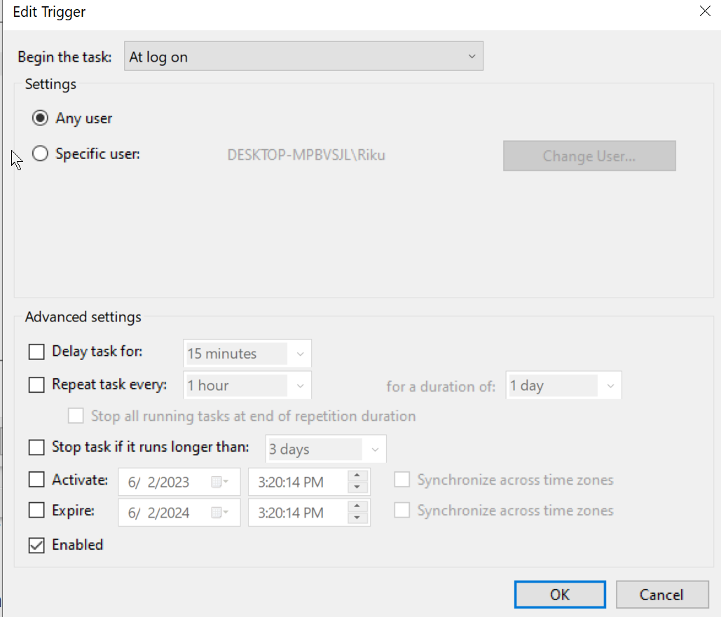

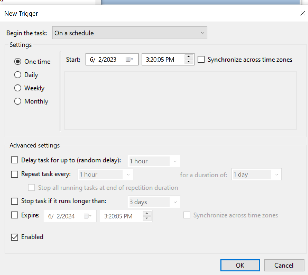

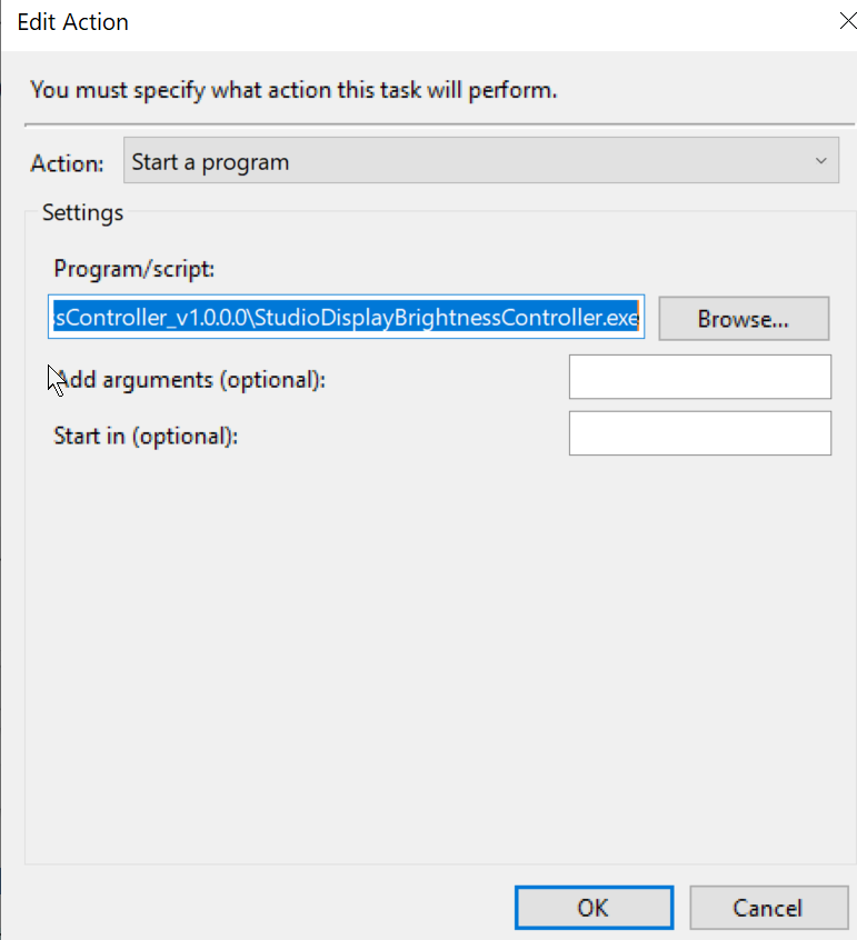

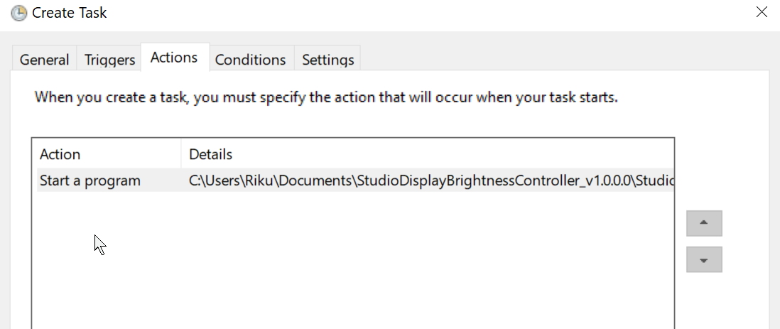

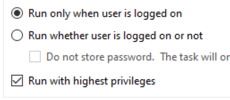

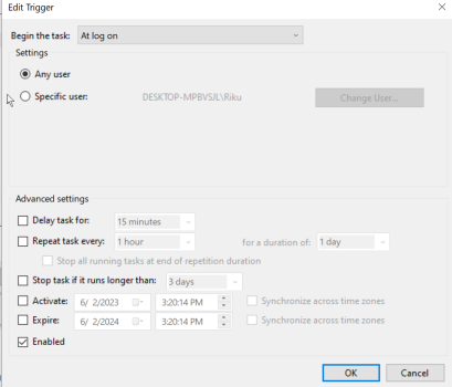

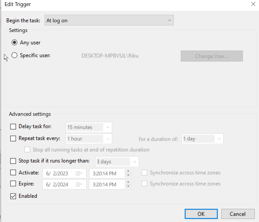

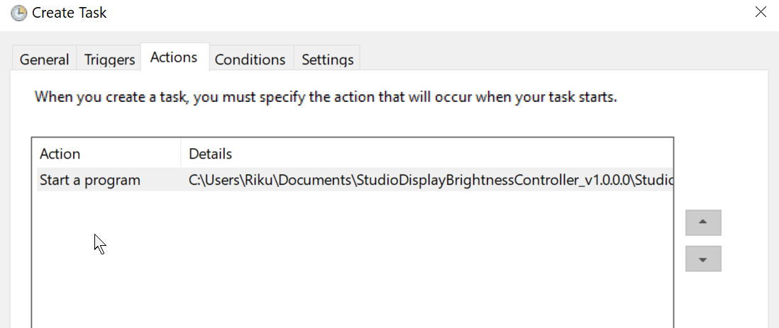

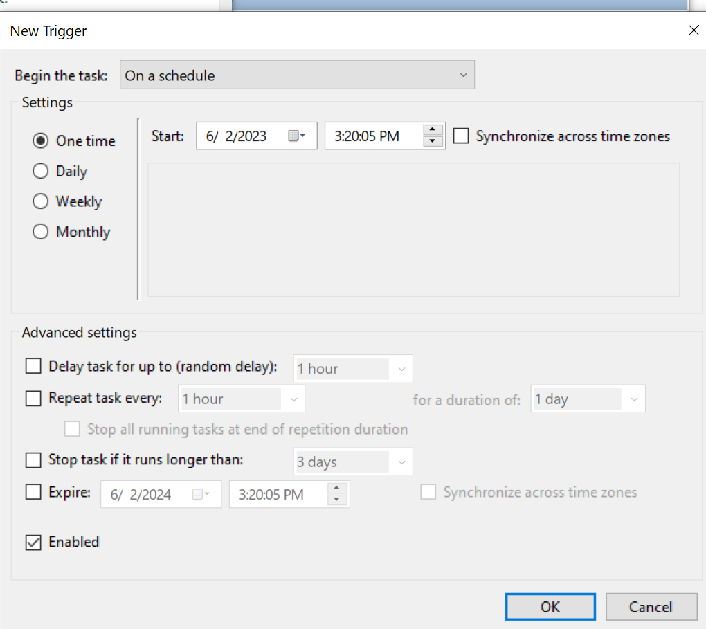

Some users might want to open at startup, but since the app requires elevated permissions, you have to run it through task scheduler instead of putting a shortcut in the startup folder:
1) Windows + R to open the Run Command: taskschd.msc
2) Inside task scheduler on the right column click New Task (Basic)
3) In the main config, MAKE SURE RUN WITH HIGHESTPRIVILEGES is checked ON
4) In triggers click new and set the trigger to "At Log On"
5) In Action click New and change the action to Start a program, then browse to the brightness controller.
