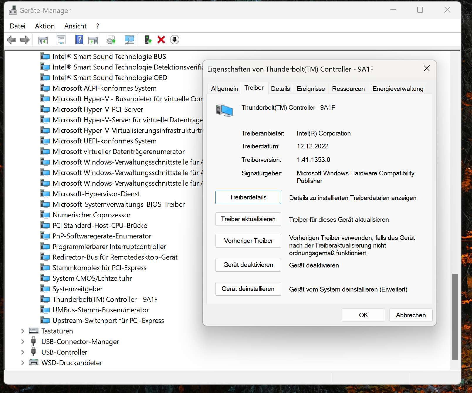

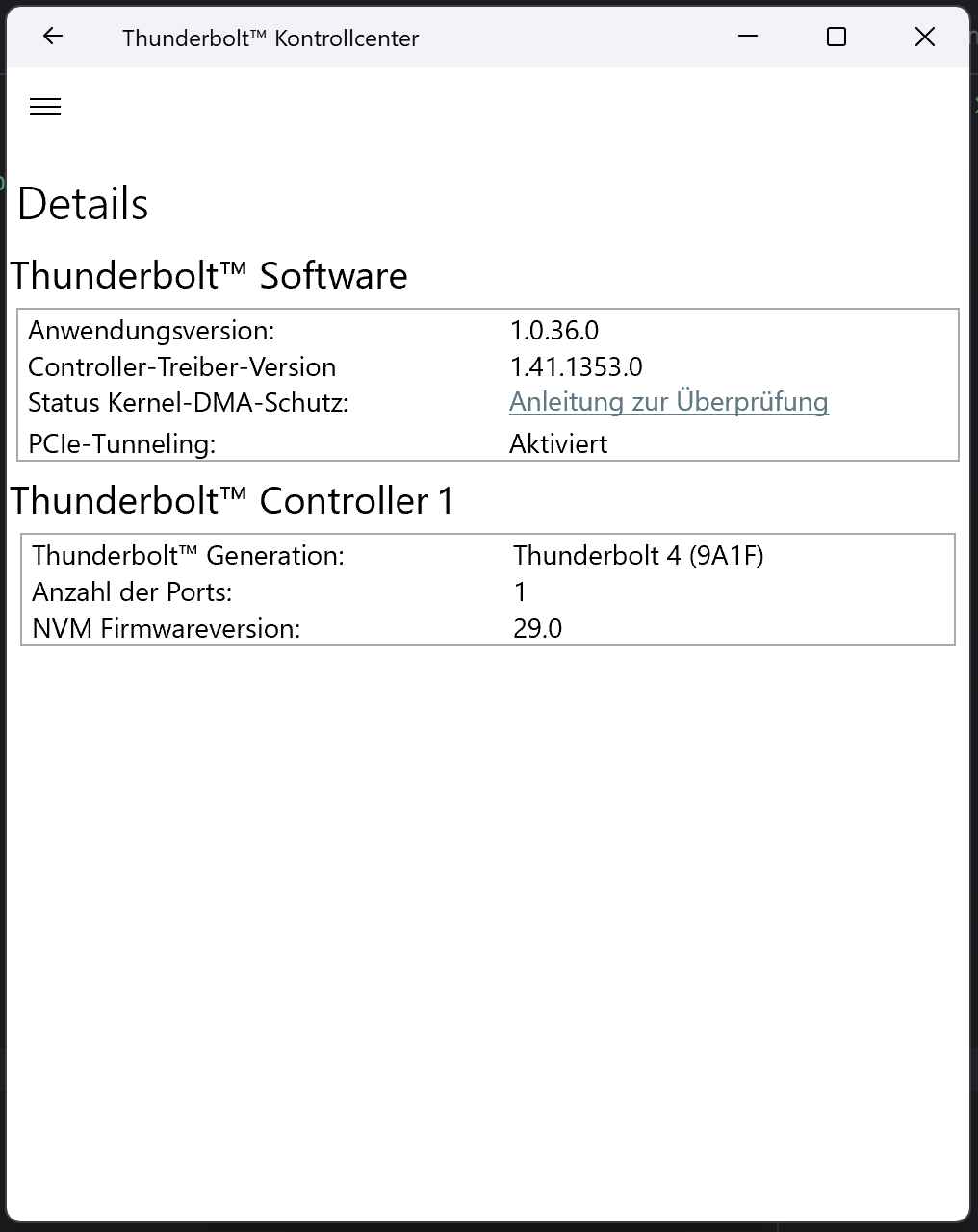

Unfortunately, switching from the power strip to the power socket did not work, as I had these interruptions again all morning.
I have now checked again, both the BIOS and the Thunderbolt driver are up to date.
I think I now know what you meant by the Thunderbolt controller panel (see photo).
Thunderbolt Controller Panel & Thunderbolt Driver

After months of research, I was able to narrow down the problem to some extent.
I found out that the driver (marked in the picture) is responsible for the camera, sound and microphone.
c3c8ecd0-e5a9-4c04-a7b2-31b598a71f3a
I am convinced that this driver is responsible for the distorted sound as well as for the sudden switching off of the microphone during a session (no matter if Teams or Zoom).
The question now is who is at fault? Apple, Microsoft, Intel or HP?
Believe me, I have gone through the Install/Uninstall, Upgrade/Downgrade Game.
