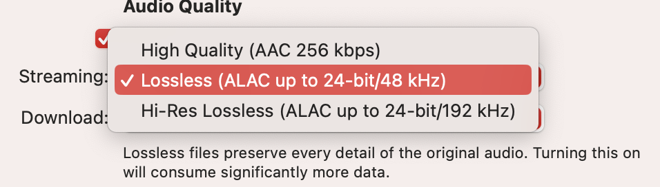

That's lossless, not hi-res lossless, in Apple's parlance. Attached screenshot is the settings panel of Apple Music

From your/Apple's screen shot it says:
Hi-Res Lossless (ALAC up to 24-bit/192 kHz)
Which means 24/48 lossless can fit that definition. Not all content is mastered above 48kHz, so it's not precluded from being Hi-Res, as long as the bit depth is >20bits.

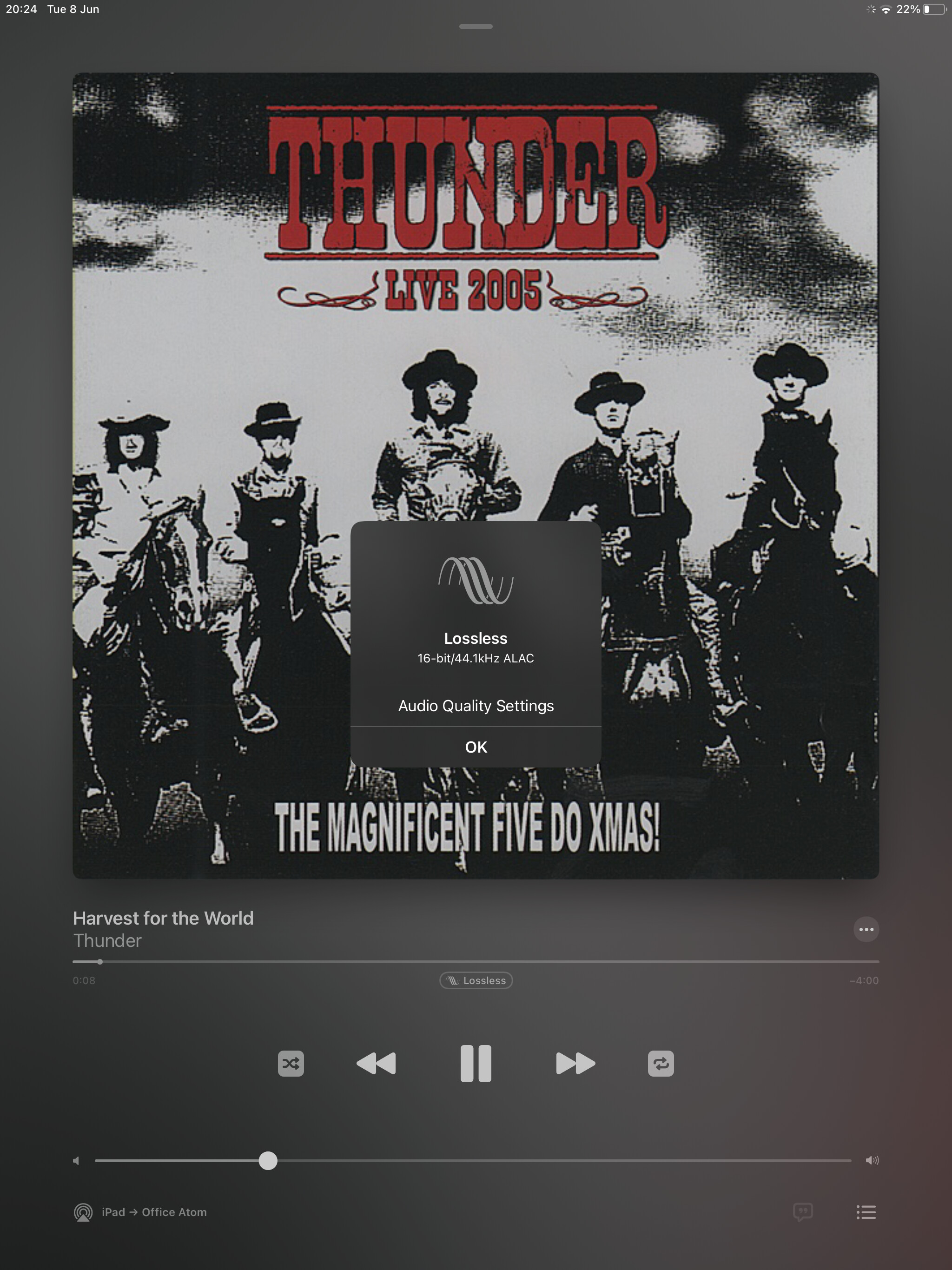

So I came to this thread based solely on listening observations and further research which sadly proved that even CD quality streaming is not possible via Airplay at the moment. Streaming Tidal and physical media through Roon all have noticeable improvements in sound quality on my system. Hmmmm…
Well it turns out Apple Music is currently transcoding all lossless ALAC to AAC over Airplay!
  • Wow
Reactions: UncleMac and arw
Wow, that’s surprising, considering Apples hype about (hi-res) lossless.
But as far as I understand this (AAC) limitation is only occuring when using Apple Music (Streaming? Downloaded Content?) and in combination with Airplay 2.
Just emphasizing it is not a general constraint of the protocol but an active doing of Apple under certain circumstances.
