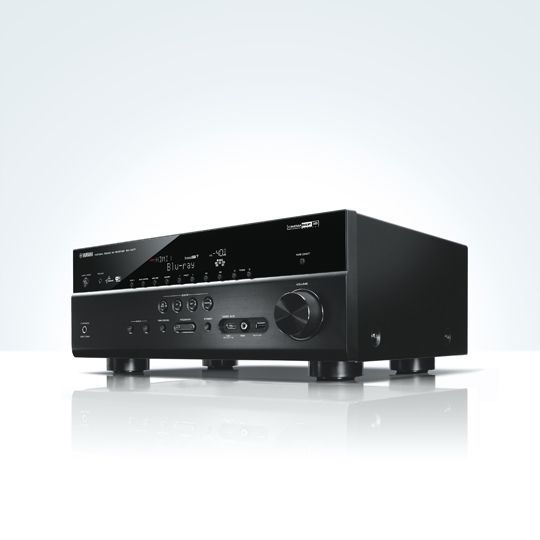

I’m looking at your receiver here:
And don’t see any sign that it supports Dolby Vision. I’d try connecting your ATV directly to your TV to see if it works using both HDMI cables. If both cables work, it’s your receiver.
Reactions: AL2TEACH
