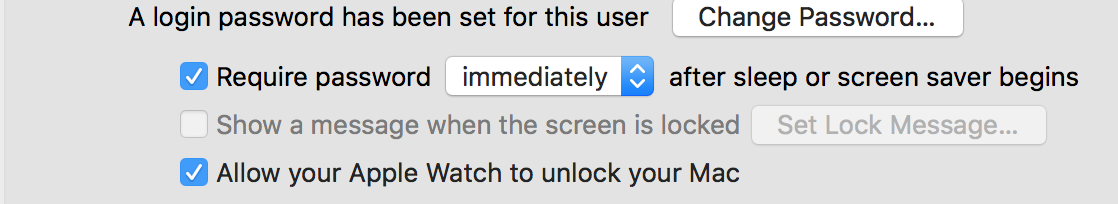

My saga:
  • Mac, iPhone and (1st-gen) Watch all fully updated.
  • Mac had two-step authentication turned on.
  • Check-box for Watch-unlock checked in Mac's System Preferences.
  • [began long loop of chaos in which Watch simply wouldn't unlock the Mac]
  • Read here that two-FACTOR iCloud authentication is needed, not two-STEP
  • Sighed heavily
  • Switched to two-factor
  • Dealt with all devices needing attention
  • In the end: check-box for Watch-unlock disappeared from System Preferences!
  • Reboots, etc...
  • No change. Gave up.
  • Next day: Mac suddenly complains Watch is locked (it was on its charger) and that it needs to be unlocked in order to set up Watch-unlock
  • Found the Watch-unlock checkbox had mysteriously reappeared.
  • Unlocked the Watch and authorized its unlock feature.
  • Works fine now.
Not a terribly Apple-y experience, but par for the course for a 1st-gen feature I guess. I'm not pleased with having to downgrade my authentication to two-factor and hope Apple allows two-step in the future.

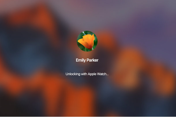

Initially, I had no problems getting my Apple Watch to unlock my mid-2013 rMBP. Then it just stopped working; like others, I would see it attempting to unlock, then it would just give up after about 10 seconds and prompt me for a password. I tried everything I could think of to get it to work. The last thing I tried was cycling Handoff on my Mac, iPhone and Apple Watch and then rebooting the iPhone and then Apple Watch. After that, it's worked quite a few times. Don't ask me why, as all the other settings were property established and unchanged from when it initially worked. I thought maybe the iOS 10.0.2 messed it up, but now it's working.
Here are the official instructions from Apple's help docs in macOS Sierra:
Unlock your Mac with Apple Watch
When you’re wearing your Apple Watch, you can use your watch to unlock your Mac after waking it, instead of entering your password.
Note: To use Auto Unlock, your Mac (a mid-2013 or later model) and Apple Watch must have macOS Sierra and watchOS 3 installed, respectively. You must be signed in to iCloud using the same Apple ID on both devices, and two-factor authentication must be turned on for your Apple ID. Make sure your Apple Watch is unlocked.
  • Turn on Auto Unlock on your Mac: Choose Apple menu > System Preferences, click Security & Privacy, then select the “Allow your Apple Watch to unlock your Mac” checkbox.
    Open Security & Privacy preferences for me
    If necessary, click the lock icon
    at the bottom of the pane, then type an administrator name and password.
  • Unlock your Mac: Wake your Mac from its idle state by pressing any keyboard key or, on a portable, by opening the display. The screen indicates your Mac is being unlocked.
System Information can confirm if your Mac supports Auto Unlock. Choose Apple menu > About This Mac, then click System Report. In the sidebar, click Network, click Wi-Fi, then look in the Interfaces section for Auto Unlock.
If you’re the administrator for another user on your Mac, you can log in to their user account and turn on Auto Unlock for them, as long as their Apple ID uses two-factor authentication and their Apple Watch has watchOS 3 installed.

Over on my 2008MBP (4,1) you see that you have to have a recognized wifi card with the Auto Unlock feature supported in order for the feature to show up under Security & Privacy.
MacBook Pro (15 Retina, Mid 2012)
Removed WiFi Bluetooth Card BCM94331CSAX Supported PHY Modes: 802.11 a/b/g/n
Added Replacement BCM94360CSAX Supported PHY Modes: 802.11 a/b/g/n/ac
Option Showed up right away.
Checked It and it asked for password for the account I was logged in as.
Closed System Preferences Shutdown Macbook pro retina
Restarted Apple watch
Restarted Macbook Pro
Logged right in
One time it said it was logging in with Apple watch but didn't and presented standard password block
Closed and re opened lid and it logged in just fine.
