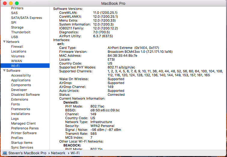

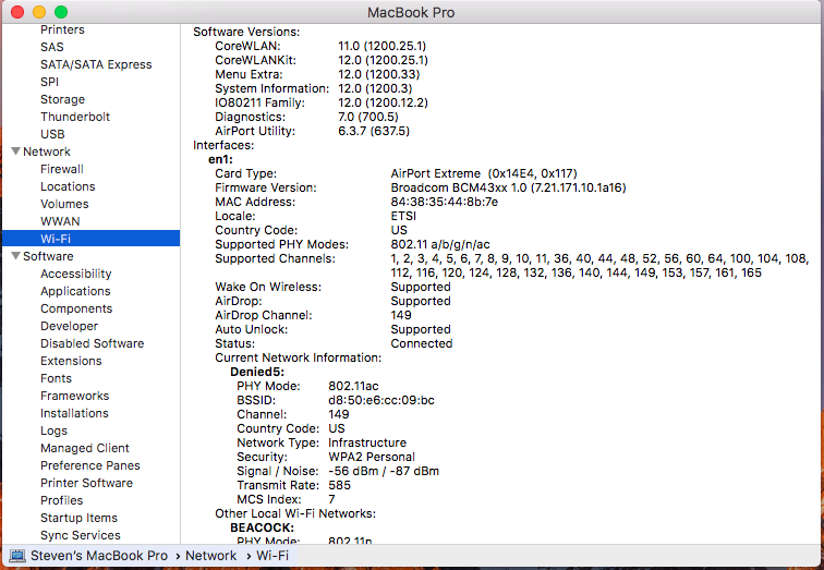

Removed WiFi Bluetooth Card BCM94331CSAX Supported PHY Modes: 802.11 a/b/g/n
Added Replacement BCM94360CSAX Supported PHY Modes: 802.11 a/b/g/n/ac

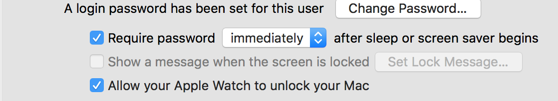

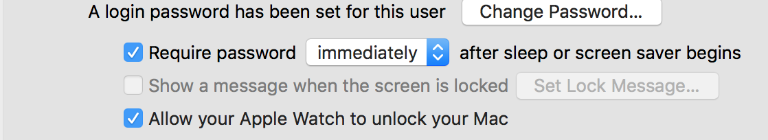

Option Showed up right away.
Checked It and it asked for password for the account I was logged in as.
Closed System Preferences Shutdown Macbook pro retina
Restarted Apple watch
Restarted Macbook Pro
Logged right in
One time it said it was logging in with Apple watch but didn't and presented standard password block
Closed and re opened lid and it logged in just fine.

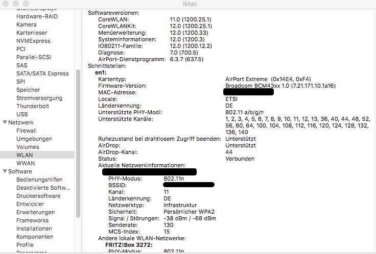

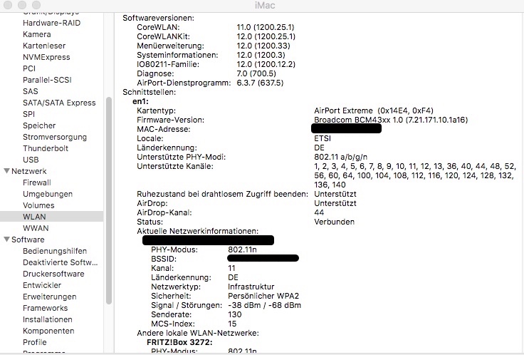

Looks great, is there a chance, that this also would work with a late 2012 iMac, I attached a screenshot of the WiFi section in the system report as a screenshot? Opening it also with that glued screen would not be the issue, it got upgraded with a 1 TB SSD not too long ago (one reason why I plan to go on using it for while), but I am not very familiar with the wireless cards in there, would an upgrade be possible and nothing else break?
Teardown of your iMac (you didn't say which size, so just grabbed the 21.5" one):
https://www.ifixit.com/Guide/iMac+Intel+21.5-Inch+EMC+2544+AirPort-Bluetooth+Card+Replacement/16607
You'll see the original network card (step 59) has 4 antennae connectors and two torx screws from the opposing side holding it in place. The card for the MacBooks:
https://www.amazon.com/Broadcom-Bcm94360cs-Bcm94360csax-Bluetooth-Wireless/dp/B00PDN4H9E/
won't have the screw connectors (so you would need to find another way to keep it in place) and only has 3 antennae connectors, not 4 (so you'd be dropping one antennae).
Thanks for the links, I actually have a 21.5'' iMac, so the one shown there at iFixit is the right one.
This actually looks promising and if this does work on MacBooks, there is at least a chance this working on an iMac as well, I just did look a little bit more around on Amazon and found this card:
https://amzn.com/B01DJAE99A
It says being compatible with the iMac from 2013, however could this maybe just mean, that it is just the same one and meant to be used as a replacement for the 2013 one, but should also work in the late 2012 one? It seems to have the same form factor as the one seen on iFixit, so it might also be kept in balance with the same screws?
That IS encouraging! :) You should contact the seller though - confirm what their returns policy is (if the screw holes don't line up, not sure you'll want to keep it? Guess you could use some sort of glue. ;)
Someone asked this question a few years ago in the Apple community, according to a reply there someone got it working, guess I will get myself such a card and give it a try, depending on where I order that card from, it might take a little while until I have it, but report here for sure, if I got 802.11ac and autounlock with my Watch working :)
I'm sure you will...hopefully it won't take you too much work once you have the new card (have a BRCM4360 card in my 2008 17" MBP and it's working great - so, yep, it can definitely be done!) :)
I believe that is the correct card for your iMac upgrade and is wifi euro spec which from your earlier about my mac picture (Germany ? ) would be what you are looking for.
I would reach out to the Amazon seller by Amazon message to confirm and Amazon has a fairly liberal return policy.
An iMac is a challenge to open. ifixit.com will give you an insight on tools and what you're up against
