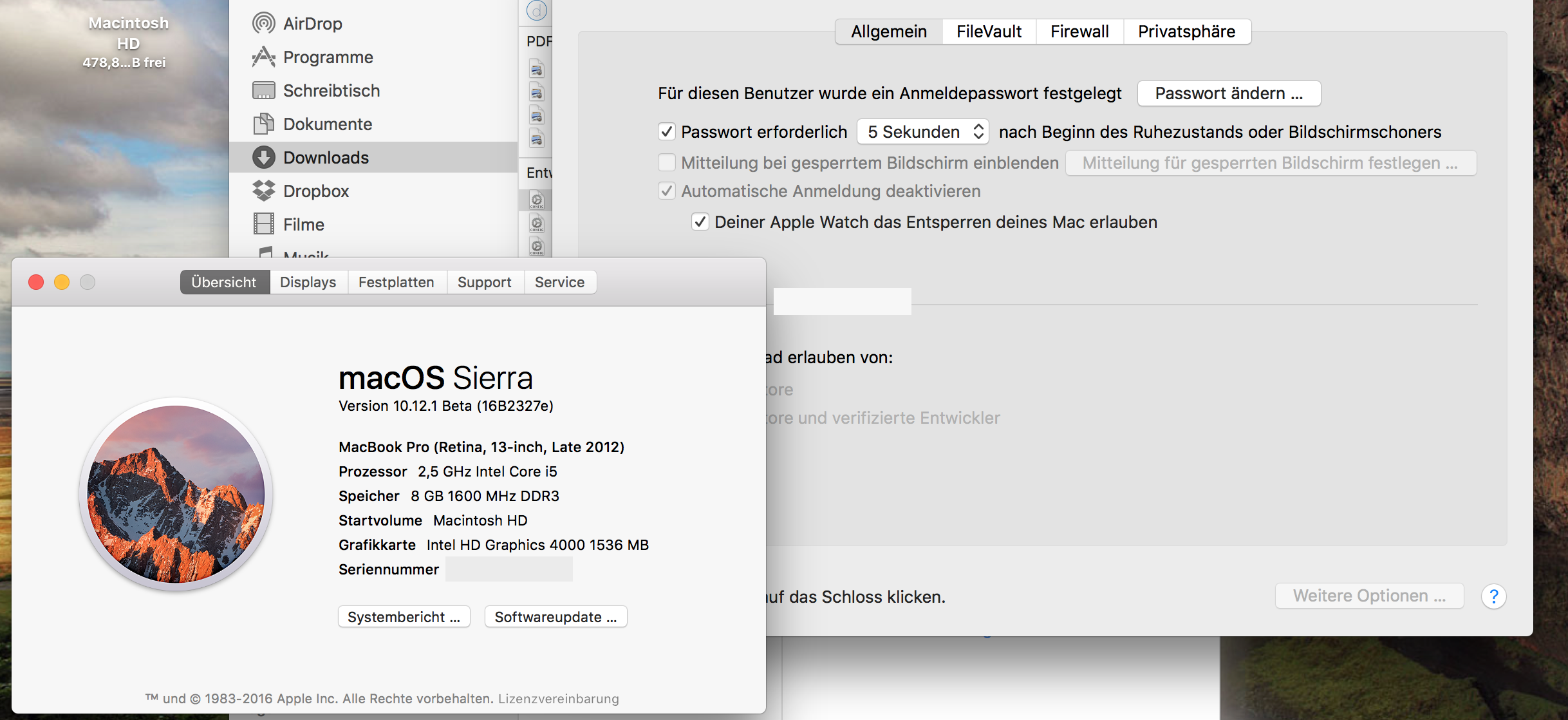

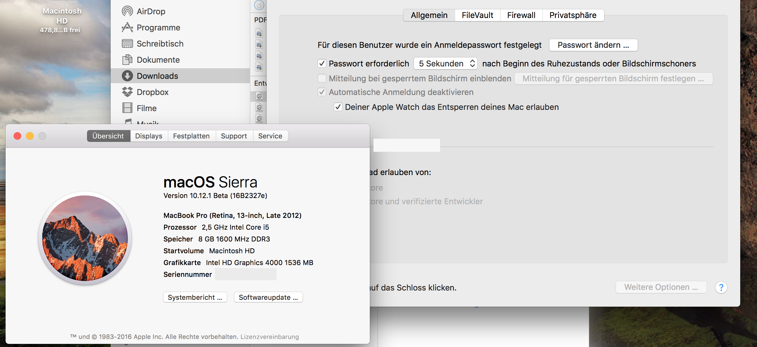

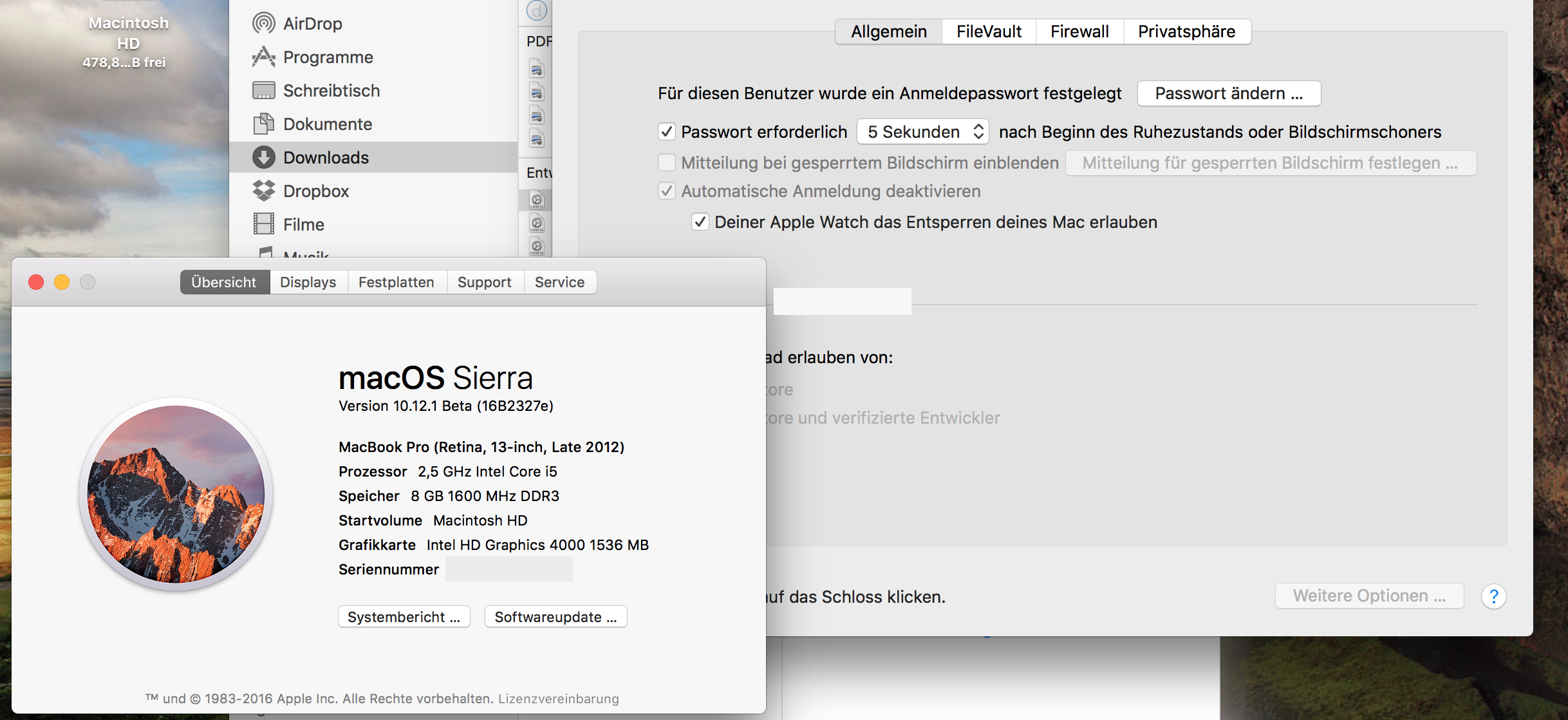

Updated my MacBook Pro (Retina, 13-inch, Late 2012) with the card from Amazon (Screenshot below).
Feature works perfect now on 10.12.1

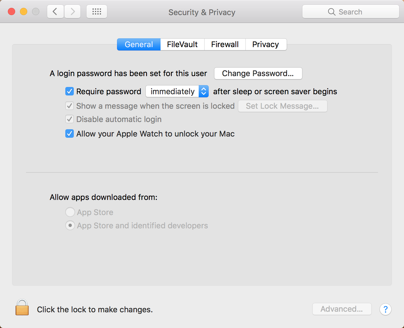

Okay.. I FINALLY was able to get the menu option to show up. (So yes, there was no checkbox for 'unlock your mac using your apple watch).
This is what eventually allowed it to appear late last night (Same night I turned on 2FA).
I had filevault on. I turned that off to see if it would do anything as I saw one random post that alluded to it.
I went back to general and initially didn't see anything.
2. I have an app called MacID which essentially did the same thing but on ElCapitan. I tried quitting it in the past but that didn't help. This time I turned of the searching or listening for iPhone option in the menu.
Those two items (filevault off and turning of the listening in MacID) happened within 1 minute of each other.
Now, I don't know if it was those two, or the addition of the X hours after 2FA was activated (Or perhaps a combo of the three) but switching over from the tabs back to general, the option just magically appeared for me! And now it has worked each time so far today.
BTW, once it appeared and I was able to successfully select it, I was able to turn filevault back on with no problems. I also found MacID to not be needed so I removed it from my login items as well.

I successfully enabled unlock with your Apple Watch feature on my iMac5k and rMBP, but there is a problem after few hours the option on mac system preferences>Security & Privacy>Allow your apple watch to unlock your Mac box unchecked after few hours and when I try to check it again it takes me to iCloud preference window and want me to give my iCloud password again and then when I go back the box get checked, I didn't noticed the time that how long it keeps this option running but when after few hours I return to my system it ask me to do this, why it happens why Apple is loosing it ecosystem.

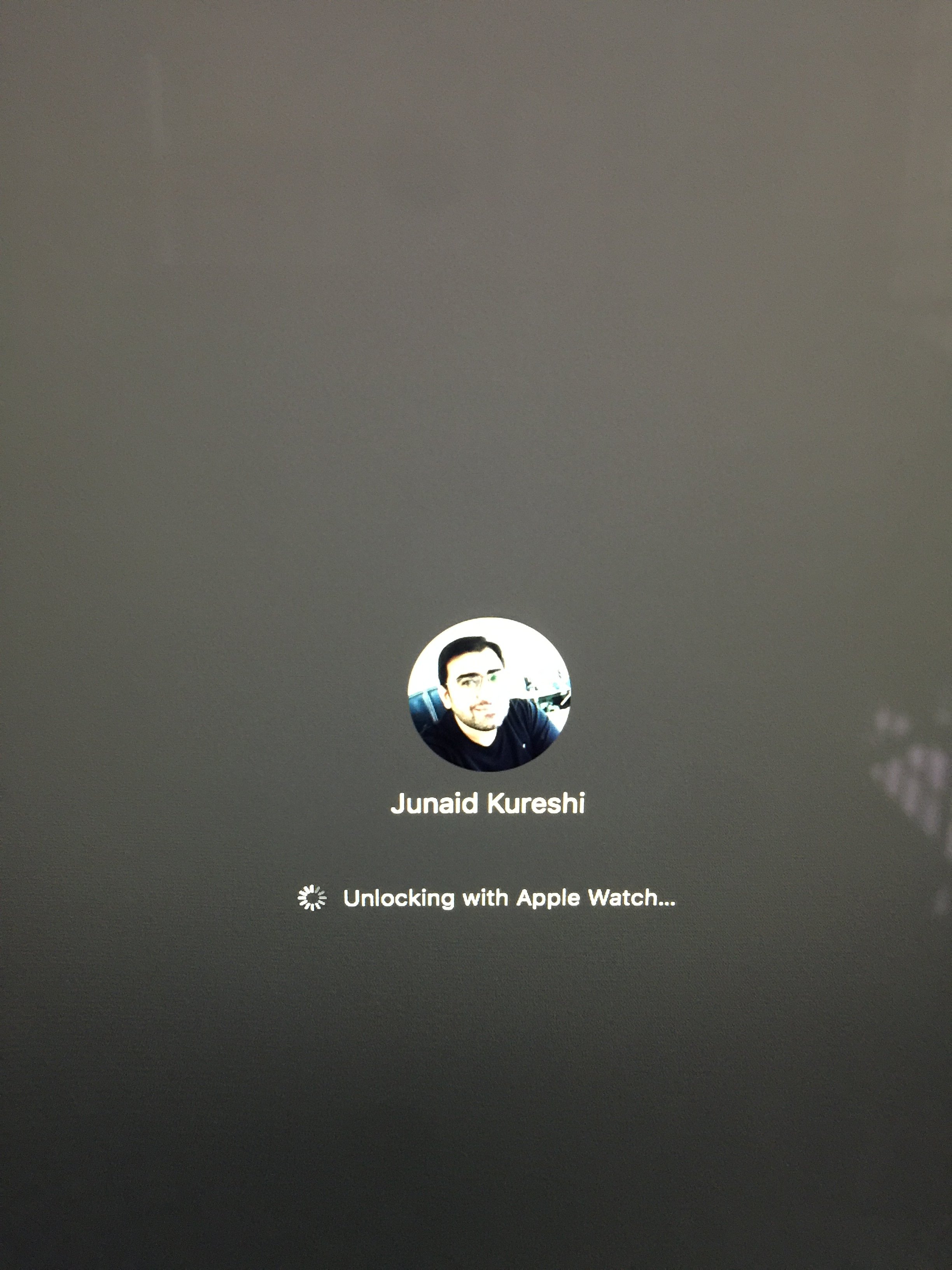

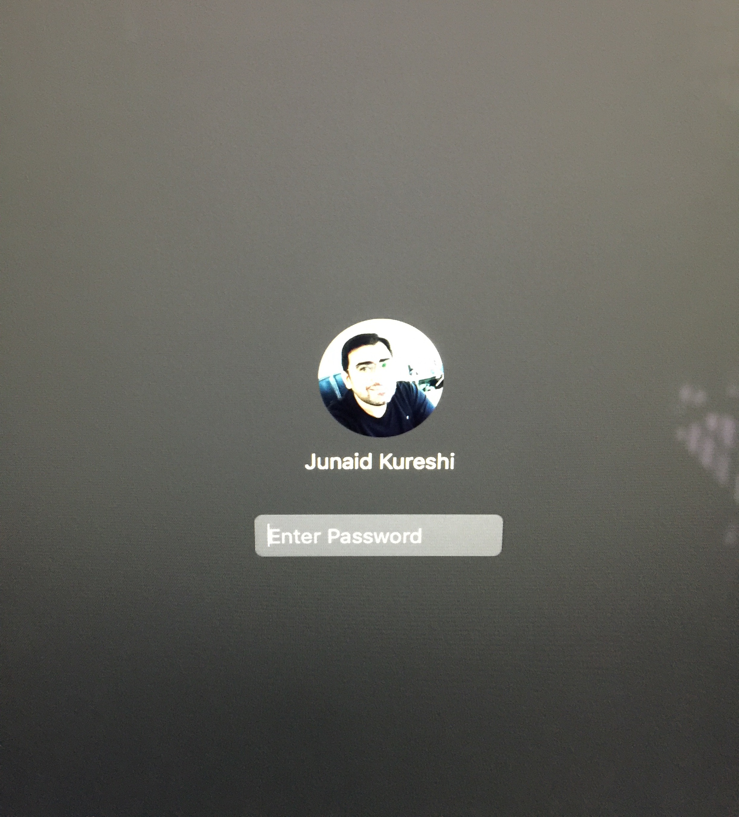

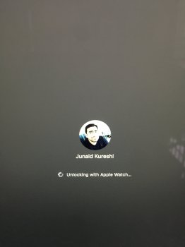

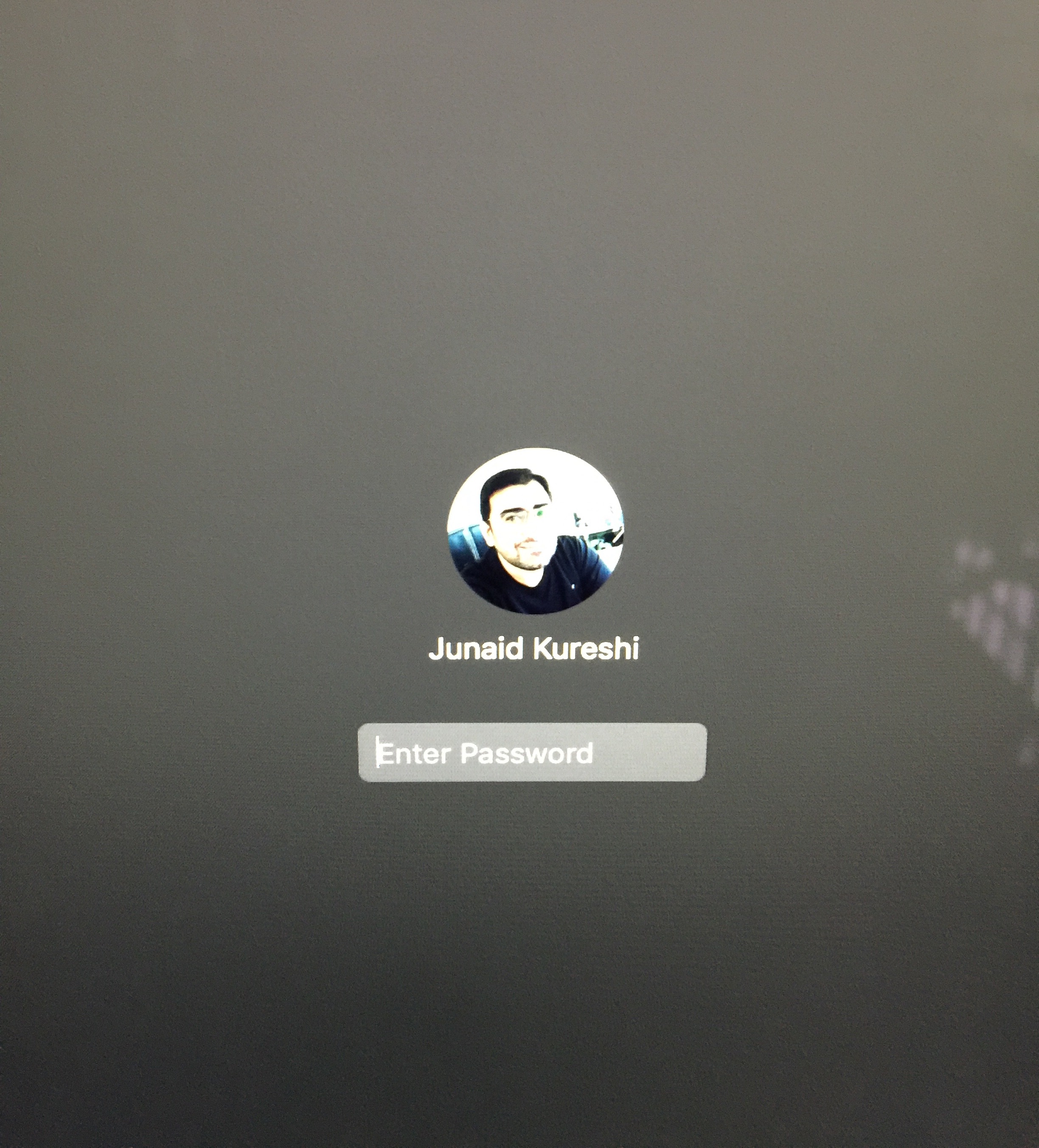

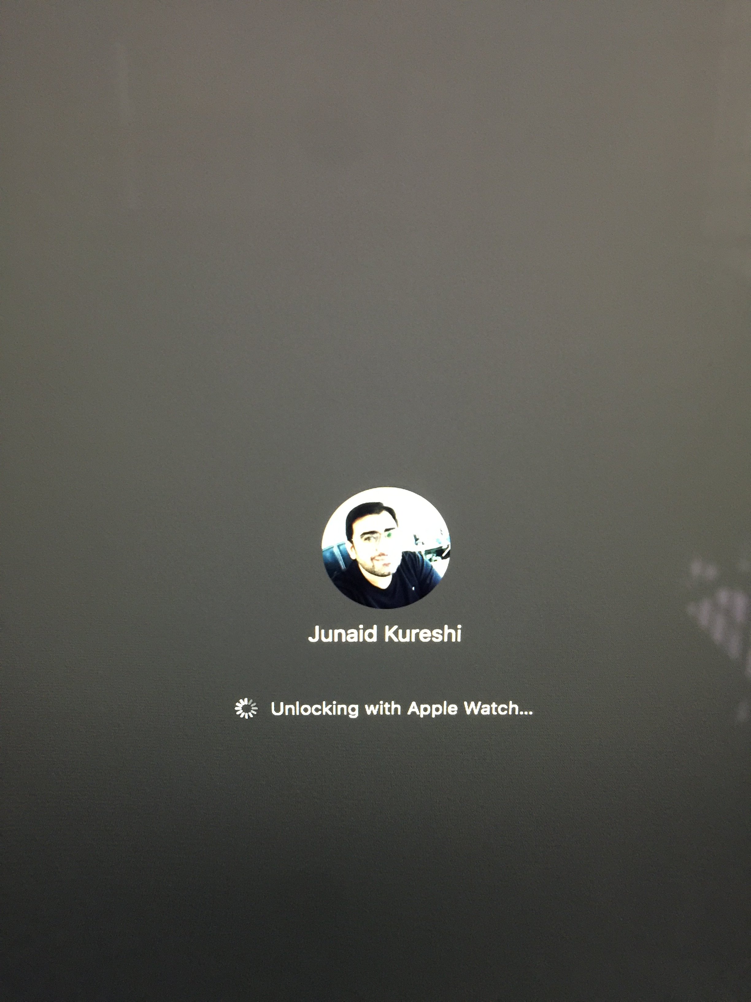

Sorry second pic wasn't uploading in one reply
I've got two ideas:
Initially my Mac couldn't connect to my Apple Watch to turn on this feature. I turned off and on Handoff on my iPhone once which made that work. You could also try to logout and into iCloud on your Mac and Phone once and see if one of those fixes your issue.
sorry second pic wasn't uploading in previous reply

Has anyone else had problems with auto unlock since upgrading there phone to the iPhone 7?
Been running the beta with my iPhone 6S, I received my new 7 last Saturday and ever since, my mac does not unlock!
When I open the lid or wake from sleep, it says its unlocking, the wheel starts to spin, then eventually the password box appears and I have to enter my password!
