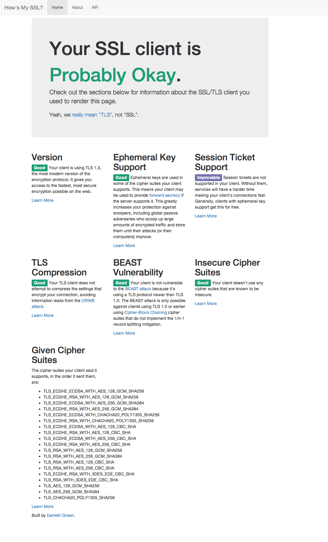

I'm writing from Lion. This is what howsmyssl reported when I loaded it in Safari 5.
Safari feels a bit sluggish, indeed. Session Ticket support "improvable".

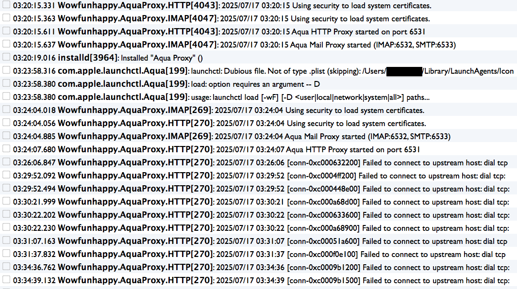

Apple Mail (10.7.5). I can't set up an iCloud Mail account here, it says "The IMAP server is not responding". I managed to add it in offline mode, but it failed to connect. The Little Snitch Network Monitor shows only Aqua-HTTPS running, no Aqua-IMAP.
I checked the certs. All are installed and trusted; however, I have two copies of DigiCert Global Root G2 and DigiCert Global Root G3 (one copy of each cert is under "System", and the other under "System Roots").

Update. Alarm call-off. It finally added, but in Lion, the process isn't seamless and straightforward, so much so that the ambiguity caused by it is quite dramatic. Adding the first IMAP account was the hardest. The IMAP proxy kicked into action one hour after I set my iCloud account. I had never touched server settings, so the fact that Apple was slow-witted enough to hide the port field in the server configuration window of Lion's Mail until the setup is complete only stirred my confusion. It takes some time for the inner workings to sort out, and then everything goes swimmingly.
